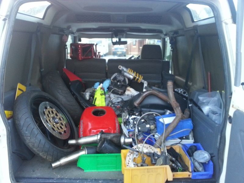

  1. I bought a 1993 900 SS in bits at the start of November 2012. I've never built a bike before so it's going to be a learning curve, but I'm hoping the end result will be worth the effort. This thread will document the trials and tribulations. Photo's to follow:

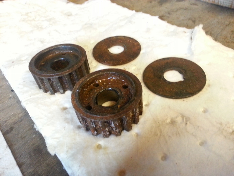

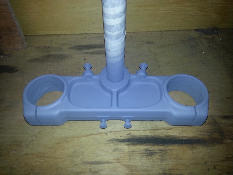

  5. So whats with the electrolysis then? Is it cleaning it? My sps motor wasnt as bad as that so going to be interested to see how youget it shiney...

    The electrolysis shenanigans came about from watching a youtube vid of a guy de-rusting his tank using the same method, I thought I'd give it a bash and the results were well above my expectations! Still a little weary of how the metal will fare when wet after the process, but time will tell. In a nutshell the process takes rust off the part you have connected to the negative and transfers it to the 'sacrificial annodes' that are connected to the positive. Witch craft!! Oh, and I thought I was being clever by adding salt to my washing powder and water to make it more conductive and I'm pretty sure I ended up producing Hydrogen Chloride!

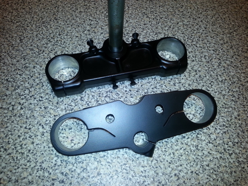

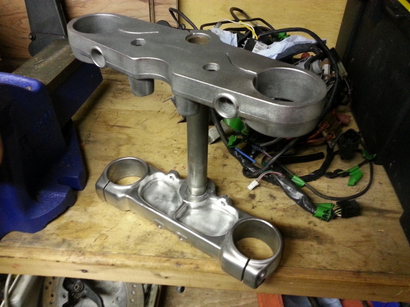

  9. Use a photobucket account and link the pictures there to your thread. Also, what are the holes in the top yoke for? Bar risers?? I've not seen them before?
  10. Good luck with the build.You will have to get a bit of a move on tho .because I cant wait until 2014!
  11. Thanks guys, will aim to get an account set up for future updates. The holes in the yoke seem to have been used to route cables and have been (shoddily) drilled by a previous owner. The reason for needing them seems to be that an electronic speedo/rev counter (KOSO brand I believe) was used, and the tank vent went through one hole and the speedo cable went through the other.

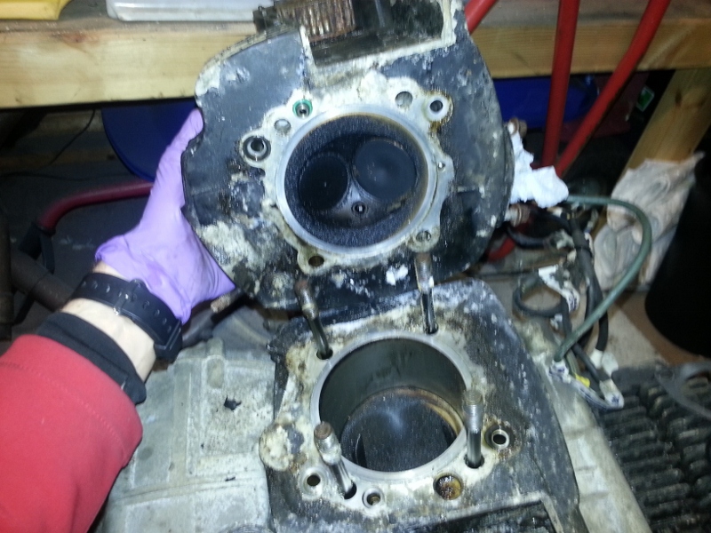

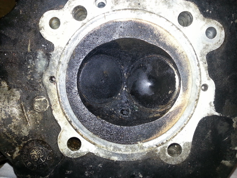

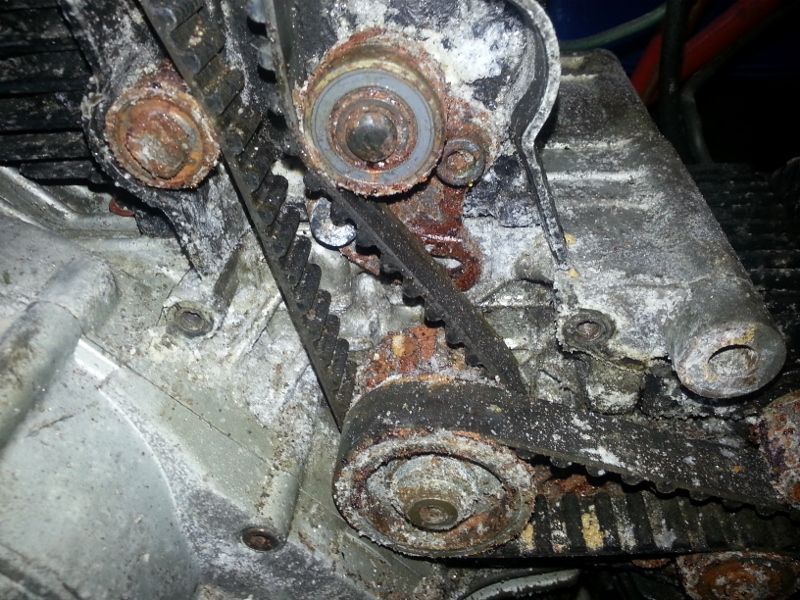

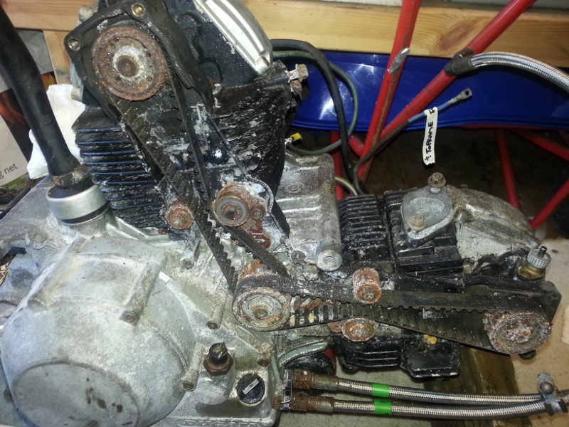

  18. Thats a brave build Stew,but good work.That engine looks like its been on a sea bed for several years,reckon You might need new belts,maybe see my photo album for some bodywork inspiration :)
  19. Cheers Paul, yeah the belts are long gone!! I know, how it got into such a state is beyond me, seems to be cleaning up OK though (so far). I'm hoping to achieve a clean build at the end of it, nothing meticulous or awe inspiring, just raw and solid!
