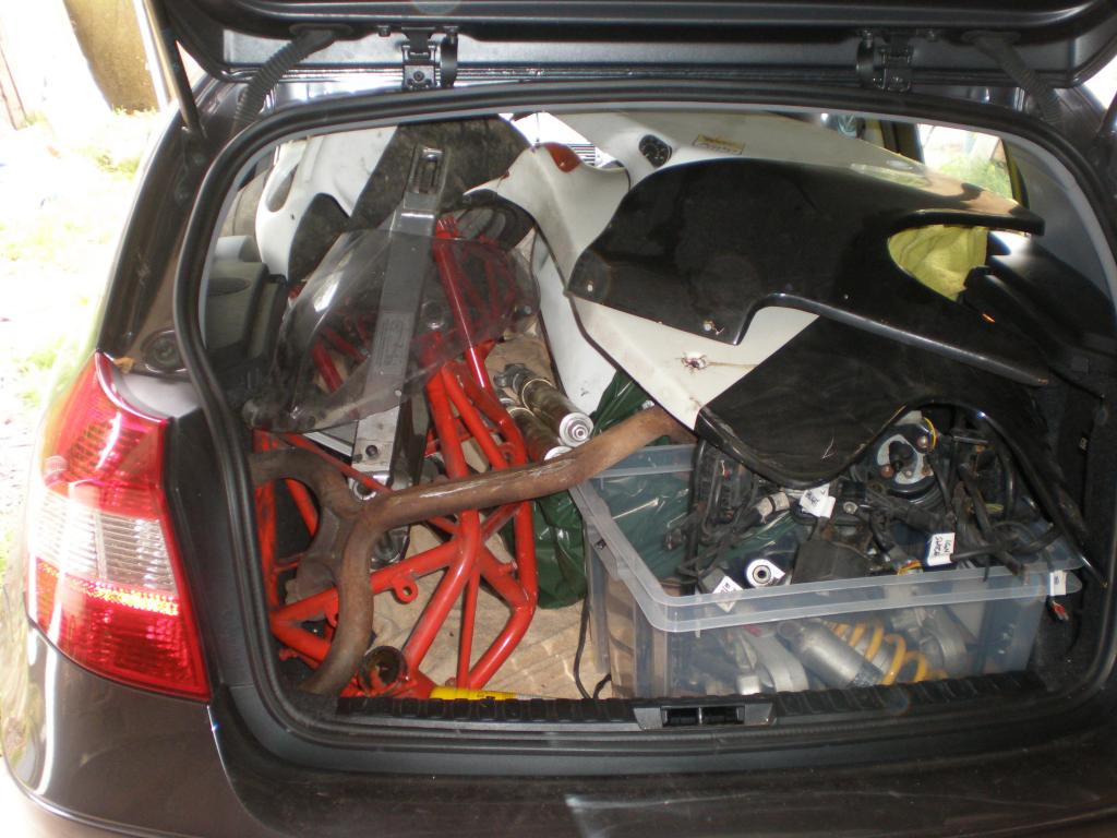

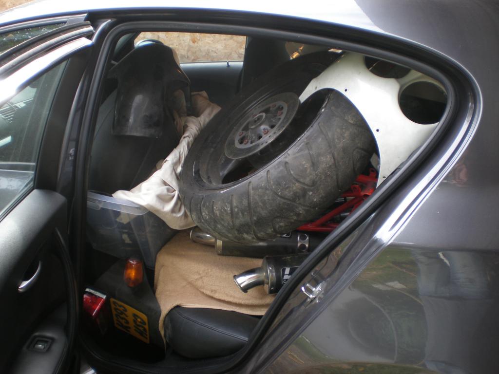

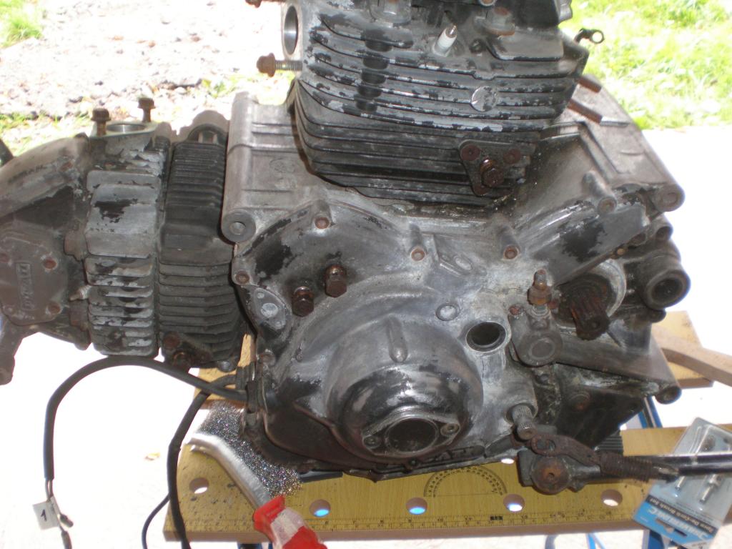

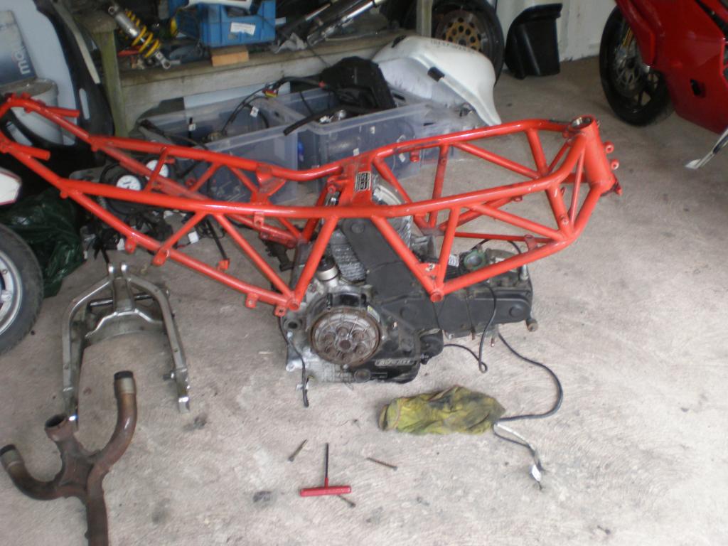

    I bought this a few years ago as a basket case and brought it home in the back of the car samsung photos 397.jpg samsung photos 398.jpg
    the bike itself was a bit rundown and had been in a accident and thats why it had been striped down and the last owner did a very good job of boxing everything up

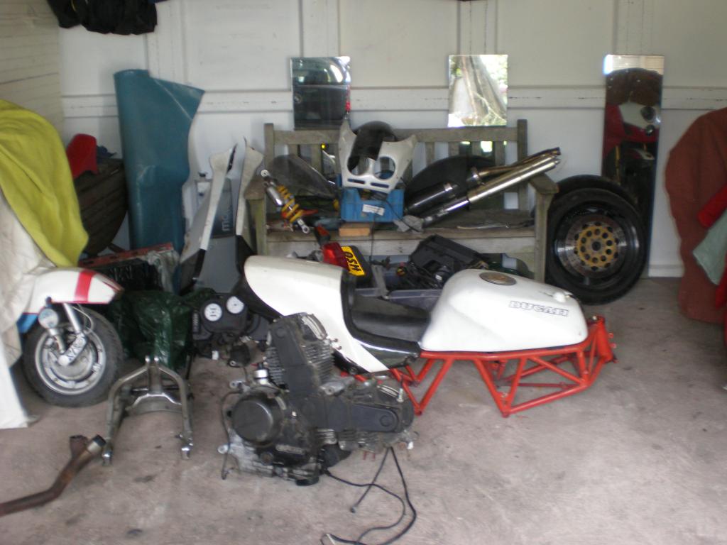

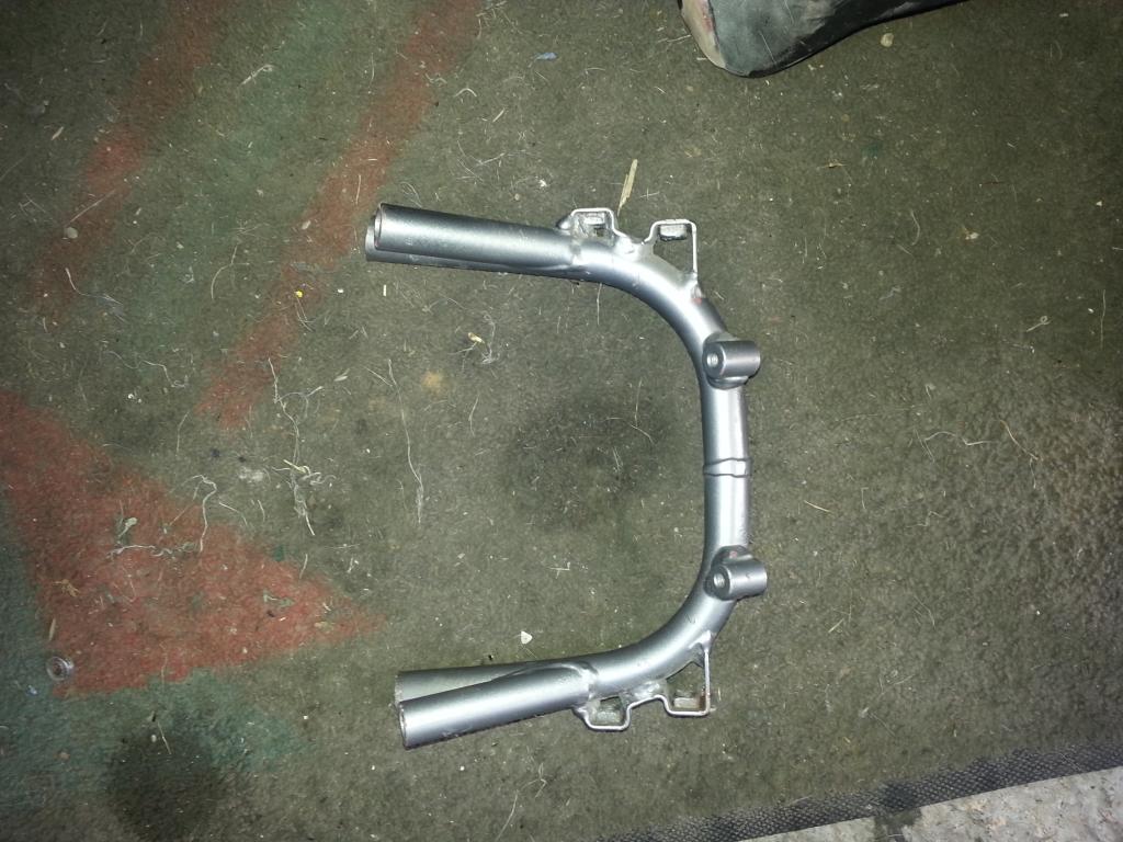

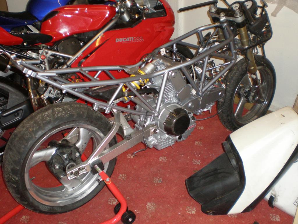

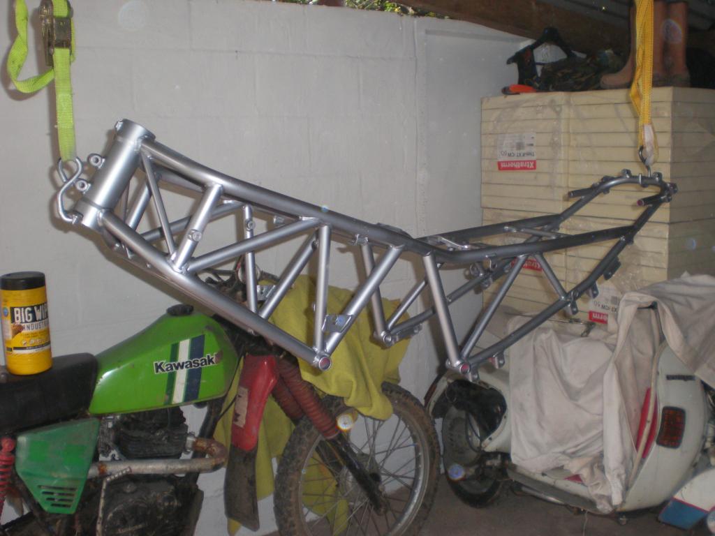

    samsung photos 402.jpg samsung photos 403.jpg samsung photos 400.jpg the first thing was to strip the frame so i had somthing to work from samsung photos 404.jpg
    then the engine and thats as far as it got for 4 years as i had to stop to do ther things samsung photos 395.jpg

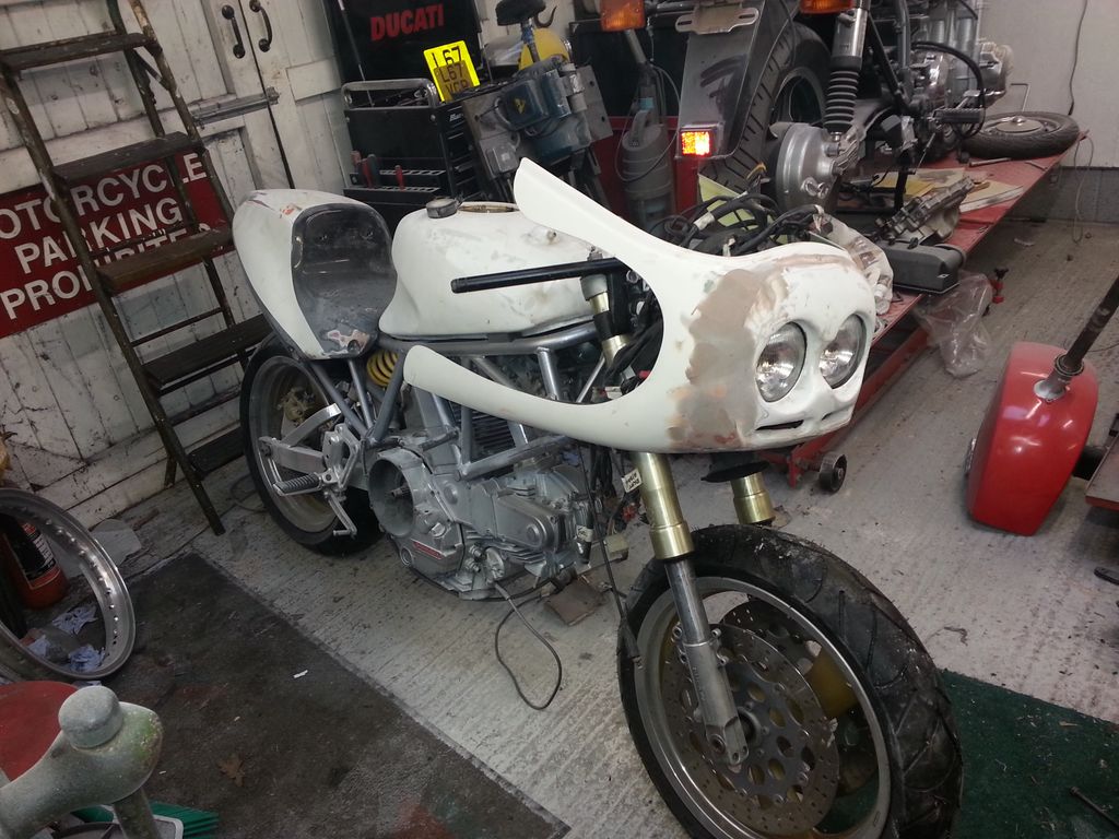

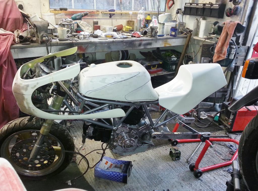

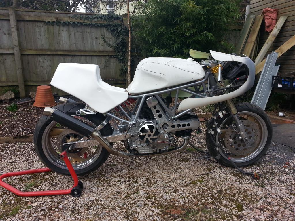

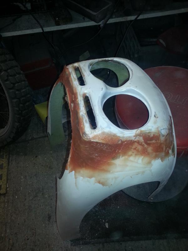

    allthe body work is by powerbronze and it was all damaged in an accident so i did think about repairing it but it was so heavy and thick i thought about a change of direction , i did buy a 3/4 full 900ss faring from germany (that i still have ) but never used it , but i did see on ebay a 900ss ducati with a bevel case faring on it and thought it looked great , i did ask the seller how i could get one and he told me i could have one for £350 plus vat fuck that i thought
    the lights and sub frame were good on my bike and i wanted to keep the twin lights so i found a 750r bevel faring on ebay germany for £70 posted with screen sorted so i just had to fix the two together samsung photos 352.jpg it looks rough now but it is very strong as it is bonded and then glassed in place

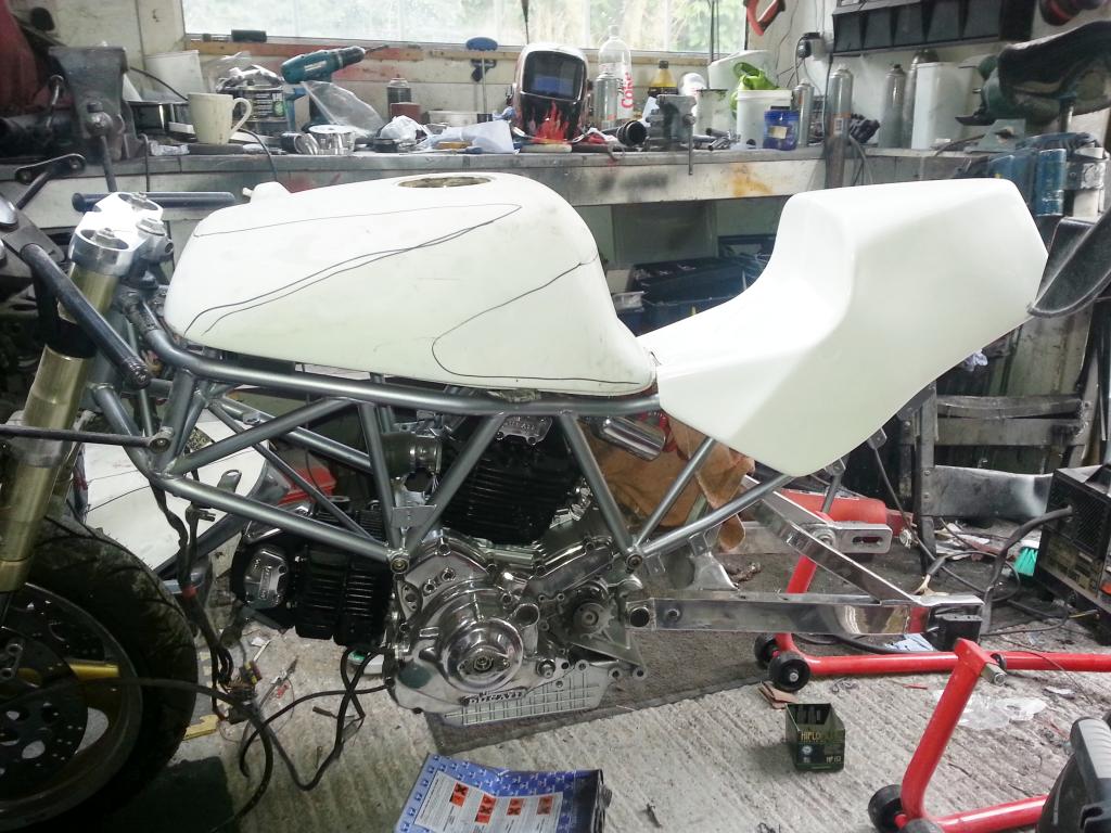

    the seat is the next for cutting back to give it a slimmer look as it now looks a bit bulbus next to the fairing , then paint and polishing and i may go against the norm
    and not do it red and do it in a retro silver or black , we will se

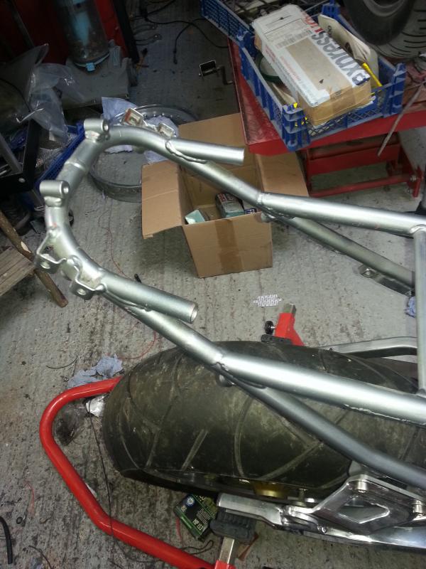

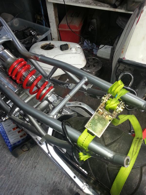

  13. seat arrived today , so i got out the grinder 20130214_140115.jpg 20130214_141214.jpg
    then the welder
    then the first dry fit before making up any brackets
    20130214_145448.jpg 20130214_162723.jpg it did take 3 goes to get the frame right , but it now looks to be ok

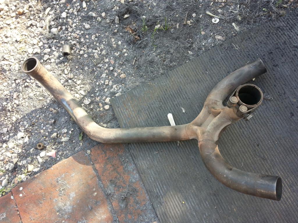

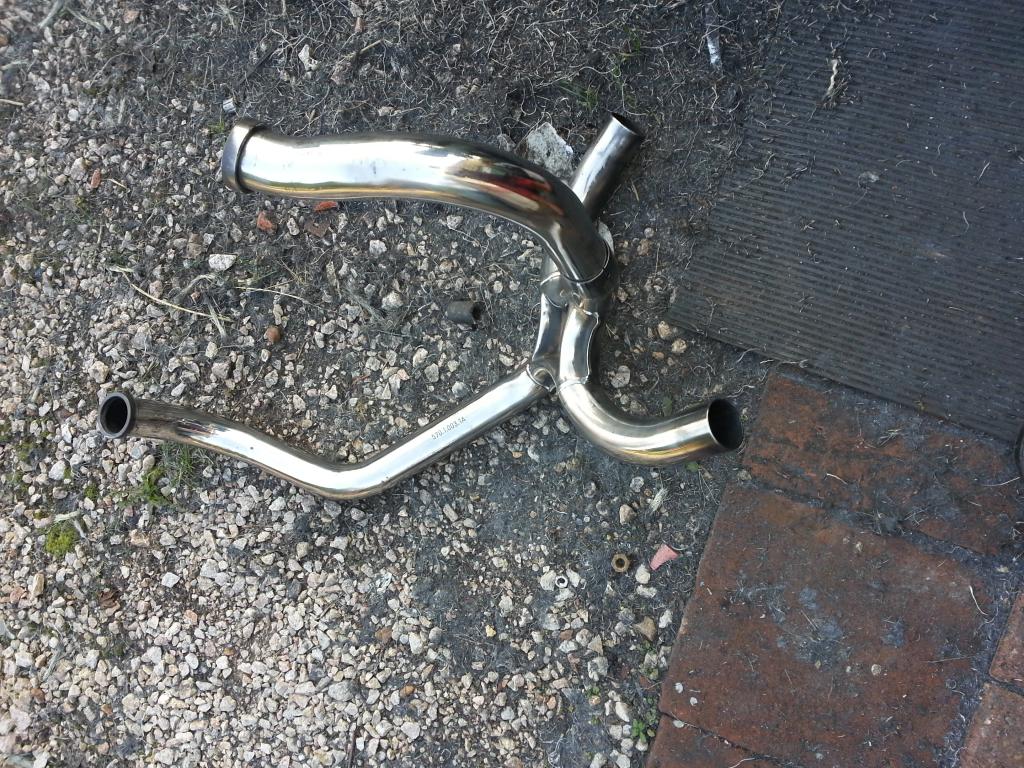

  14. 20130219_141615.jpg 20130219_150806.jpg Well after spending all afternoon polishing the 900's pipes ,i then discover that they are in fact the 750s pipes DHOO, now i have to start again :frown:

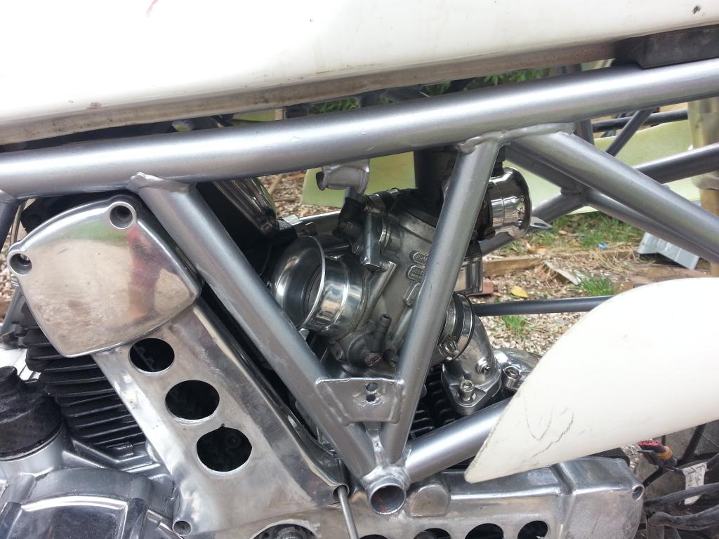

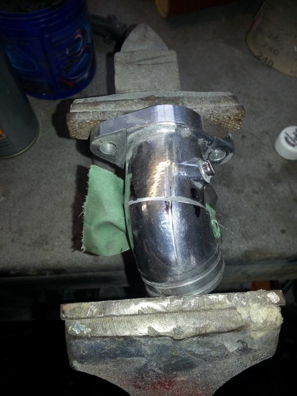

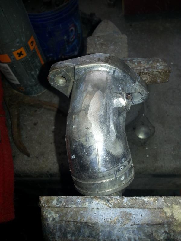

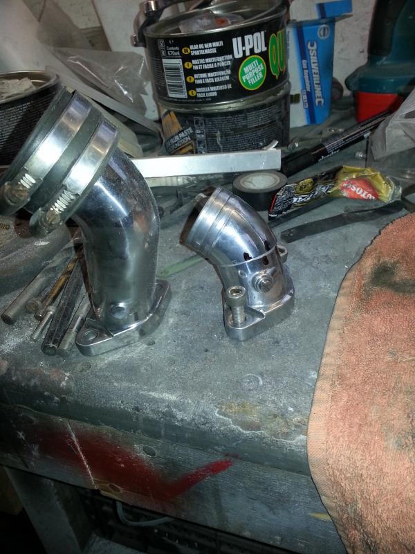

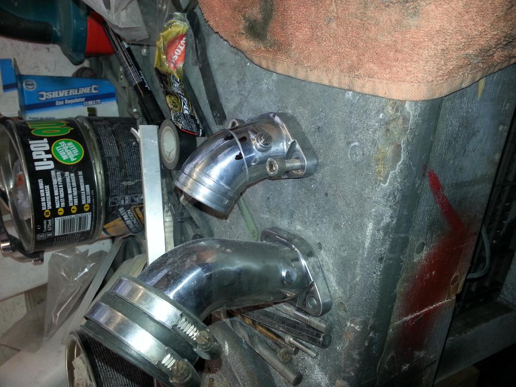

    had to cut down the the inlets to alow the use of the dellortos
  17. 20130415_101910.jpg 20130415_163842.jpg got to re-shape the front manifold as it fouls the rear cylinder head ,but its not far off
