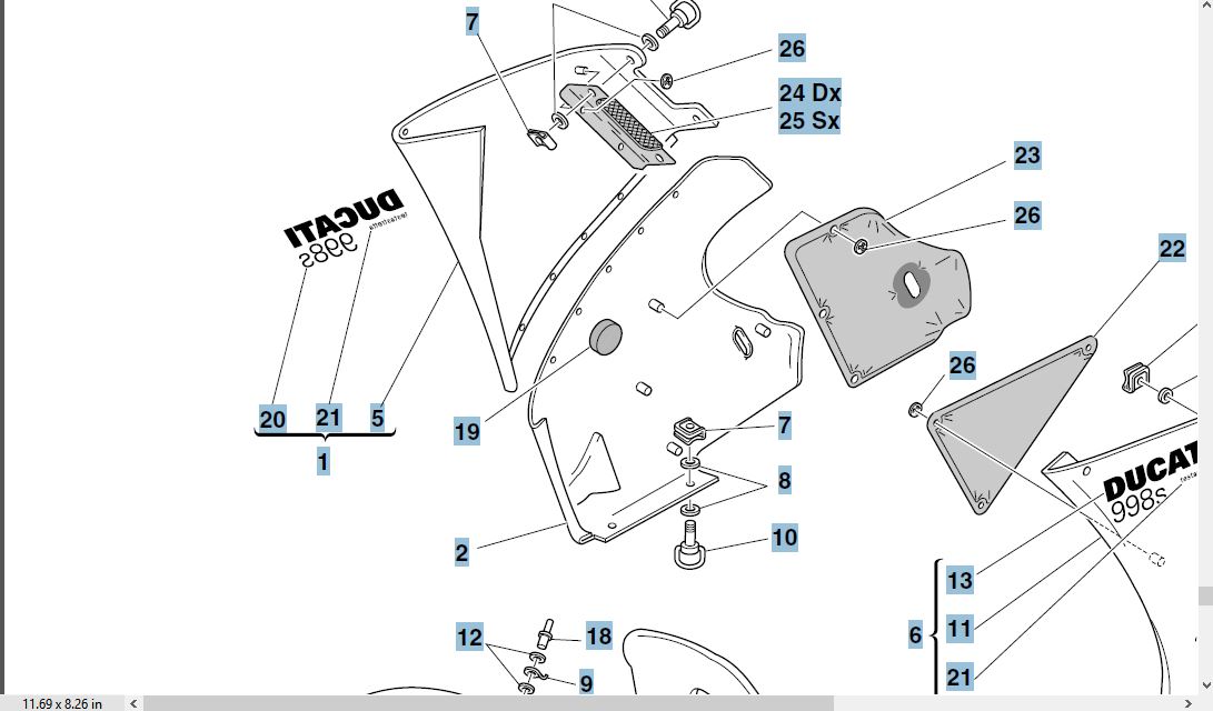

  14. Are you sure you've got the number of pieces to the fairing per model right Red? Did they ever change the configuration?
    I've got a deep-sumped 2002 998s with a carbon fairing, but the fairing is in two parts - each side of the fairing is the whole side - one single carbon casting - it's not split with rivets like the pics on your post's attachments. I think on my old 998 (not the s) each side of the fairing came in two parts - an upper and a lower, plus the belly pan.
  15. Im sure only the 998R of 02 bikes had carbon one piece side fairings as standard.So maybe aftermarket ones fitted to the above 02 998s bike.Ive fitted the same style one piece casoli moto carbon fairings to my 916sps with a carbon bellypan.
  16. That would a 998R fairing or a replica carbon or race fairing. See below for the extract from the 998S parts manual, the sides and bellypan can be clearly seen in this 02 model year catalogue listing. The stock 998 came with a 2 part fairing and no bellypan.
  17. american 998s had carbon fairings i think to make up for the fact they didn't get the deep sump 996r engine due to emissions regs
  18. The US Bostrom replica had one piece panels also but the 998S FE US edition had split panels.
  19. So I think we've established some bikes have one piece fairings, some have 2. My pals 4000mile 748SPS has red lowers painted yellow! Doubt this would've come from the factory but the rest is fine and he loves the bike so who cares.
