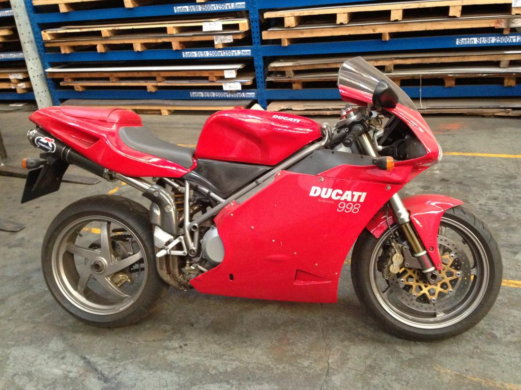

  1. Here's the bike
    just a quick question here

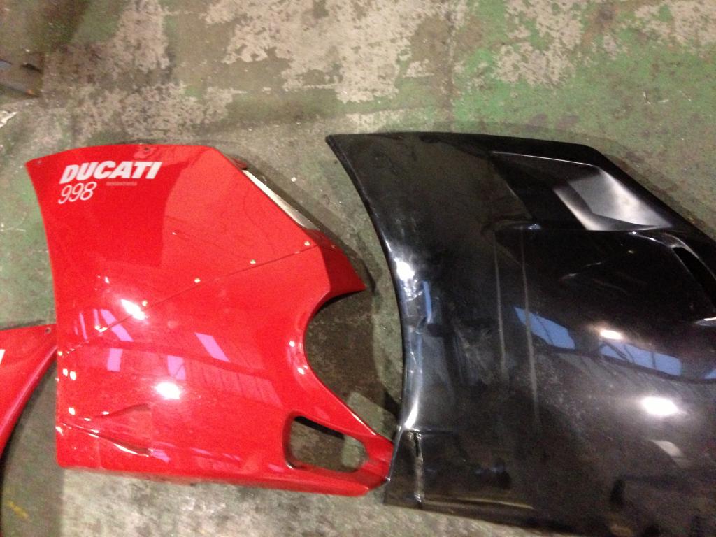

    I have a set of carbon fiber black gel coat race fairings i got these years ago for a 748 Road bike and was disgusted with the quality, but there the old 916 style anyone use these on a 998
    Can i just chop out where they hit stuff (Ducts on panels hitting coils, No hole for side stand)
    Whats the options here can it be done or will i be just wasting my time with these fairings
    Or who should i go too for cheap deal on new
  2. Its a track bike...make it fit :upyeah:
  3. Just the encouragment i was looking for, but have others made these fit

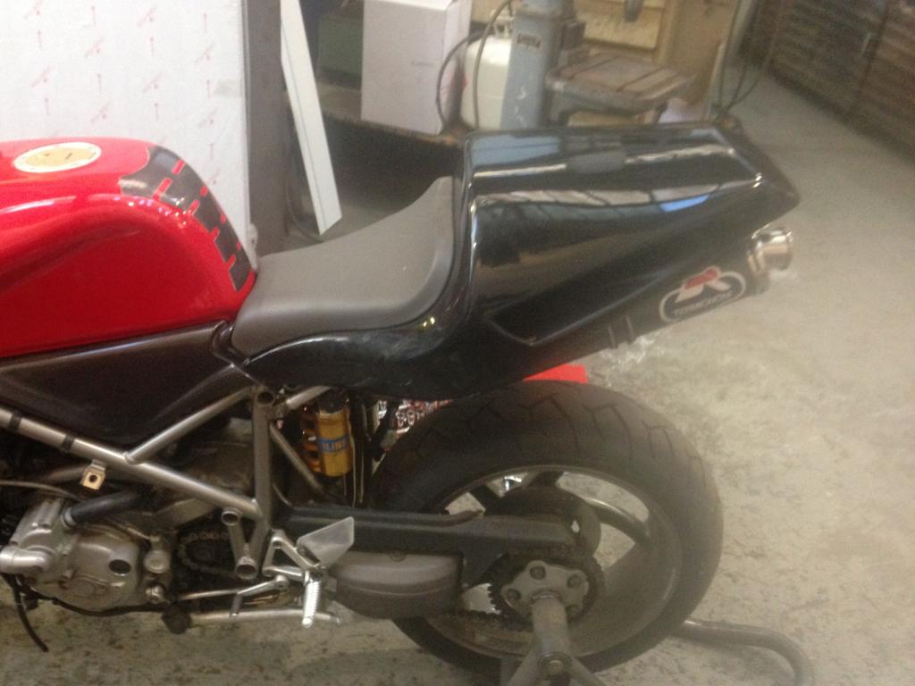

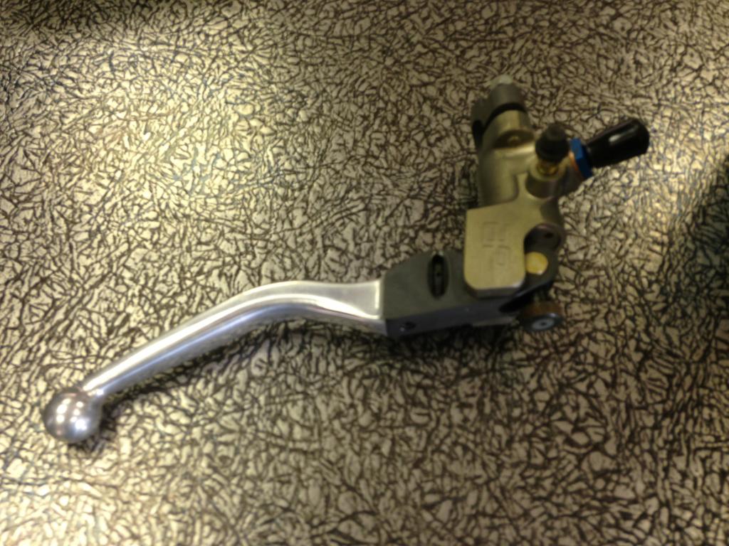

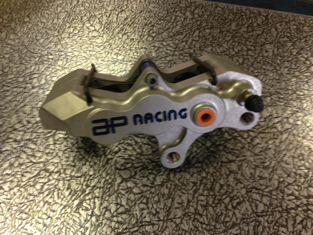

  4. Here's some bits i had laying around in the shed for about 6 years
    Think these got to go on, can anyone help where would be best place to go for brake pads for the AP calipers and what would i even ask for this was all ebay purchases from years ago so not got lots of info on them

  5. Great start then!
  6. I think you will be carving big lumps out of the fairing to make it fit and it won't look that nice, it's better to use the later 748/996 flat style fairings. Why not just sell the fairings on and buy some decent fibreglass ones.
  7. As far as I know 916 style side panels wont fit a 998 because of the air scoops interfere with fit. You could always cut lumps out etc, but its a lot of hassle. 998 panels do fit 9*6 bikes though.
  8. You'll find the ECU and the coils will be the thing most in the way and cutting lumps out of an old style panel is bound to leave them more vulnerable to damage in a crash.
  9. The bikes engine has had the full monty work done to it by sigma racing, so hopefully will be fairly reliable, on that note its done 64 miles in two years would I really need to change the belts anytime soon, I've got lots of experience working on Japanese engines and have rebuilt engines but most I've done to the Ducati is spark plugs, I really want to be able to do the belt changes and valve clearance my self, where's best place for service spares and with regard to belts and valve shims is there a set of different thickness available or just a case of ordering what's needed

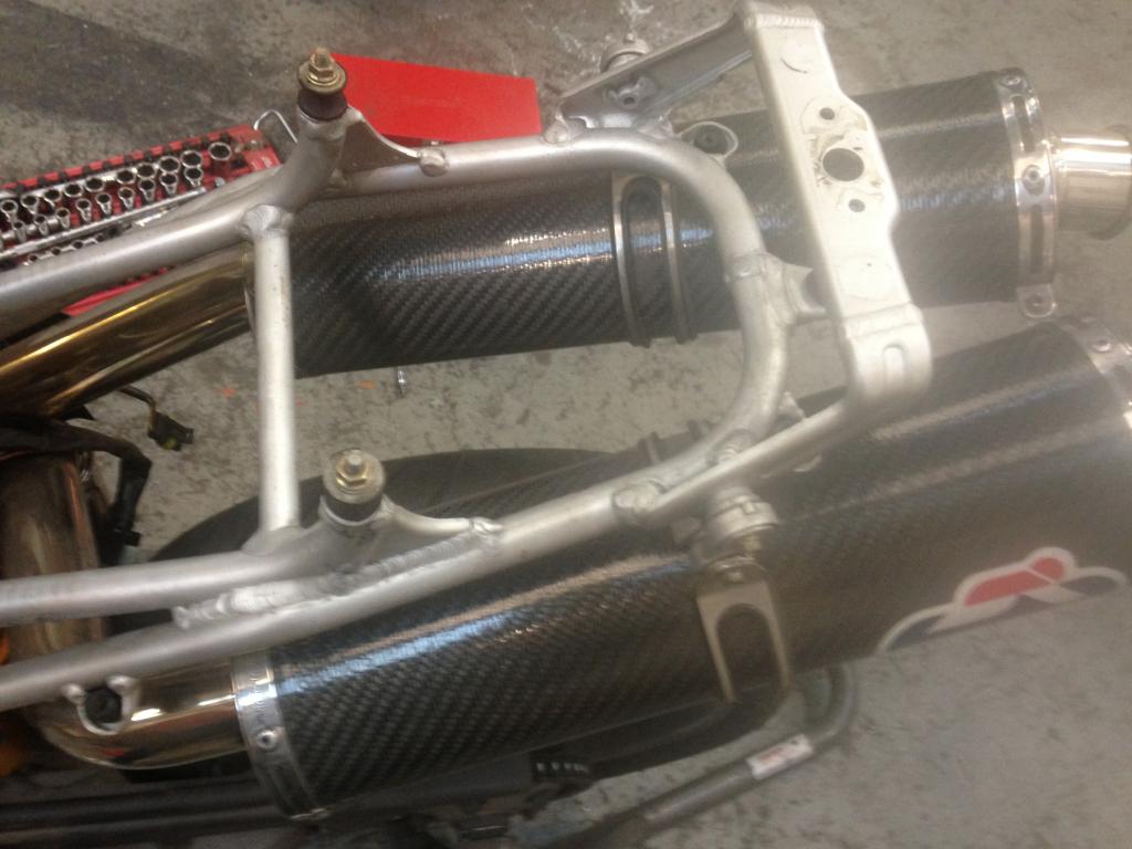

  15. This alarm removal looks like a right P.I.T.A my wiring diagram not even showing it grr anyway ill get there
    What about this guys, anyone know or got a pic of what should go on this subframe to support single seat unit IMG_0098.jpg IMG_0099.jpg

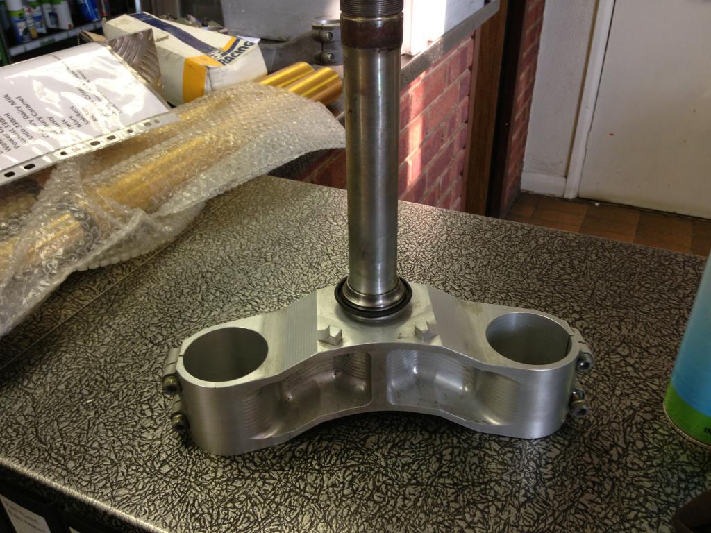

  16. Some pics for those that like pics
    Not entirely happy with the way the stem fitted, doesnt seem all the way home may need to take this off and have another look
    I fitted it years ago i remember it was super tight, got some taper rollers on order so be nice when bike is sitting on the ohlins road and track forks
  17. dont like the bolts on the outside of that bottom yoke.........looks like they will touch the fairing.........was it for a ducati?
  18. Yeah believe it was a kit that harris did, sure it must be for ducati as steering stem from ducati and came with the forks and wheel spindle all for ducati
