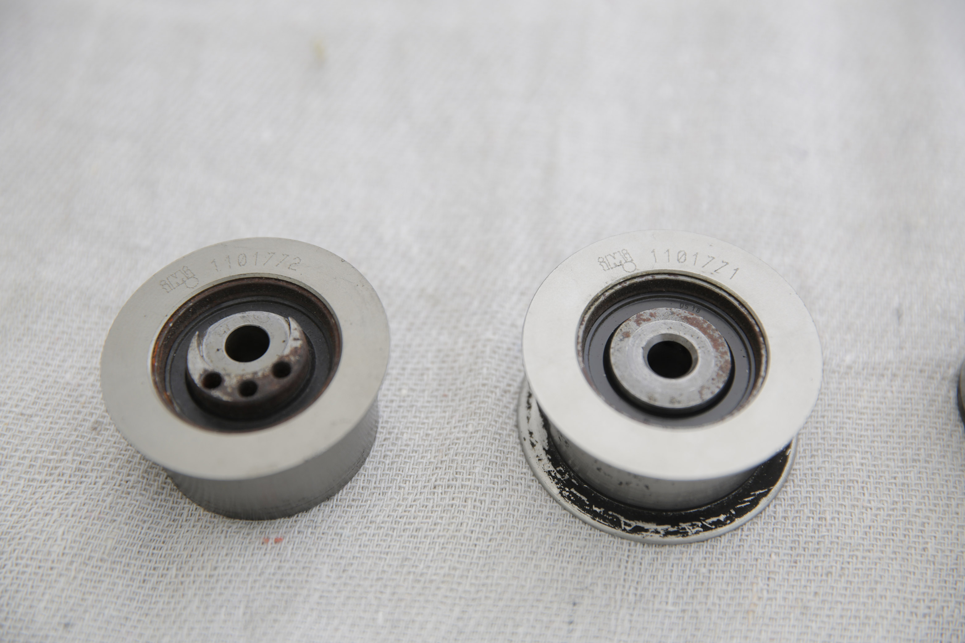

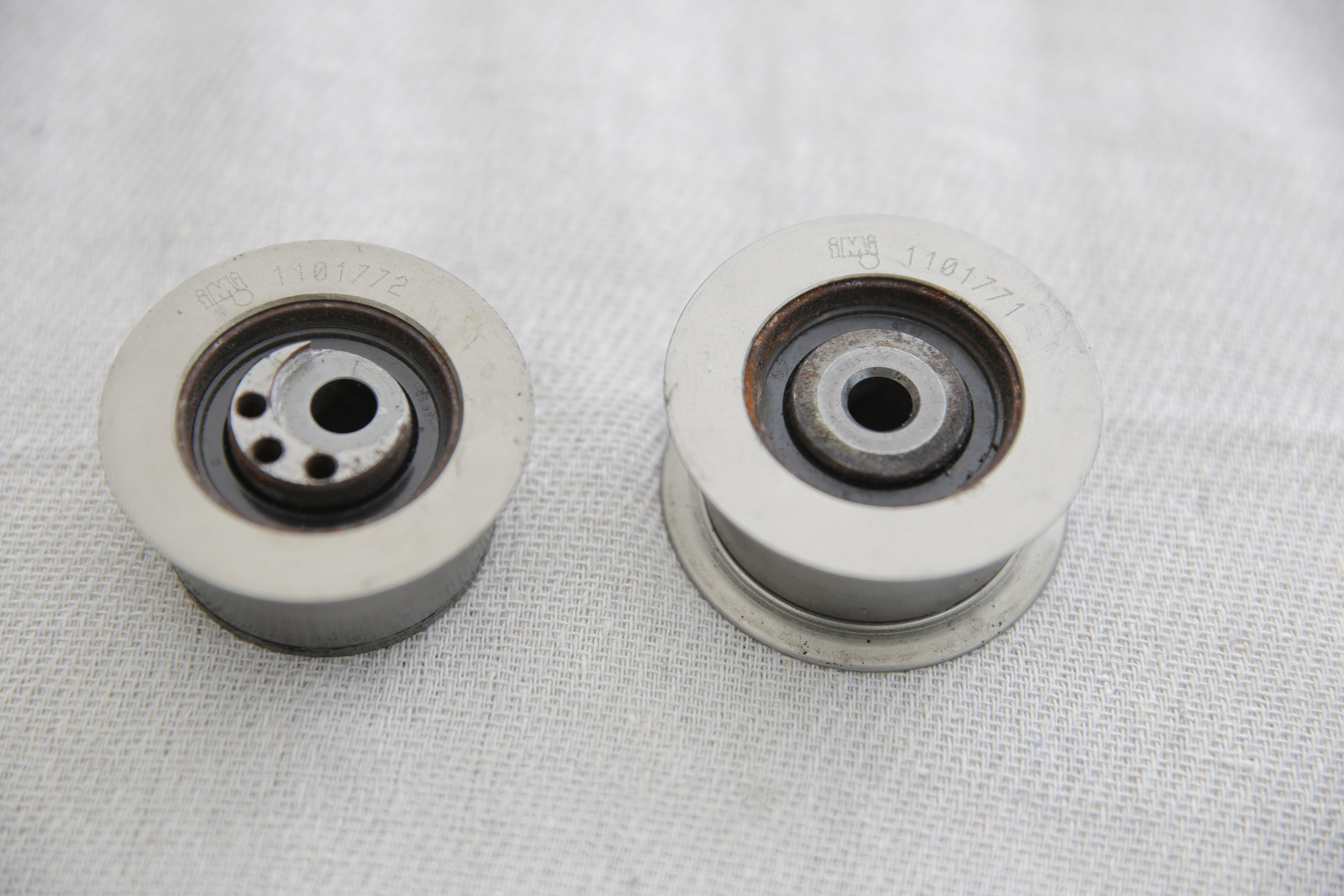

  2. Mine "scored" / original roller pullies are number
    IMI logo 1006336 (adjustable)
    IMI logo 1006335 (Fixed)
    Just a silly thought, given your numbers on a newer bike....serial numbers?

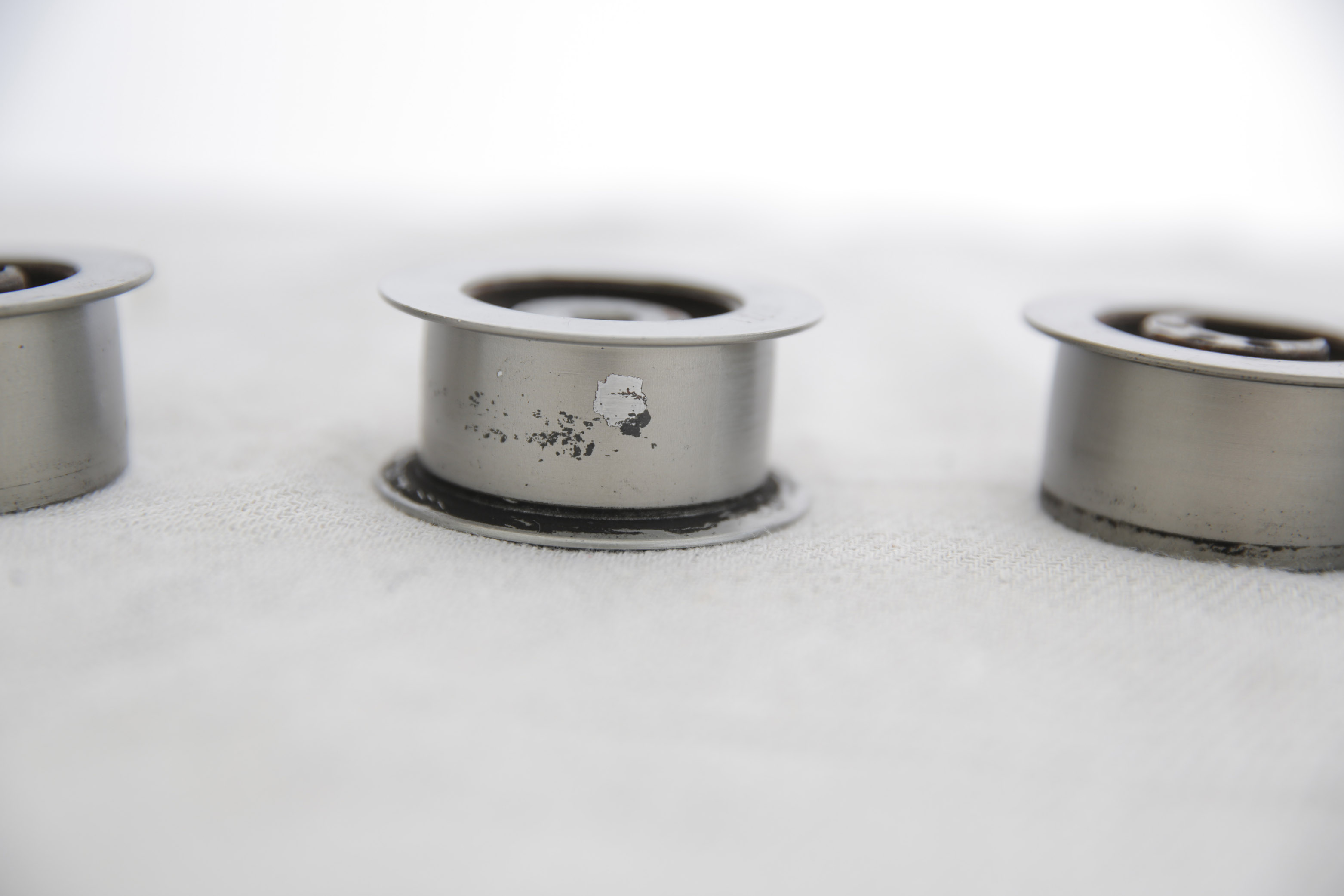

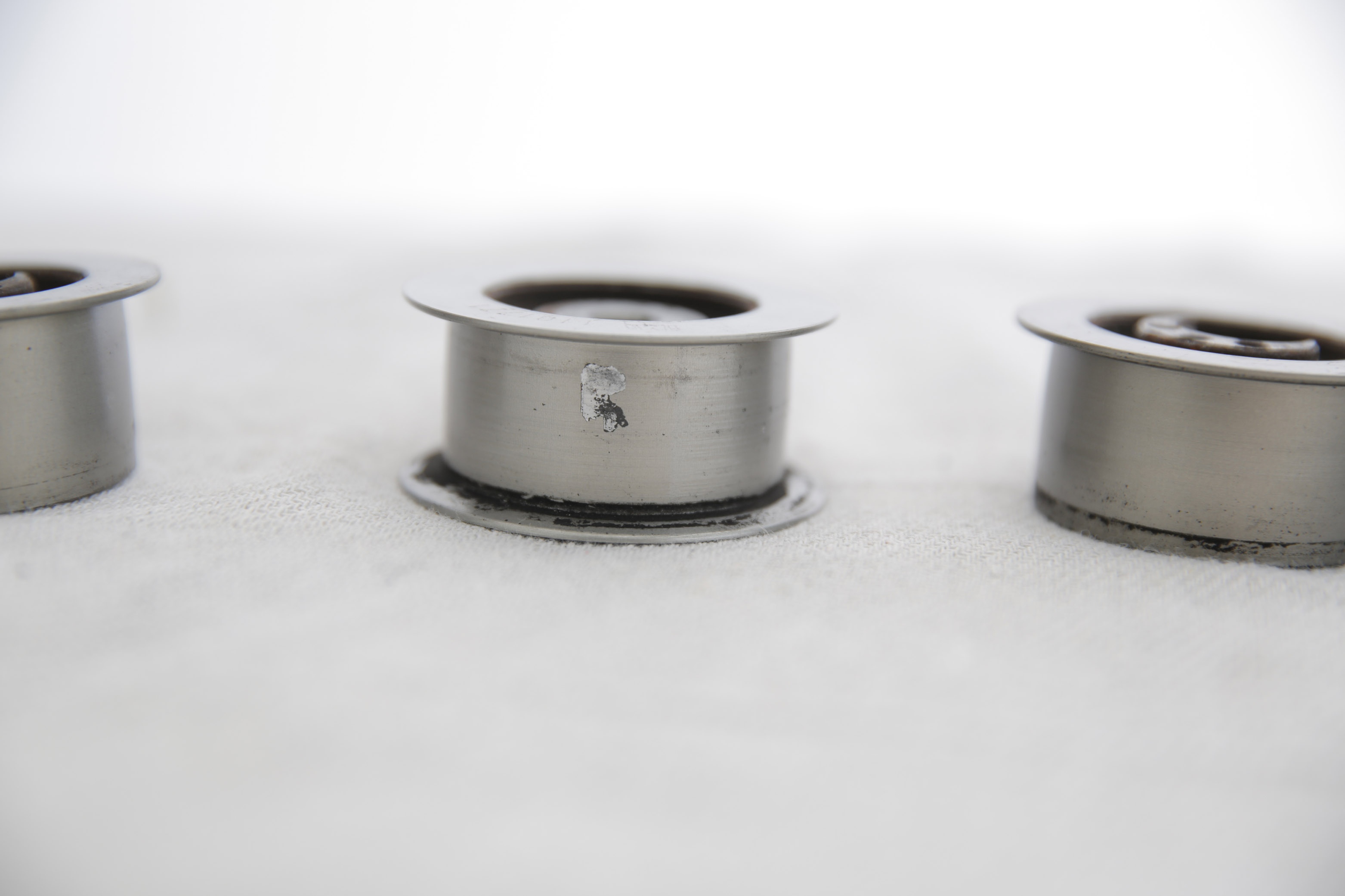

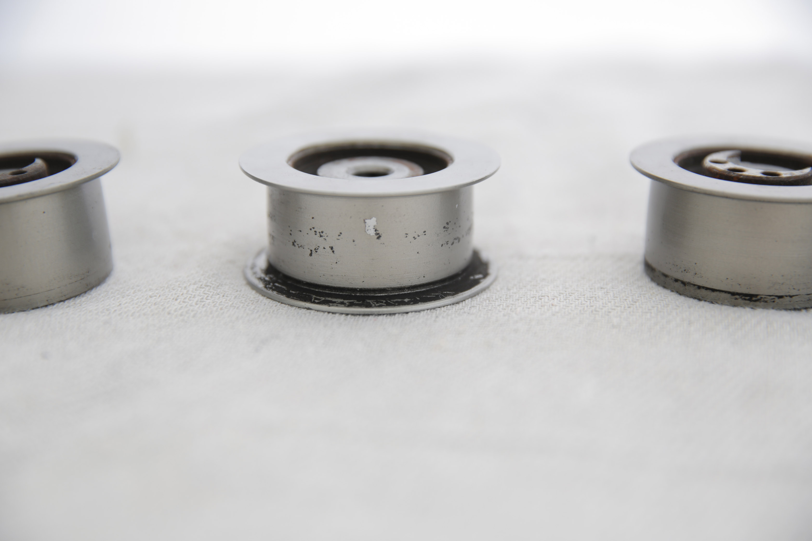

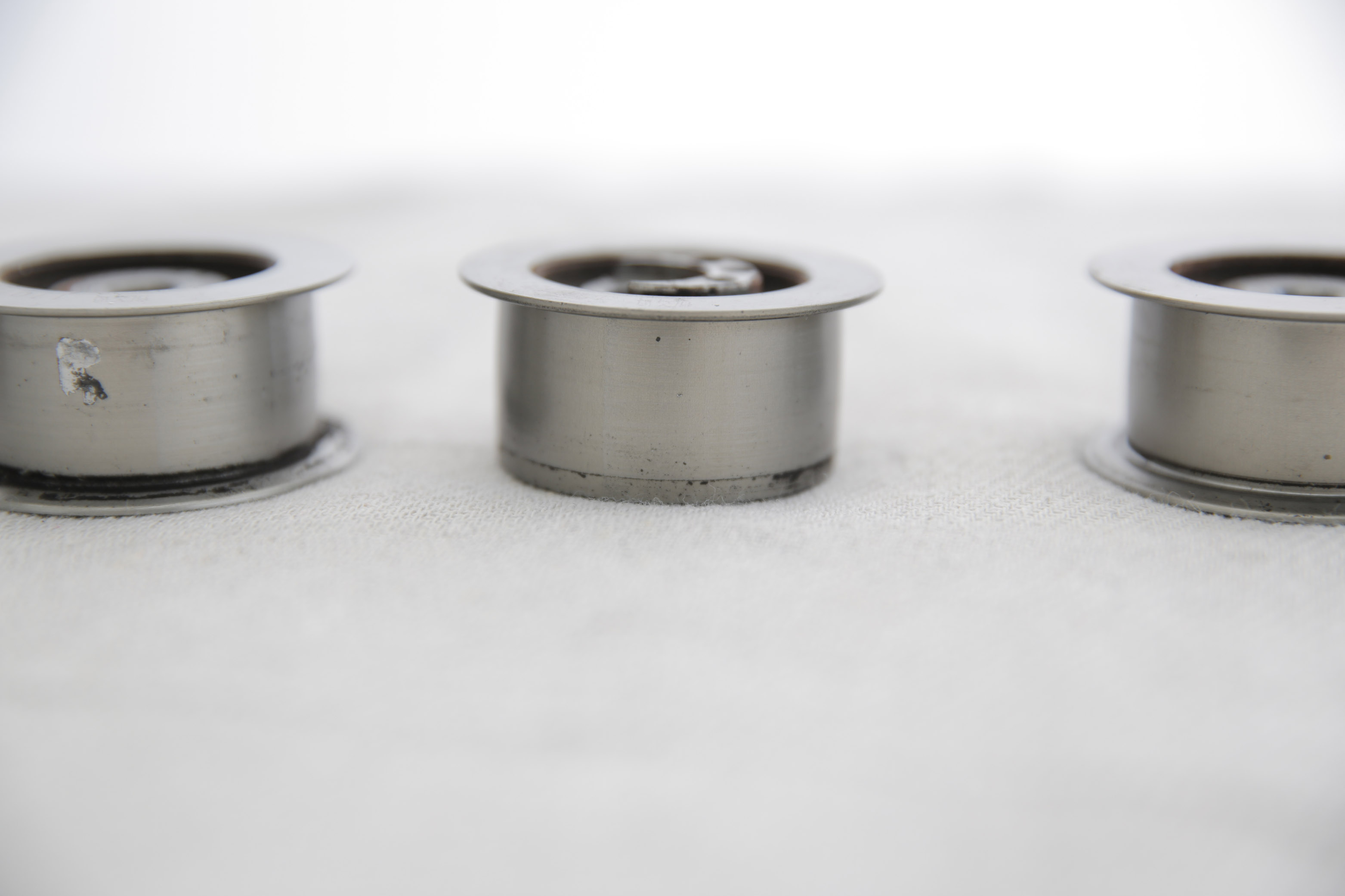

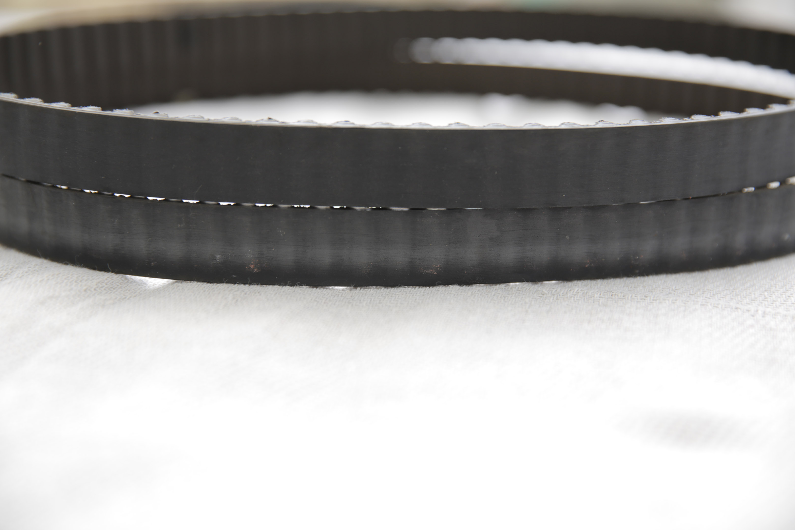

  3. Just a few observations;
    1. I've changed loads of Ducati belts over the years and the rollers invariably have a black coating on them that is material transferred from the belts, the beginning of which is showing on Andy's.
    2. The damage to the rollers shown looks more like a score to me. I suspect that the rollers are not the cause of the damage but a result of a foreign body getting trapped and causing the subsequent damage to the rollers and the belt.
    3. Toothed rollers invariably have shiny spots on them as there must always be some degree of sliding contact between the belt teeth and the pulley teeth.
    4. Regarding the numbers on the rollers: Ducati don't make everything in-house and many parts are outsourced. It's possible that Aircon's and Andy's rollers came from different suppliers, whichever had the contract at the time, or perhaps the supplier changed the number for some reason.

  4. Point 1 - OK
    Point 2 - As already said, note the thing that did the scoring was the metal "coating", as it was still embedded in the belt.
    However since none of the rest of the "coating" is showing any signs of coming off I think it was started with something else chipping off a piece that got stuck in the belt. This then caused the scoring.
    Point 3 - Ok.
    Point 4 - As mentioned already both parts are made by IMI.
  5. Will be interesting to learn the part numbers on your replacements Paul.
    Thanks Derek.

  10. Here's my de-plated pulleys. Belts seem to have a wear band along them. Cost me £445 for the 4 pulleys and 2 belts to be replaced! :mad:
  11. Update to my damaged pulley saga.
    After e-mailing Ducati UK boss and S.Cox a few months ago and recently e-mailing Ducati Italy with regard to my issue I have now been reimbursed the cost of the replacement belt tensioners, which de plated. So £189 is on its way to me. So although I had to pay out £445 I am quite satisfied with the result. As I had a belt service shortly after the repair work anyway where the belts were going to be replaced as per the service etc etc.
