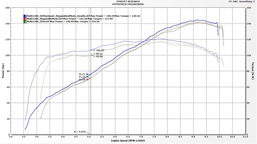

  1. Interesting, very interesting :biggrin: Thanks for posting and how can we introduce those Swedes to this site?
    These are serious gains and it will be interesting to follow how others get on and their experiences in use. What if you don't get the ECU tweaked? May un too lean I guess.

  2. Hi Kirky, - yes, v. interesting indeed, especially as
    a) After his remap it made virtually no difference below 7500 rpm (so surely couldn't have been a full custom job??) - although I think his bike is apparently the best stock MTS the tuner has seen.
    b) But then after the airbox mod. the low end gains (3250 rpm for e.g.) are huge.
  3. I've been looking into similar mods on a streetfighter. Stuff like this goes back to chopping the tops off SS and Monsters for the midrange.
    I wouldn't bother doing the right hand side mod. The intake tract he's cut off houses the air temp sensor and also gives some "ramair" effect. That's lost and won't show up that well in a static dyno test.

  8. its a misleading mod
    to do a comparison you need to run a fully mapped bike on both cylinders , do the mod then map that for fuel and spark on both cylinders. Then you see the real difference.
    The only thing you gain is sound and a top end ram air loss. I can see this on my dyno because I have the wind speed where others don't
    Recently we have put the snorkles back on two bikes .
  9. Yes correct
    Also an engine takes what it needs and not what flow you think you can give it by opening something .
    Look at the 749r . Tiny airtubes that are way smaller than a 748 . We built one with 160 plus hp recently ( bored to 998 cc) Out of Interest we slapped on some huge carbon ones from louigimotos store. Made a run , corrected the fuel for the bigger tubes and saw no gain at all.

  10. Hi Chris and thanks for that, my bike is definitely running better/pulling harder (even though I didn't open up the left side of the airbox) as has been reported by a lot of owners, some of whom have had Dyno tuning alongside the mod.....in fact it was Tom of Hypertrick that developed this mod as reported by one of his regular customers whose bike was tuned and tested on Tom's dyno.
    The two bikes you've replaced the snorkel on.....MTS1200s?
    I guess the actual airbox acess panel//intake had not been modified then i.e. the size of the opening increased?
    I wouldn't dream of arguing with an expert!.....but a couple of points/observations
    - it is possible that there could be an adverse affect on 'top end' (as you point out before and after Dyno would be the proof) but for me as a road rider that's of no consequence - but one of my rides since the mod was hard 'n' fast over 100+ miles of great North Devon roads and the bike was brill :D
    - loss of ram air effect......I find it hard to accept that there is much if any such effect with the MTS1200. The opening to the snorkel at the front of the bike is small, partially obscured by the beak panels (effectively the opening is limited to the area outlined in red in the image below) and the snorkel duct far from air tight in any case (you can see daylight a few inches down the intake tube for example). Also I bet air flow to the snorkel opening must be really turbulent due to air deflected from the beak panel pieces arrowed in the pic below....the design/implementation of the snorkel tube hardly makes for smooth air flow either. Maybe at HIGH speeds (100mph....on the track lol) there may be some small benefit to the snorkel being in place?

  11. Yes sealed the left side back up . And put the bend back in on the other side as it reduces air box volume , reduces the ram effect , and upsets the sensonsor in the pipe .
    This is the problem . Tuning goes against all simple logic .there are no hard and fast rules . The only rule is what works.
