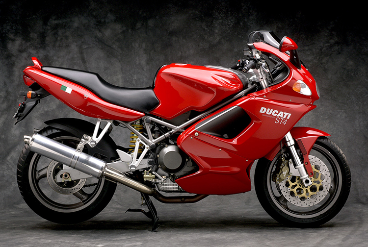

  1. Well as my Track Bike is off to a new owner I thought I might as well put up a thread detailing the plans for my new project.
    The basic plan is convert one of these:
    into something similar to this:
    That bike is the 9 1/2 race bike built by Radical Ducati, the bike I intend to build will be fully road legal but heavily track biased.
    The bike will keep the same look but will actually be mechanically quite different. That bike uses a monster M900 frame modified to fit a 999 tank and RD Café Racer seat unit and uses a ST2 944cc engine modified to accept a 916 Superbike Swingarm. I am intending to use the ST4 frame and 916cc engine modified to use the 999 tank and the RD Café Racer seat with the S2R/S4R Monster tubular single sided swingarm. The advantage of this is that aside from the seat and tank the majority of the main parts should be pretty much 'bolt together' requiring little or no modification to work.
    As cool as the old 3 spoke wheels are i want to bring the look of the bike up to date a bit, so I will be using the wheels from an 848 which means I will have to swap to the front end off an 848 or a 1098 to get the wheels to fit.
    As easy as I made it sound I am under no illusions about the challenge I have set myself, its going to be a pretty major undertaking but it should be worth it in the long run.
    I am on the hunt for a decent donor bike at the moment, I really can't wait to get stuck in!
    I've been reading through Nuttynick and PHILLIPOs superb radical build threads and i'm sure I will have a few questions for them in the next few weeks...

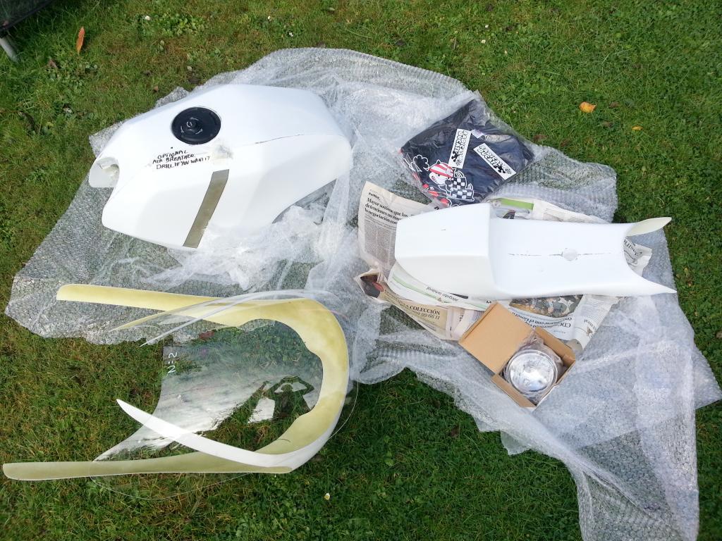

    a quick question for the guys who have already built Radical projects, did you buy your bodywork directly from Radical or did you use a UK supplier? I think I need a Montjuich seat unit but if possible I wouldn't mind having a look at one before I hand over some cash.
  12. Only just seen this thread
    Yes, happy to help where possible.
    I've known Pepo for nearly 20 years and speak with him on a fairly regular basis. I'm due to see him in Madrid around 10/11 August. As Nick will testify, Pepo actually speaks very good English, yet if any of you Radicalistas here want to PM me questions you might have, I'll try and get answers for you
  13. I got mine direct from Radical, it all arrived well packaged from Spain, no issues. I have a Monty seat unit on my bike, although I've cut it down at the front.
  14. Fantastic, thank you very much!
  15. well that answers that then! Thank you, Nick :upyeah:
  16. Here's my stuff when it arrived, it was just like Xmas!

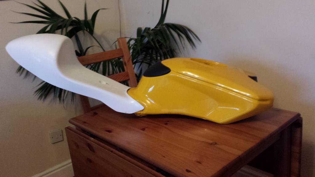

  18. And so it begins, i can't believe how well the seat unit fits to the 999 tank, it really wont need much work to prepare it for paint...
