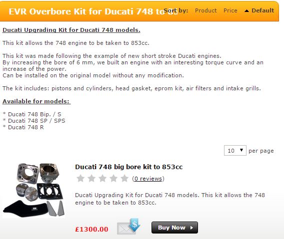

  10. Has anyone on here actually fitted a 853 kit , are they reliable , where can you get them and what sort of money ?
  11. if its more oomph you are after then by the time you have done the faffing about you might of as well of put a more reliable bigger better stronger motor in it ..i think the 853 came from an earlier era time has moved on....just my opinion..
  12. Of course the bigger newer engine would be the better option but if you were to go down the 853 route then I can confirm that it turns the 748 into a very nice bike to ride with noticably more torque while retaining the ability to rev, mine has been totally reliable with decent fuel economy.
    Steve
  13. There has been endless discussion about an 853 conversion and you have two camps, the "I've done it and it's great" camp and the "I don't understand why you wouldn't fit a bigger and newer engine" camp. I sit firmly in the I've done it camp and I'm going to do it again with my current 748RS engined track bike because it suits me and my desire to balance horsepower and torque for fun and not something that is going to spit me off if I get a bit too enthusiastic. I'm afraid your costs don't stop with the purchase of something like the EVR kit because the supplied EPROM is generic and you will usually get more benefit from a proper mapping session, cue another £400 to £600. To tie you over and get you back on the road the second hand route makes a lot of sense. Andy
