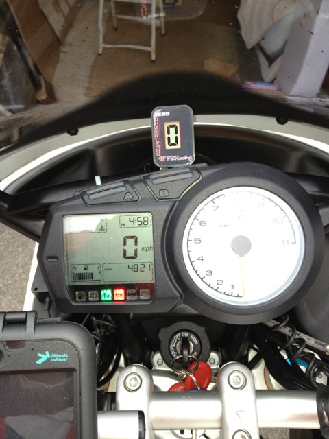

  10. I need access to the connector as I have a gear indicator from PZ Racing, coming. This plugs directly into the diagnostic connector.
    Pete

  17. Found it. Plugged in the gear indicator and it's working but it's a bugger to calibrate.
    The bike nearly hopped off the paddock stand when I tried it. Took it out on the road and couldn't find a quiet enough road to do it.
    So, off with the back wheel and try again on the paddock stand.

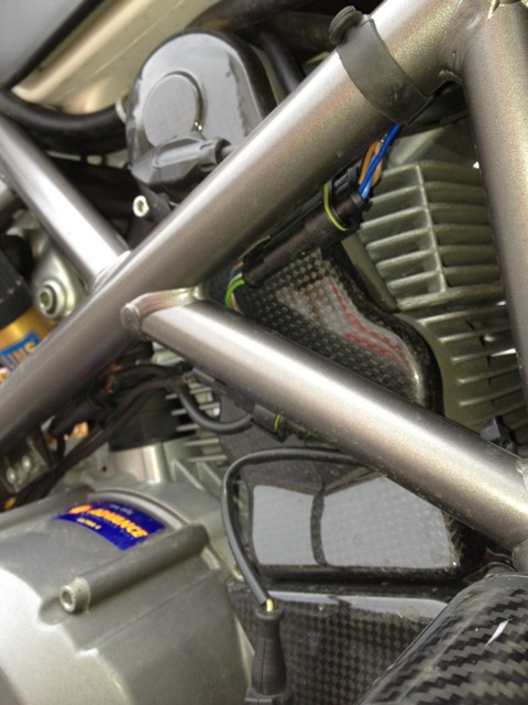

  19. Found the ECU connector, right by the battery.
    The wheel speed sensor was on the RHS attached to the frame just here
    All ok and just gotta calibrate it now. Tried a few times but my revs/ speed is all wrong so gotta try again tomorrow.
    The unit itself is great and it has 6 selectable colours for the backlight. The F option, which is blue, is identical to the backlight in the bikes screen. Anyway here is a pic of the unit in place.
    Will get a pic later of it in the dark so you can see the colour.
