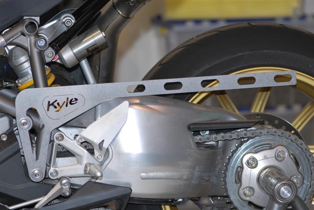

  1. evening all. Anyone got one for sale or one to lend us?
    Thanks, Ian
  2. What do they look like? :)
  3. Normally few on ebay
  5. Thanks Paul. I've seen them but are they going to be the same as the Ducati ones? I don't suppose it'd matter normally but I'm fitting the trx with a ride height adjuster and want to get the ride height something like before I start tinkering with the suspension. How did you do yours when you fitted your ohlins? Did you fit an adjustable ride height as well?
  6. Yes mate, that's probably the best option at the moment. Might have to go for that unless someone has one for sale. How does everyone go about setting their ride height without one of these? Is there another way around it?

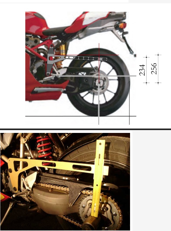

  10. Thing is, I'm trying to get into the more technical side of the bike and doing a lot of reading up on how to go about sorting the suspension. I've read that before messing with the suspension it's imperative to get the ride height right. And all the numbers I've seen have been taken by using this tool. But that's just it, are everyone's tools all the same? :)
    If not, them numbers will be worth naff all.
    Just trying to get some pointers...
    They also go on to say that while tightening the chain, you are affecting / increasing the height so needs readjusting...
  11. The tool is used to give a standard and repeatable datum. Measuring from fixed point A to fixed point B will give the same functionality.
  12. But not a direct reference to other settings, especially if it's a copy with slight differences in hole centres.
  13. Thanks for that. I need it cause I don't have a datum to work from until it has been set up.
  14. [​IMG]
    Only because this tool lets you set the height to factory specs. Using their numbers.
  16. So a copy could be out as suspected...
  17. Dimensions I produced from a Ducati corse tool
    • Thanks Thanks x 2
  18. Exactly! So how does everyone go about sorting this? Or nobody bothers cause it bollox???
