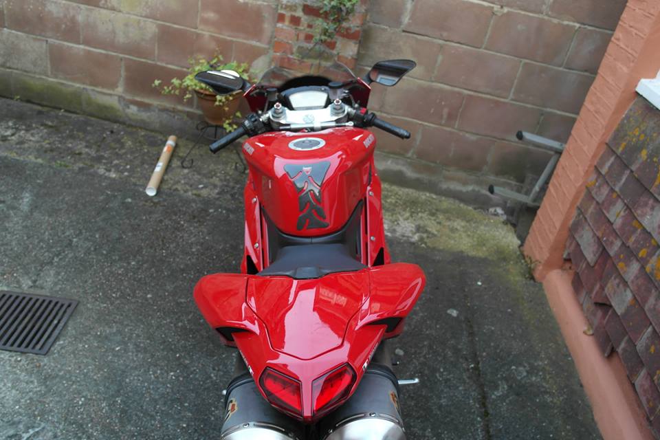

    completely standard bar the screen and carbon dash cover

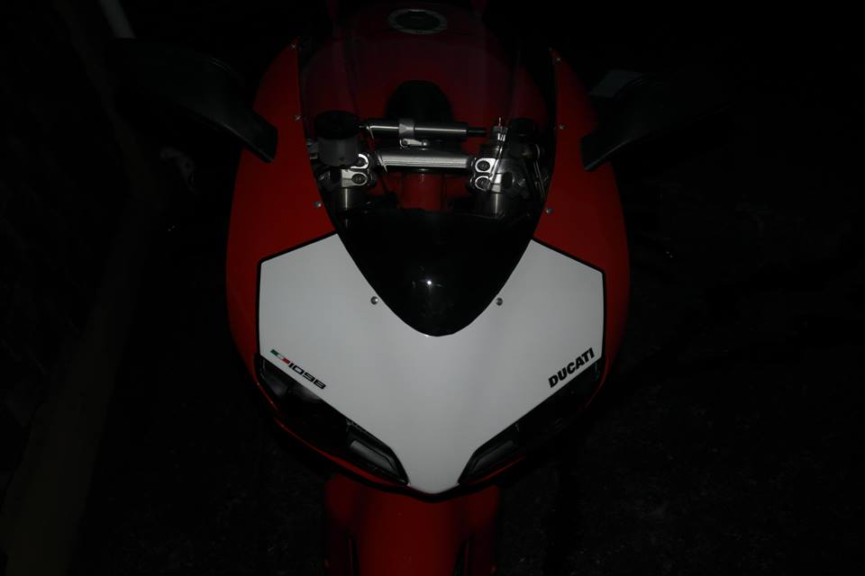

    First things first i love the red but it needed to be broken up a bit so number boards went on

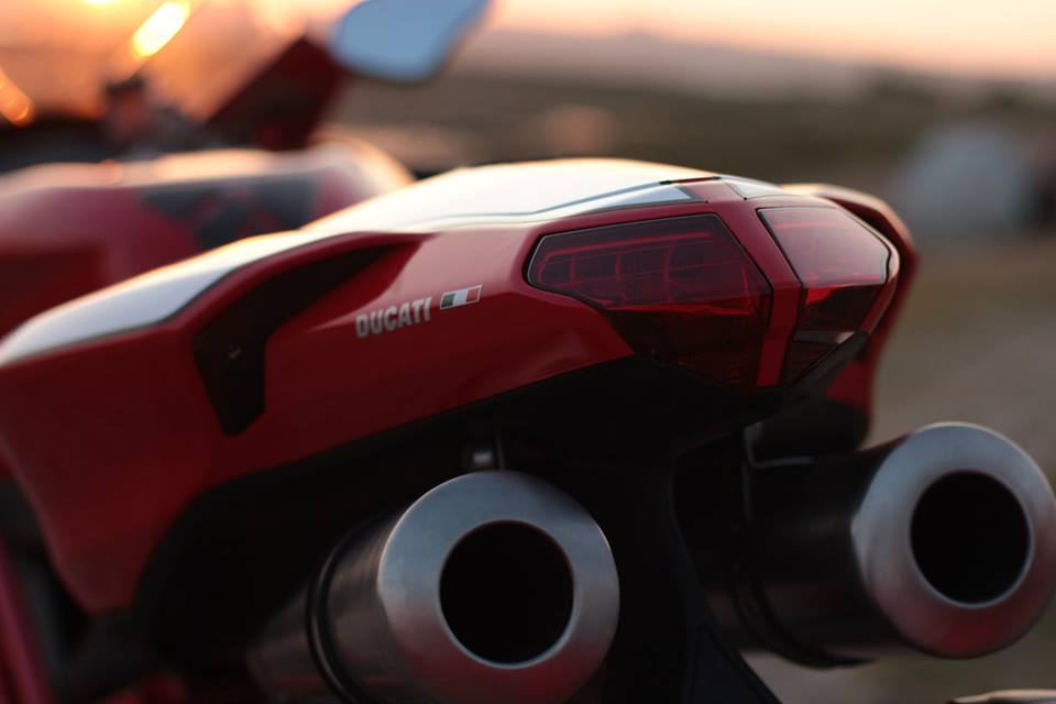

    next was to get it making some noise rather than sounding a bit like a fart in a bucket compared to majority of Ducati's on the road.
    They may only be cheap Chinese ones but the build quality is half bad and the sound is amazing

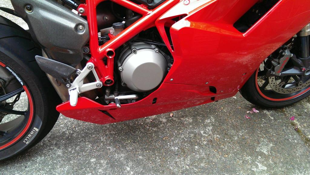

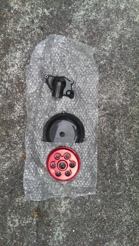

    Next was the clutch and some carbon heel plates (£10) and a carbon water pump cover thing also £10
    thanks to Nelson for the pressure plate :upyeah:

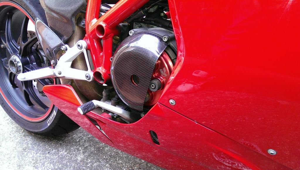

    Although after fitting the new plate the i could barely pull away as the clutch was just slipping like a mo fo. I made sure the markings were lined up is there any reason this would be happening?

  4. Sounds like worn clutch but dont these things have stack heights which are adjustable and super sensitive? One plate wrong and it foils up
  5. all i did was take the old pressure plate off and put the new one on
  6. Ar right ok cant see why its problem then. Thought you had replaced with a slipper. Only thing would be take off, put back and torq bolts. Thats the limits of my knowledge...
  7. Something isn't seated correctly.
    Is the rod in the bearing all the way?
    Is the bearing in the plate all the way?
    Is the rod pushed in the slave all the way?
    Lets go all the way
    Lets go all the way
    Yeah yeah yeah yeah yeah
    Lets go all the way

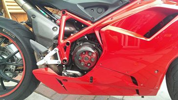

    Hard to see from pic, but yr plate looks high over the stack.
  8. Pressure plate has to line up correctly. There should be a dot or arrow by 1 of the spring pockets that lines up with the spring post with a line on it. Jiggle the pressure plate to get it to locate on the hub before fitting springs and screws, Don't over tighten them, just nip them up, the posts are alloy and can break. If clutch is still slipping, compare o/e pressure plate with new to see if the inner part is machined to the same depth. Aftermarket pressure plates do vary, you might have to increase the plate stack height by swapping 1.5mm plains to 2mm plains to gain a bit of stack height.
  9. you need to take it off again and compare its height or thickness to the original one that was on there. i bet the red one is slimmer hence less pressure on the plates hence a slipping clutch
  10. Did you have the pressure plate off for a length of time? I did mine a long time ago, left it over night and similar happened! Hd to bleed the clutch to get it back to normal :smile:
  11. iv put the std plate back on now running 4 springs as iv seen on here its possible to lighten the clutch, this was much needed due to lack of climbing my arms and wrists have become very weak. what iv now found is the clutch is slipping every so often. last night i went out for a blast and pinned it in second and as hit got past half revs started to slip do i need to get some better clutch springs?
  12. Surely by removing the springs you're increasing the chance of it slipping? Ie the rod off the slave disengages the clutch by moving the pack apart, the springs provide resistance to this to stop it doing it under its own load. By removing springs you've reduced its ability to hold properly?
  13. Sometimes 4 springs works, sometimes not.
    Often depends on how good/worn your plates/spring are.
    • Dislike Dislike x 1
  14. At the end of the day there re 6 spring of a value x if that is 5lbs then there is 30lbs resistance as standard...........take away two springs and you are losing 33% of the pressure down to 20lbs...no wonder it slips..............
    A ducati 4 spring slipper would have in this example 4 x 7.5lbs......to get the correct pressure plate value.
    simples.......
  15. exactly, in theory they'll all have the same weight to them as they need to provide the same amout of force, that being with any number of springs.
  16. Ok fair enough, it does make sense iv got the std plate on there now with 6 springs so all is good.

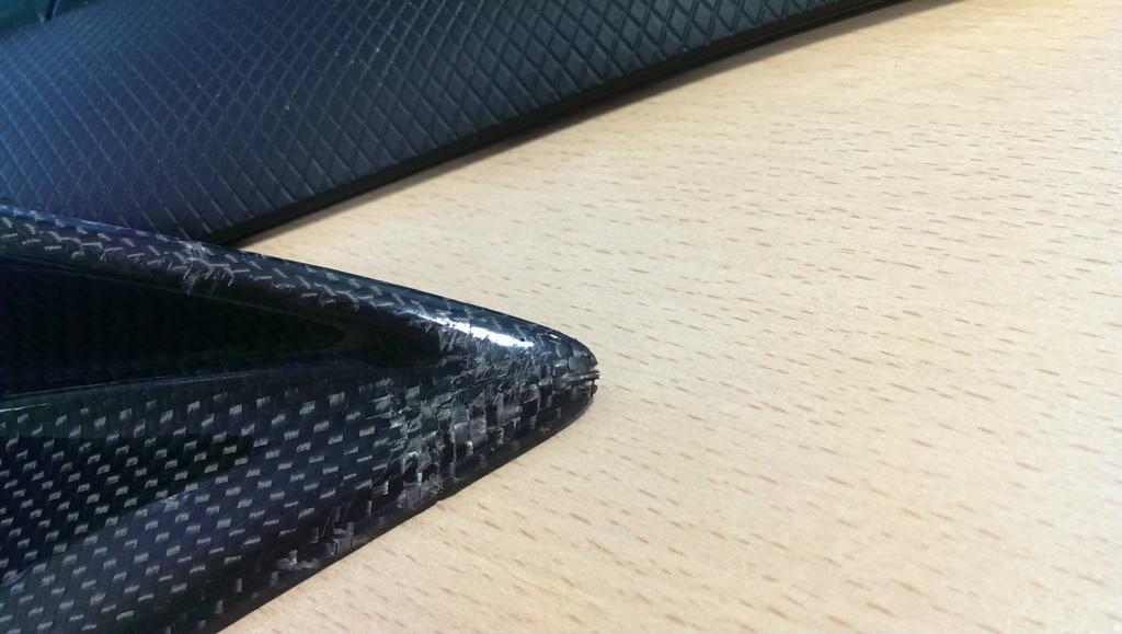

    Also iv had some carbon delivered but I'm guessing the guy butchered them trying to get them off. Are these repairable? or any ideas on how to neaten them up
  17. 2000 wet and dry the scratches out of the resin and then autosol back up to shiny.
