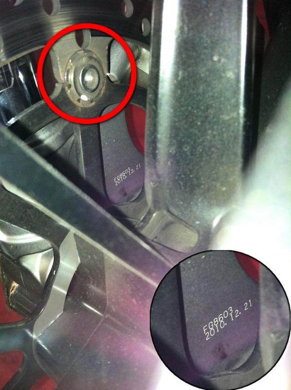

  11. Interesting this. I noticed the lower fork legs on my 2012 bike are definitely different to those on my 2010 bike (both Ohlins obviously).
    Where is the number located on the foot - inside face, bottom edge ?
    Just so we know where to check :wink:
    Oh, and thanks for posting :upyeah:

  12. on the inside, lower range

  13. The number is on the inside of the bottom of the right leg, in front of the caliper.

    This is a Technical Service Bulletin rather than a "Recall" - so no letters going out to owners unless your Dealer takes it upon themselves to do so. Which, I guess, means Ducati believe the issue to be either very unlikely and/or non critical in the case of it occurring.
    Quote from a technician at Ducati Bellevue USA:
    "TSB 14-002 involves the right fork leg bottom. identifying marks will have on the inside of the bottom numbers FG860 or FG8601 or FG8602have your dealer inspect for those numbers and run your vin number w/ Ducati only on 2010-2011 MS1200's
    All vins showing needing these parts will get them if they have matching code numbers listed above.If your vin shows up needing this TSB but the fork leg codes dont match then they will be documented and nothing else is needed.
    parts come as kit w/ new fork lower leg, dust seal and fork seal and 4 new pinch bolts screws 2 for the new fork leg pinch and 2 for the left fork leg pinch to axle.
    Good time to get your other fork leg oil changed for a small fee as one fork leg will have new oil"
    The fork part ID code is located on the inside of the caliper mount and can be seen through the wheel.....
    ....not my bike ;-)
  19. I noticed: :wink:
