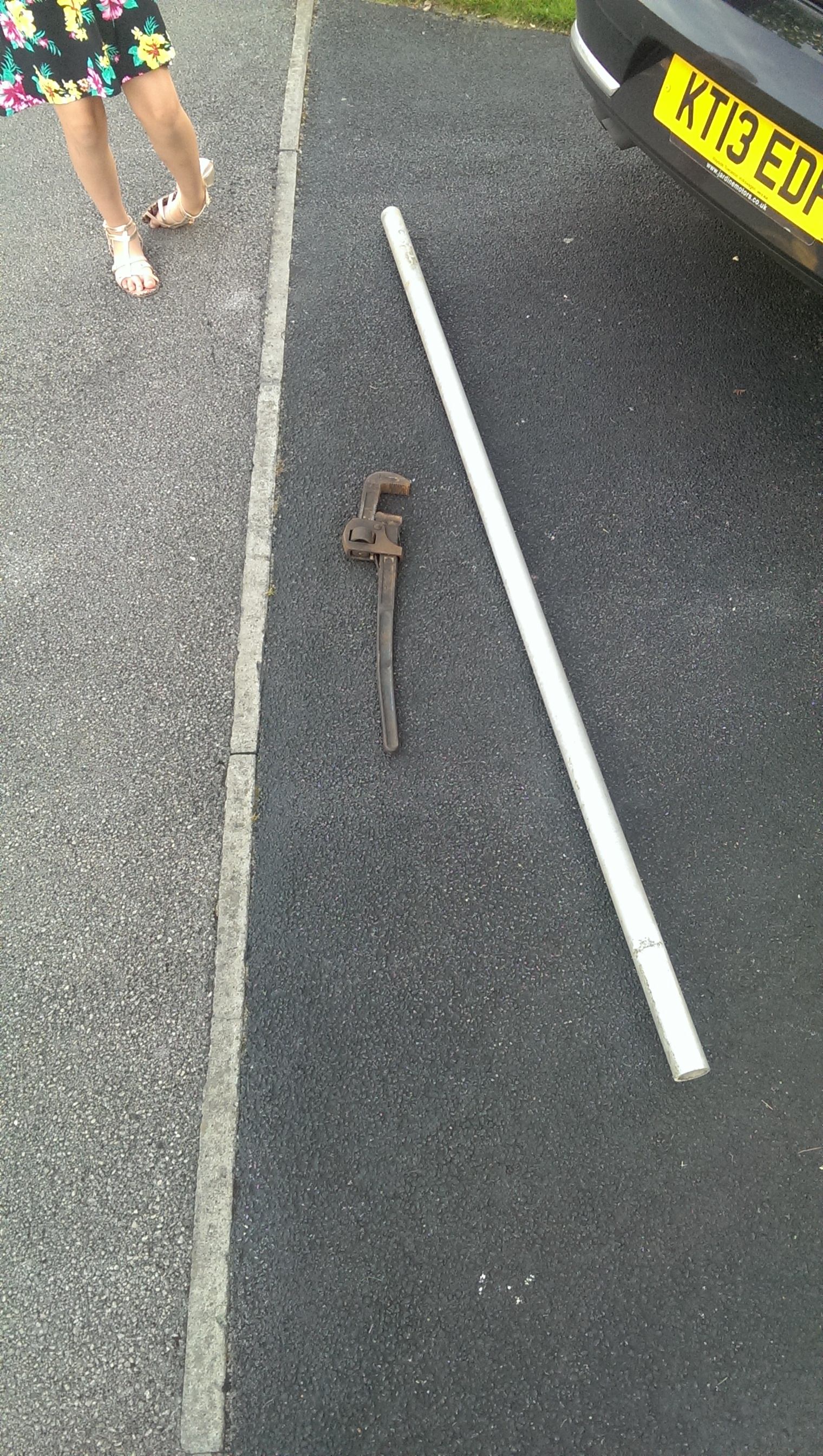

    I have now supersized things a little :)

  19. not with a pipe wrench on a pole it won't. there will be tears...
