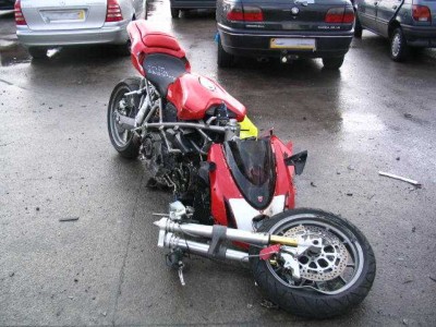

  14. is that the long wheelbase version?
  15. Oh you guys kill me you really do lol
