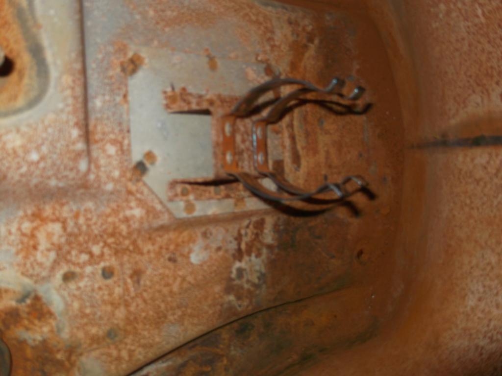

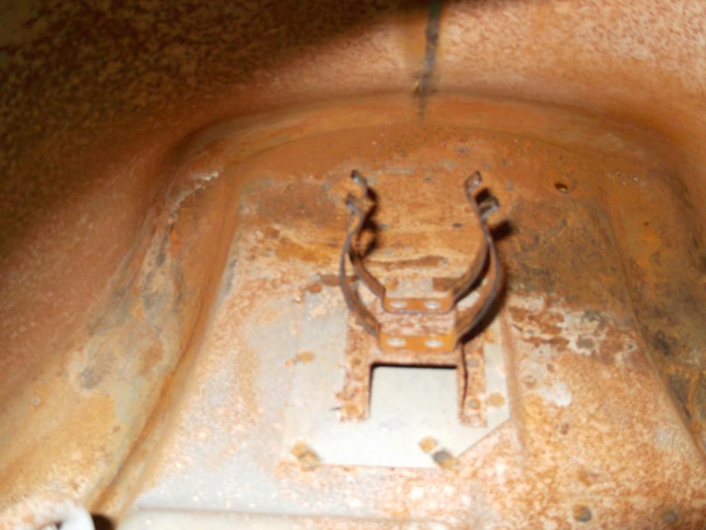

    Will be updating when I get chance to work on her. Bought from Gumtree
    locally on just over 6k on the clocks and 3 owners. Last on the road in
    1995. Tank leaked as soon as put petrol in (must pay more attention in the
    future when buying!) Will try and find a before photo but to paint a picture

    I will be repairing this with the now famous POR15 - have used it 3 times
    before with great success. So will do a picture by picture as I use it.

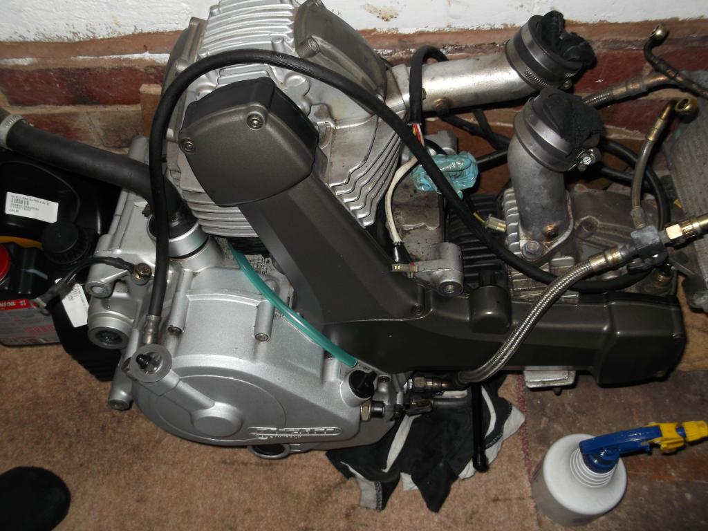

    Stored and labelled waiting attention.

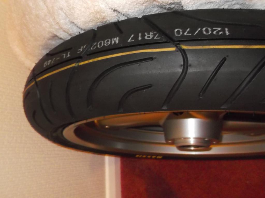

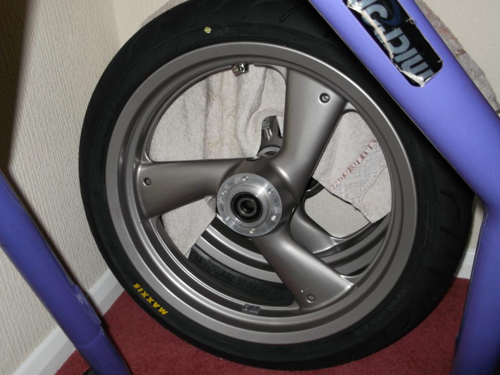

    Again the wonders of WD40 - underneath years of grime some
    decent looking wheels. They have the odd mark here and there
    but don't need a refurb. Tyres are Maxxis Touring at £127 the
    pair delivered not bad I thought. (Let me know if you want the
    details of where)

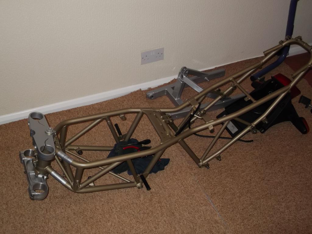

    These had to be repainted as were too scuffed to be in keeping with
    the rest of the bike. Would rather paint than powder coat if possible.
    If it was OK when new should be OK now.
    Frame come up very well, will just be touching up the odd scuff and chip.

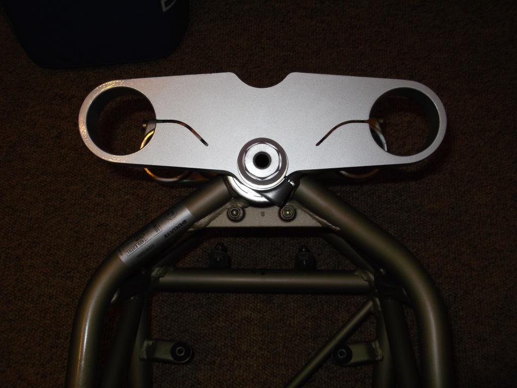

  4. Finally got some more time and money to carry on. A few more photo's of progress to date.

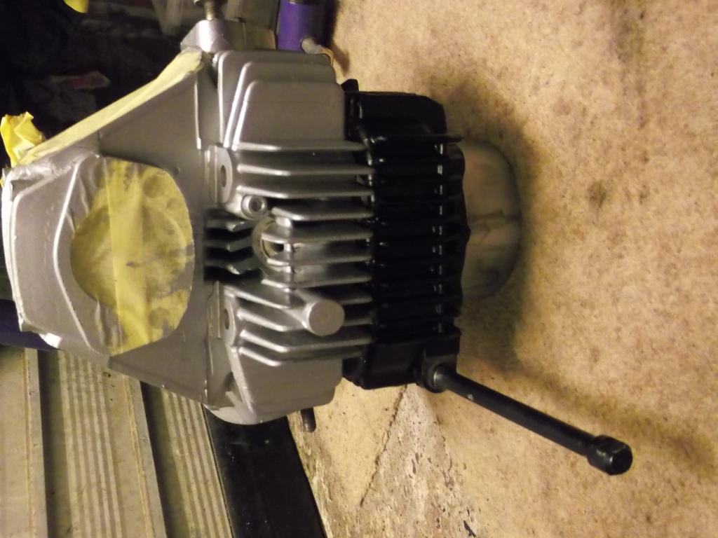

    Engine stripped to cases - cleaned and repainted. The covers will be repainted when engine is back in the frame.

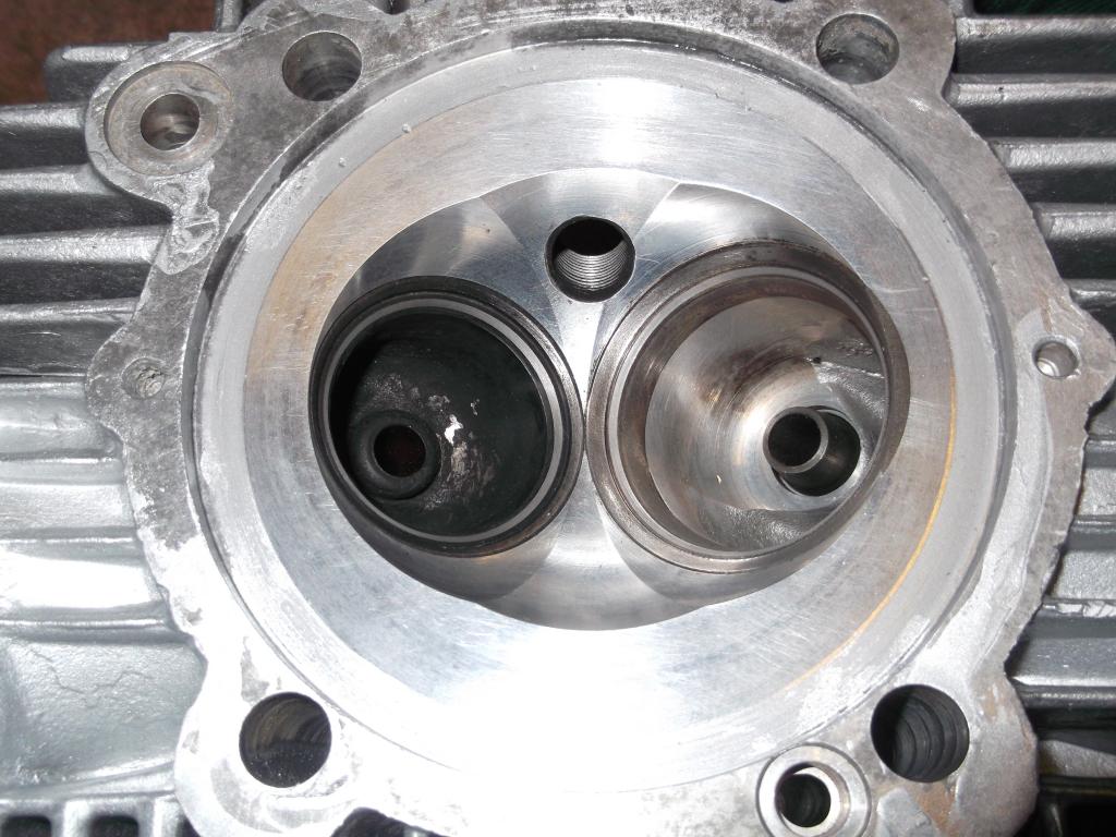

    Pistons cleaned ready to be refitted. Heads cleaned and valves re-lapped.
    Just waiting a few parts (and some time) to put back together.

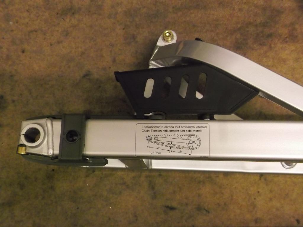

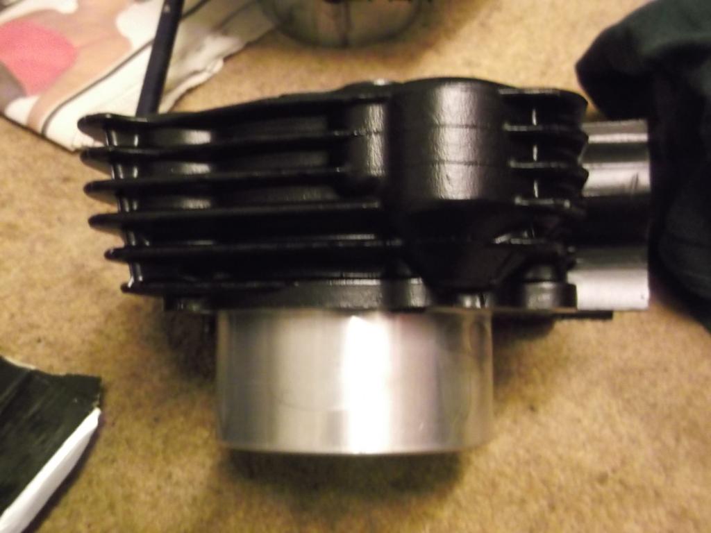

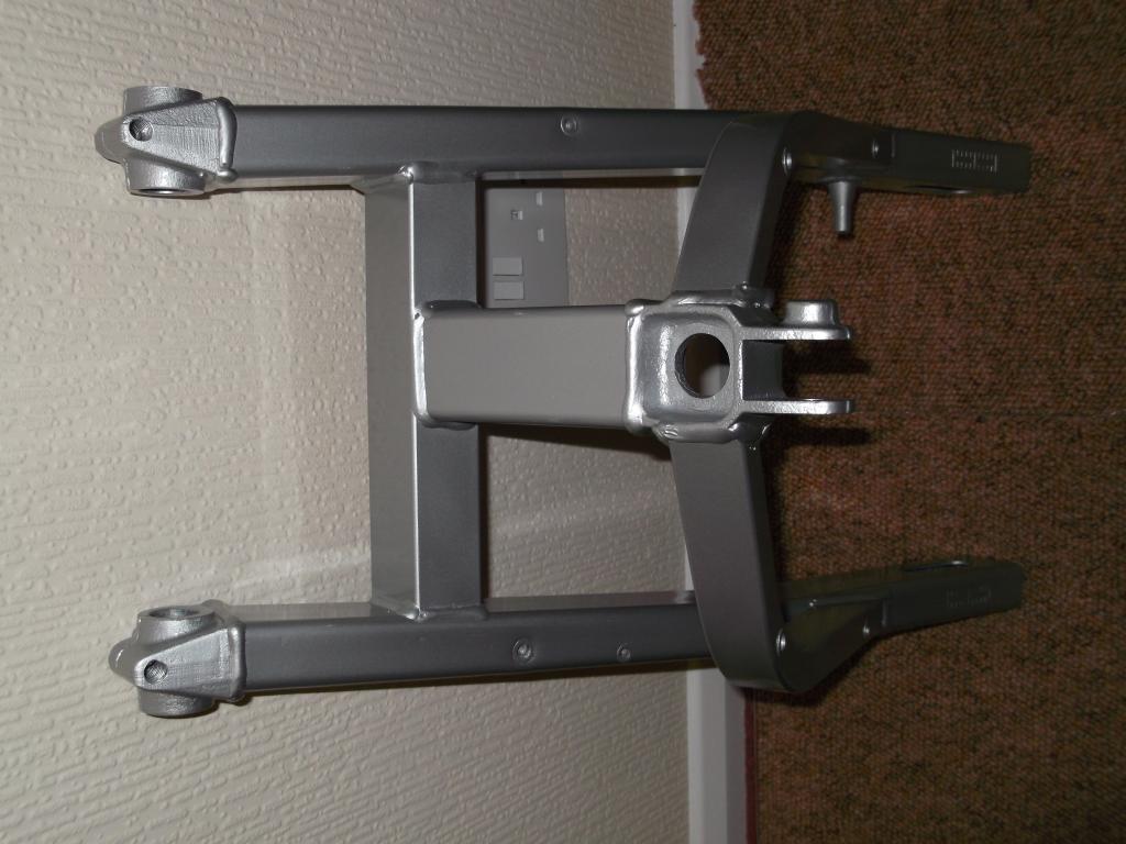

    Both barrels, cleaned and repainted, have lightly honed as were very very polished.
    Swing arm all ready and looking good.

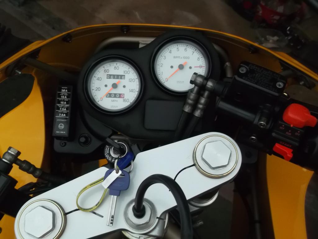

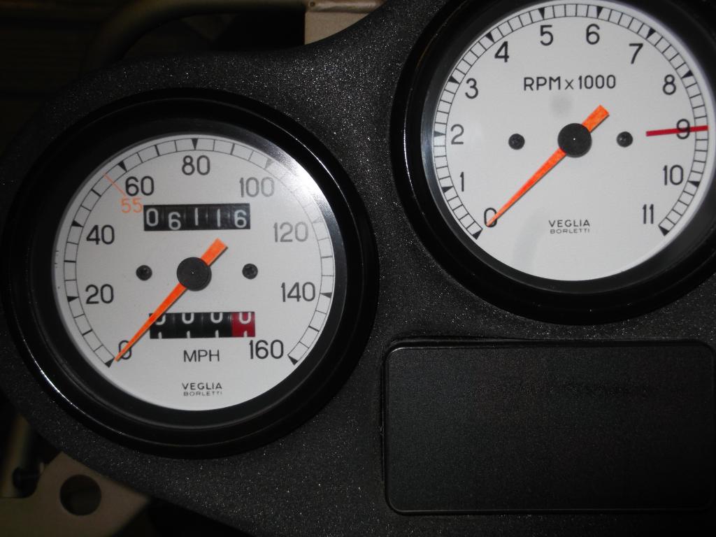

    All the MOT's to back up the low miles. Speedo has a red line marking at 55mph.
    Noticed on another thread that this seems to be something the last models may
    have had? Mine is on a T plate registered 1999 but have been informed built 1997.
    I have found a good used tank, and the original rusted tank put away for another
    day if needed. Hoping to get up and running for a ride out on the 6th October.

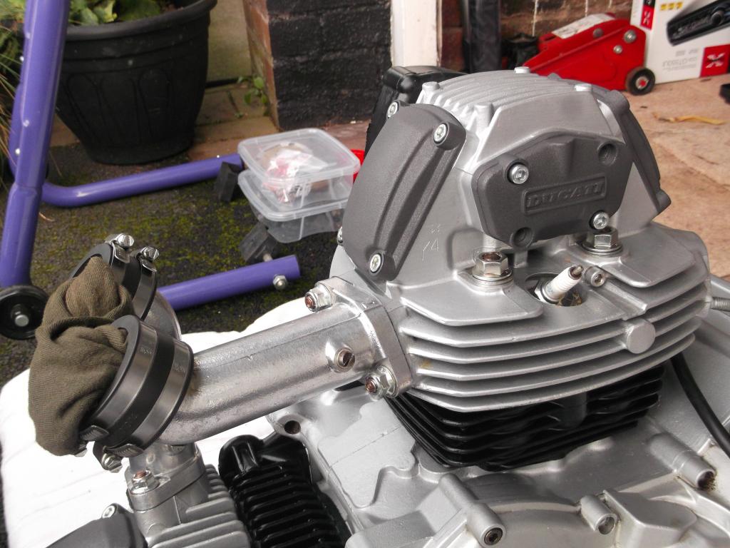

  8. More progress -had a couple of days off work, yesterday with the good lady shopping !! And today working on the bike.
    Lots done, but lots to do by the end of next week!

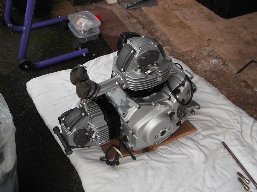

    Engine pretty much done - all back together and only the side casing left to paint.
    Will wait till back in the frame first though. Piston rings were a pain to get in but
    all good in the end. (Fingers crossed).
    A few more of the engine.

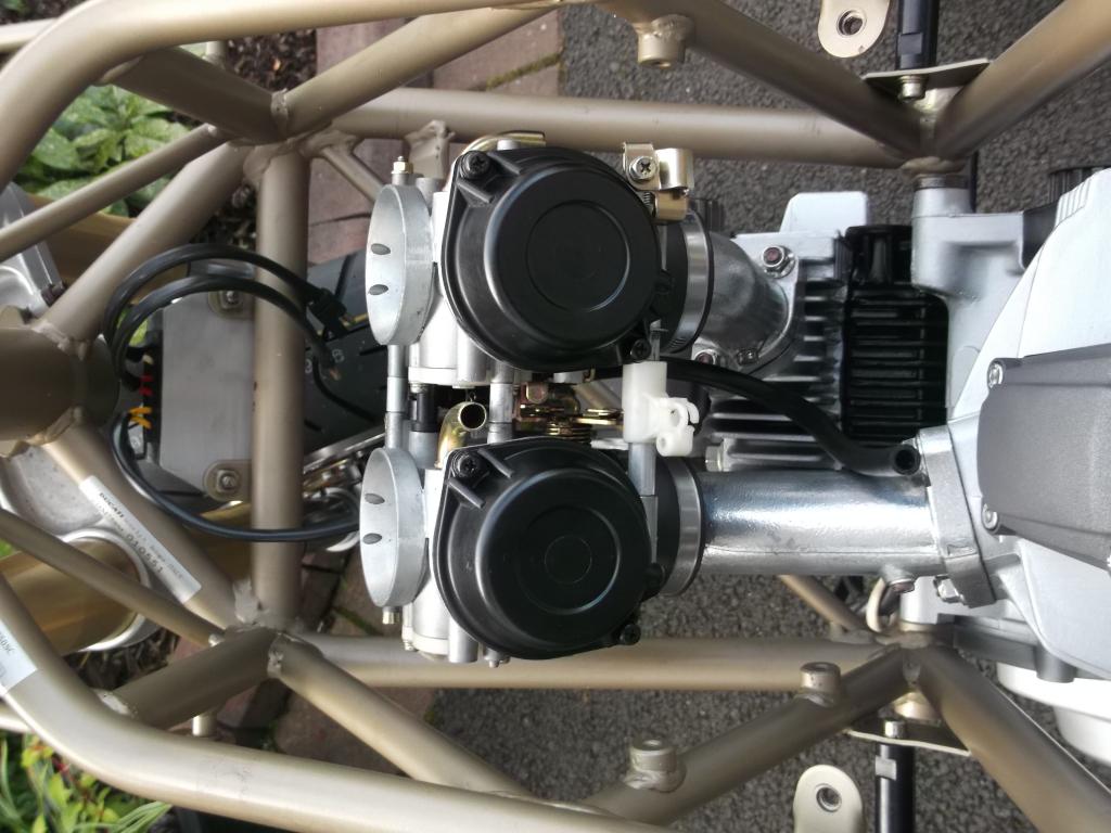

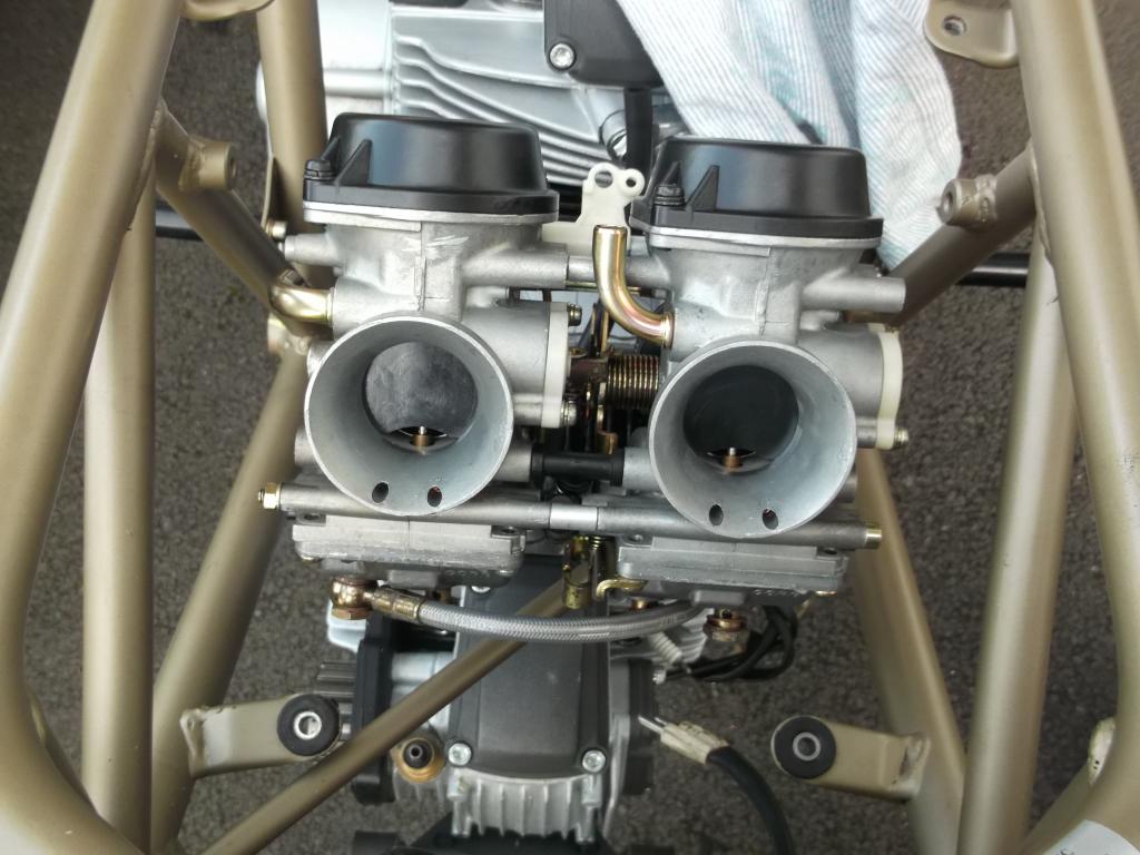

    Carbs have been completely stripped - were full of orange rust settlement. Have washed
    them out at work and blown through with compressed air - carb cleaner and then all done
    again. everything seemed to be clear so should be OK. Does anyone know what the pilot
    screw setting should be? as they were both different when I checked before taking them
    out?

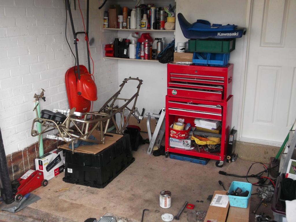

    Frame waiting for the work to start in my tiny garage.

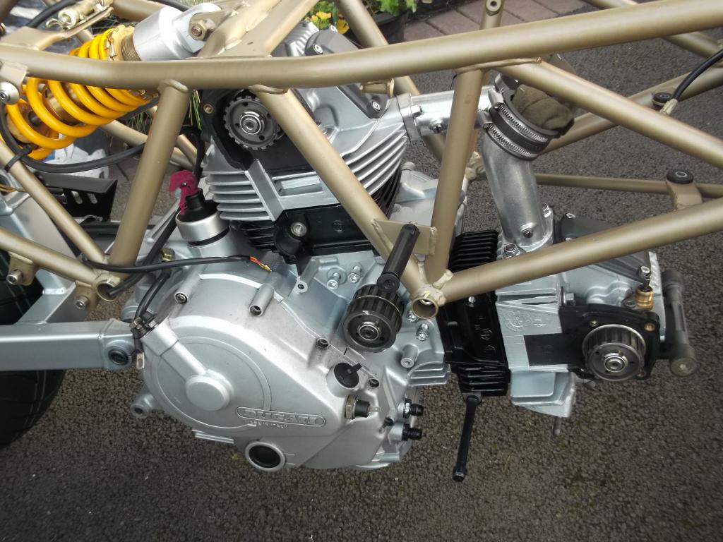

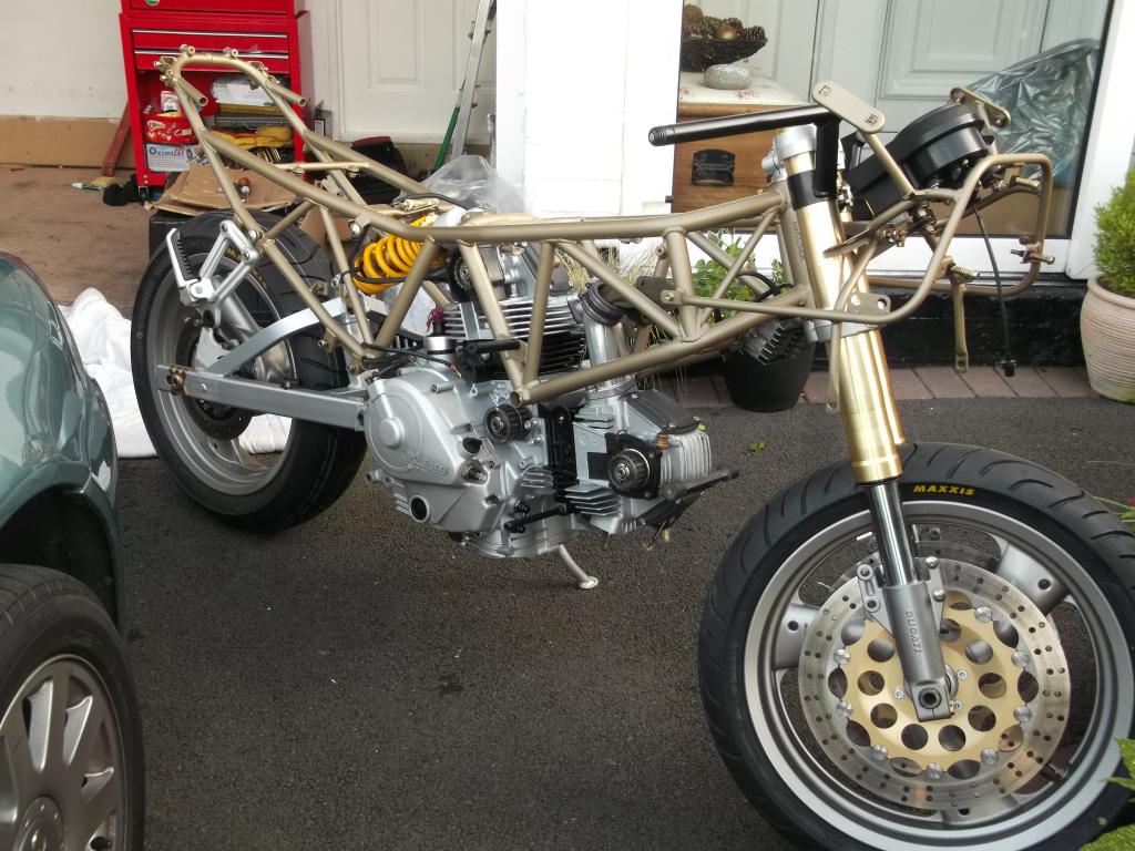

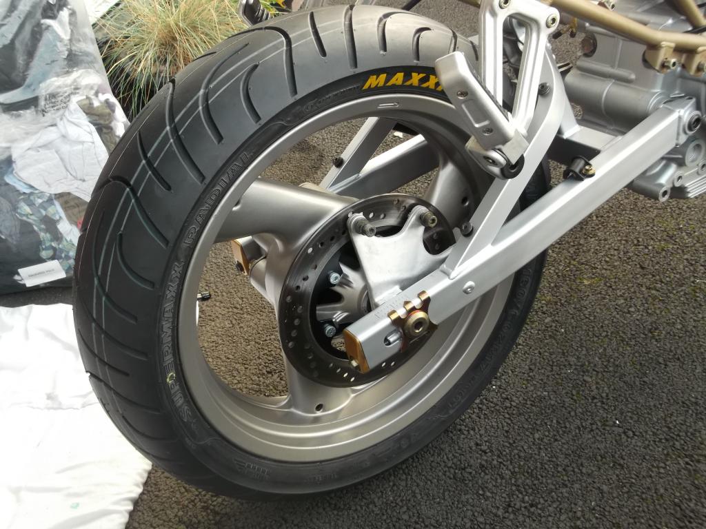

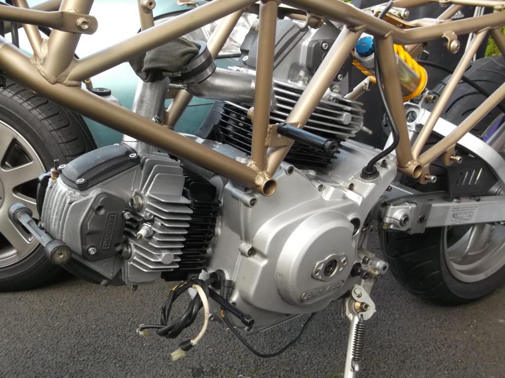

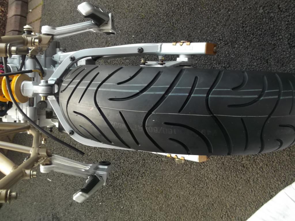

    Engine in, forks, swingarm and finally back on the wheels :smile:

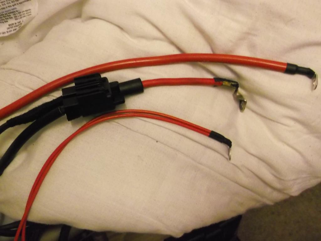

    Next for the wiring, have taken the advice on here and will be upgrading
    the battery and starter wires, got a set from a guy on ebay after
    measuring the existing ones, came to £17.50 all in delivered. Only got a
    photo of the red leads at the moment but have the other three as well
    look pretty good. Will let you know how I get on fitting them. Does
    anyone have any photo's of the wiring routing as my computer with all
    the strip down photo's has died?

  9. I found my pilot screws to be two turns out from 'closed'.

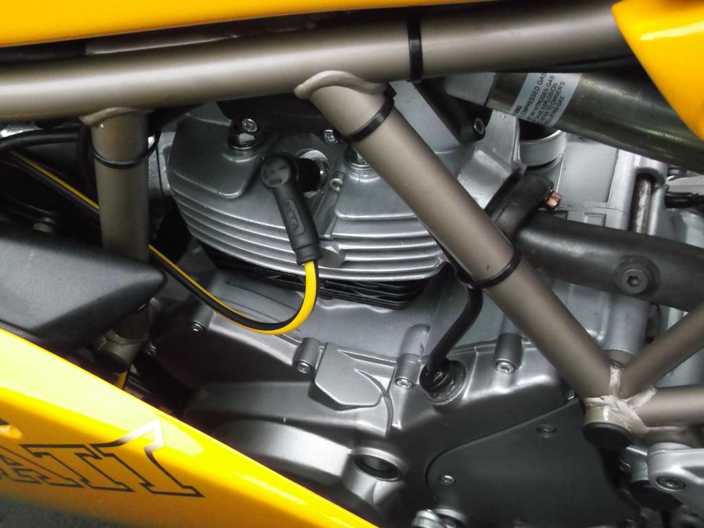

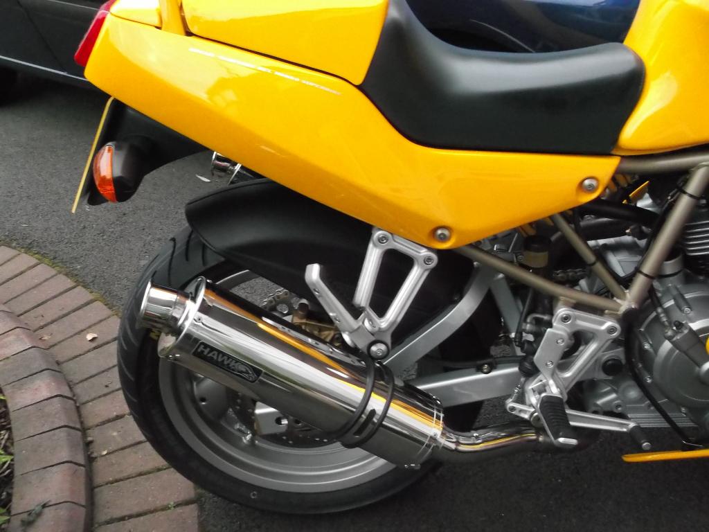

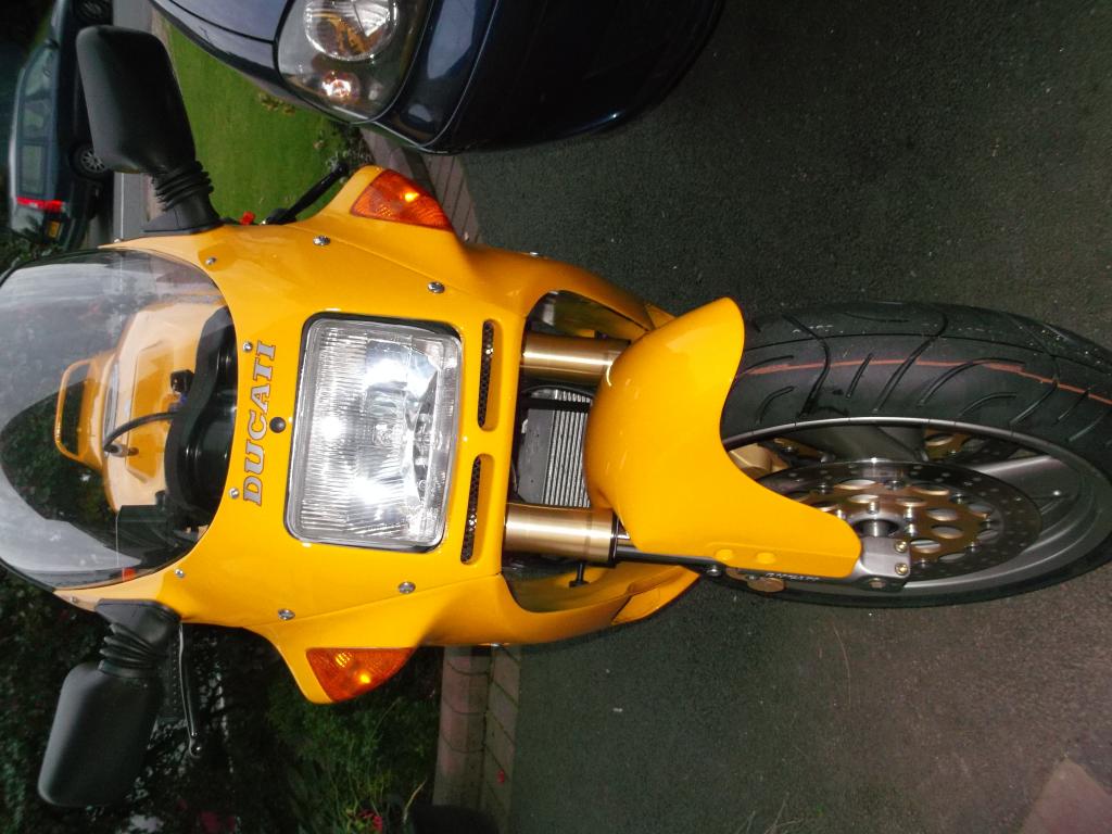

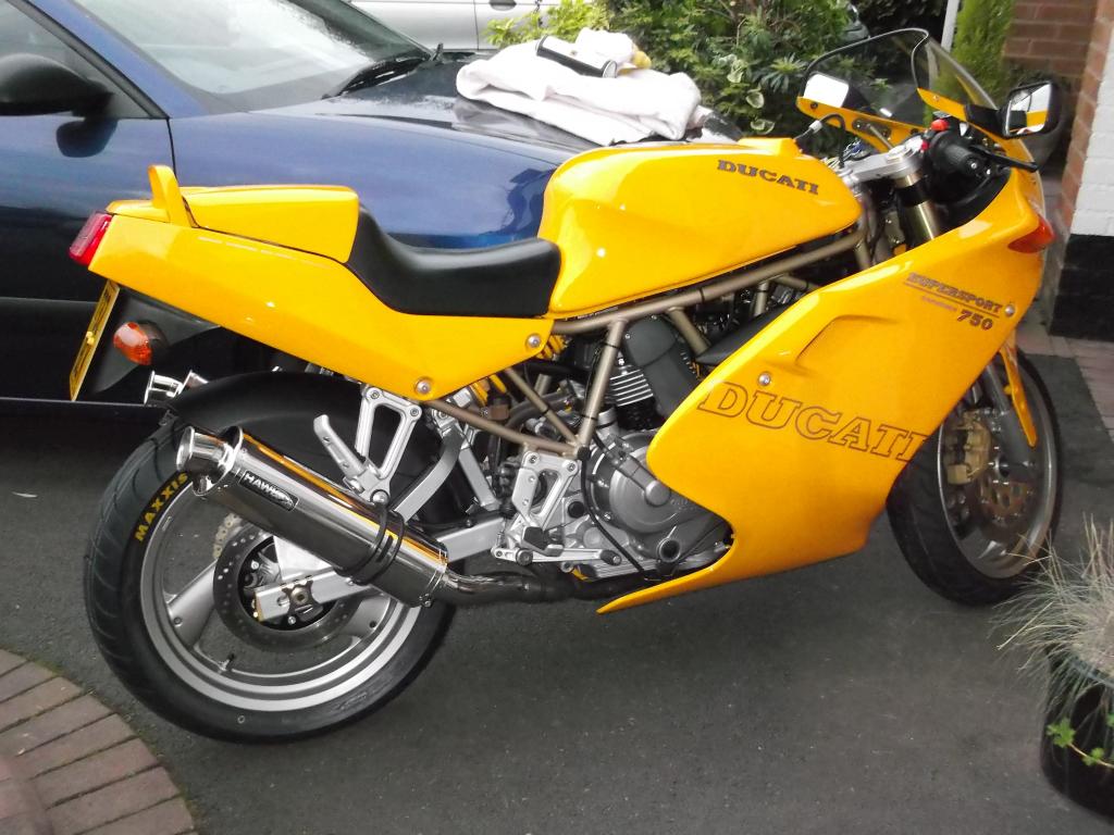

  12. All back together and fired up within seconds BUT only on one cylinder:frown:
    Plugs out and the front cylinder no spark! Swapped the plugs still no spark.
    Swapped the CDI boxes spark on the front now but nothing on the rear.
    Had the same fault on the 900 I used to have. So CDI ordered and hopefully
    that will sort it. Can't wait to get out and have a go, driving me mad!!

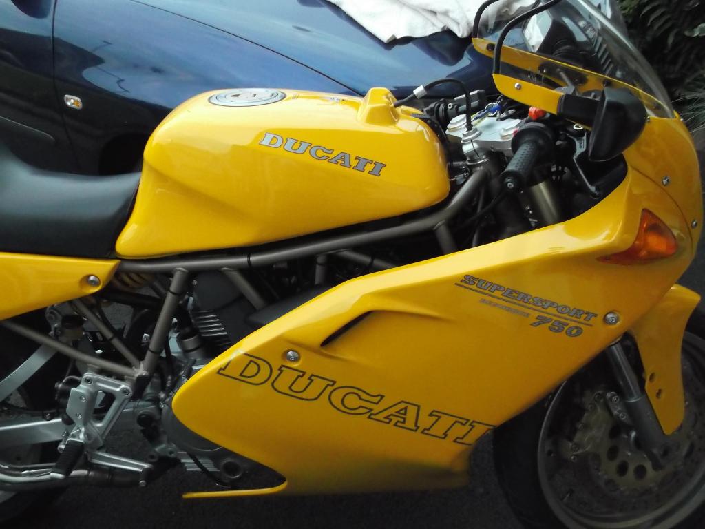

    Did think about painting her red but the yellow looks pretty good and was the original colour.
