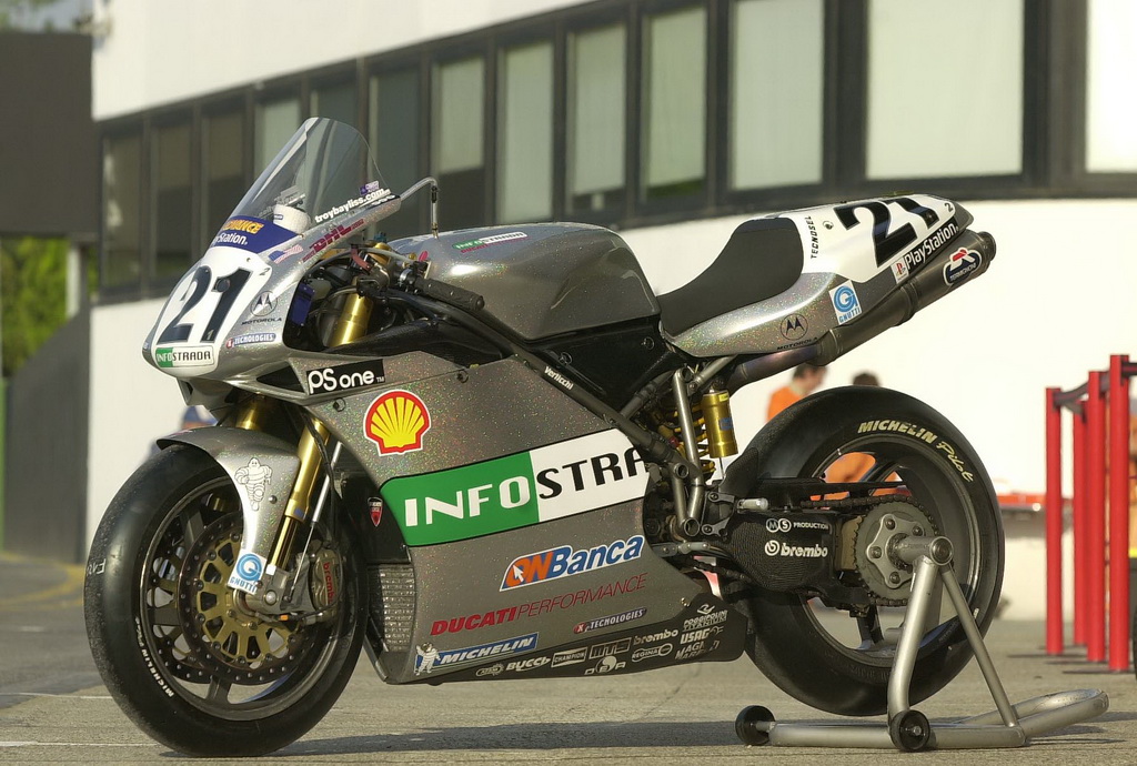

    Whilst Koen went retro looking I am going to go the other way. I have two ideas buzzing around at the moment but these are only ideas - when I get back from Iraq in January I have made arrangements to meet designer/painter. Again, it's funny how things stick with you - I remember Alan Cathcart writing an article on Troy Bayliss race bike with the Imola 200 paint scheme - just blown away by the bike and the pics (wish I kept the magazine) and so one idea is to use the base colour with some new design. The other is based on my liking of the motogp bike but it is not right. Deciding is going to be tough as I am a Ducati Red man but I am erring towards an Imola special as long as I can get the paint code:
  9. I'm liking the bottom pic :upyeah:
  10. Imola job could be interesting, 2nd picture looks like a Chinese fairing job

  13. i love that INFOSTRADA scheme... :)
  14. It's got to be the Imola paint scheme.
  15. Well, I been thinking a lot about this one for sure and tend to agree. I need to get the paint code though as its a complicated mix cause there are flecks or purple in it - in the flesh its simply awesome. Just need to find the right artist to come up with something modern!
