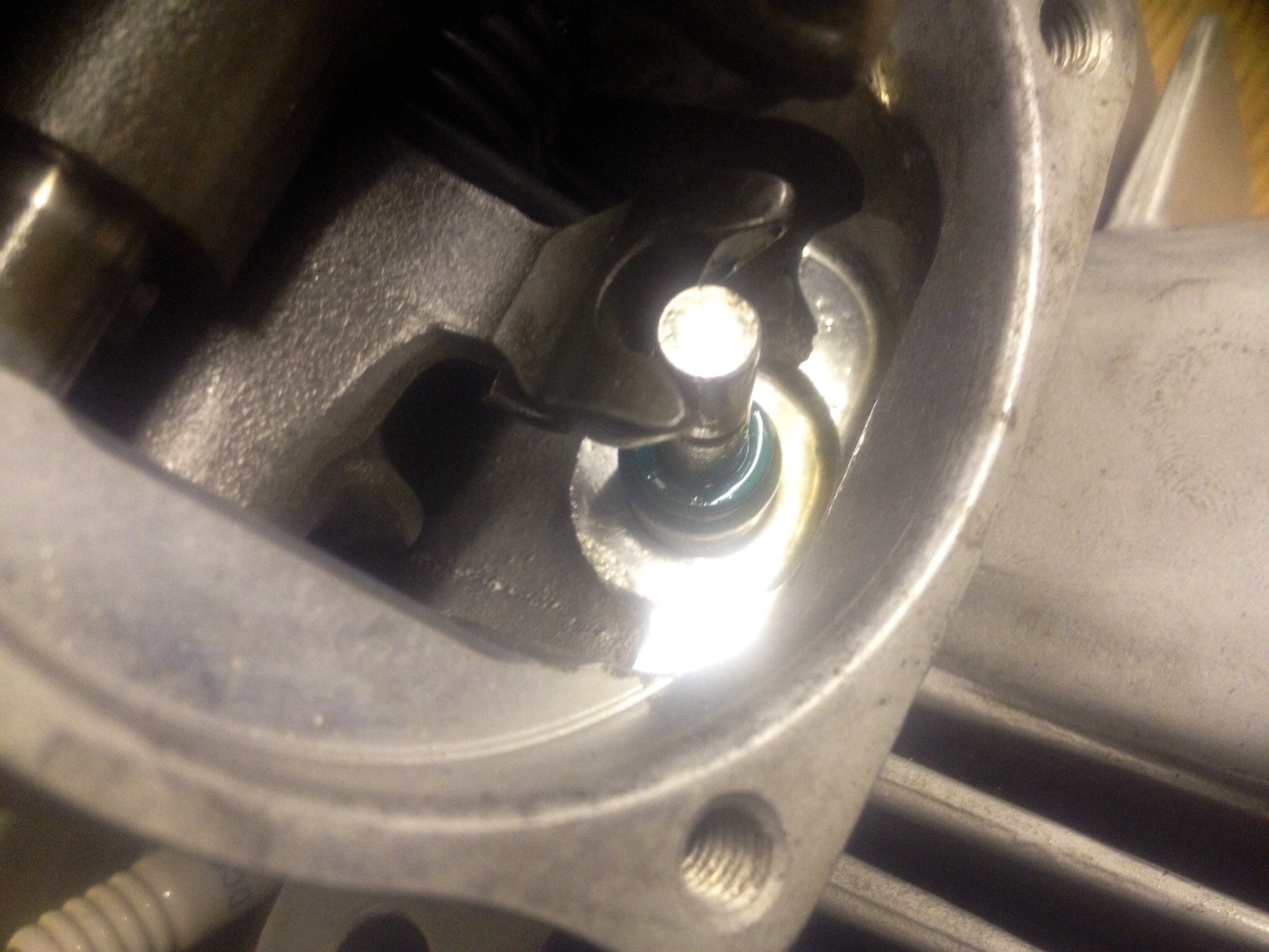

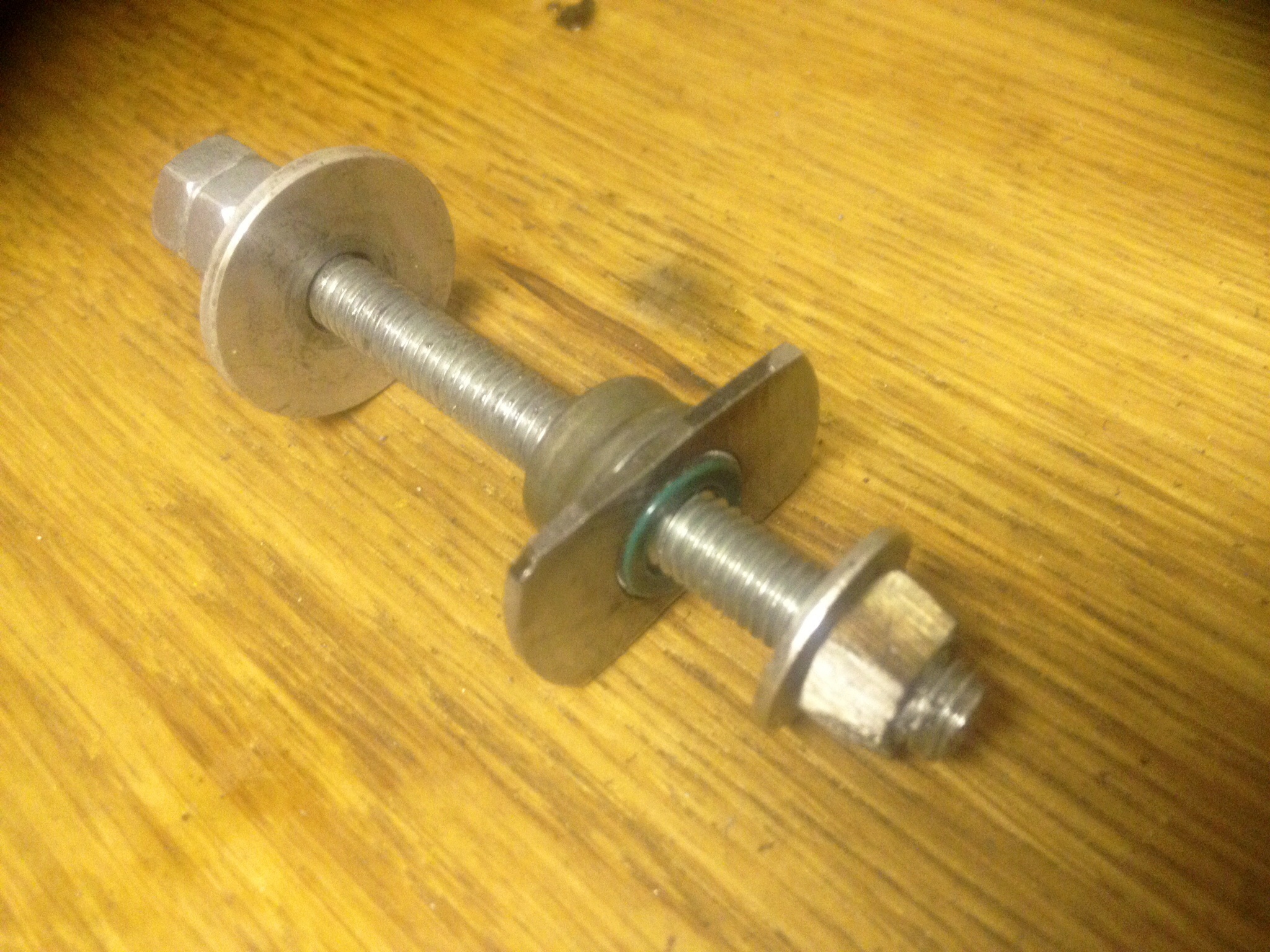

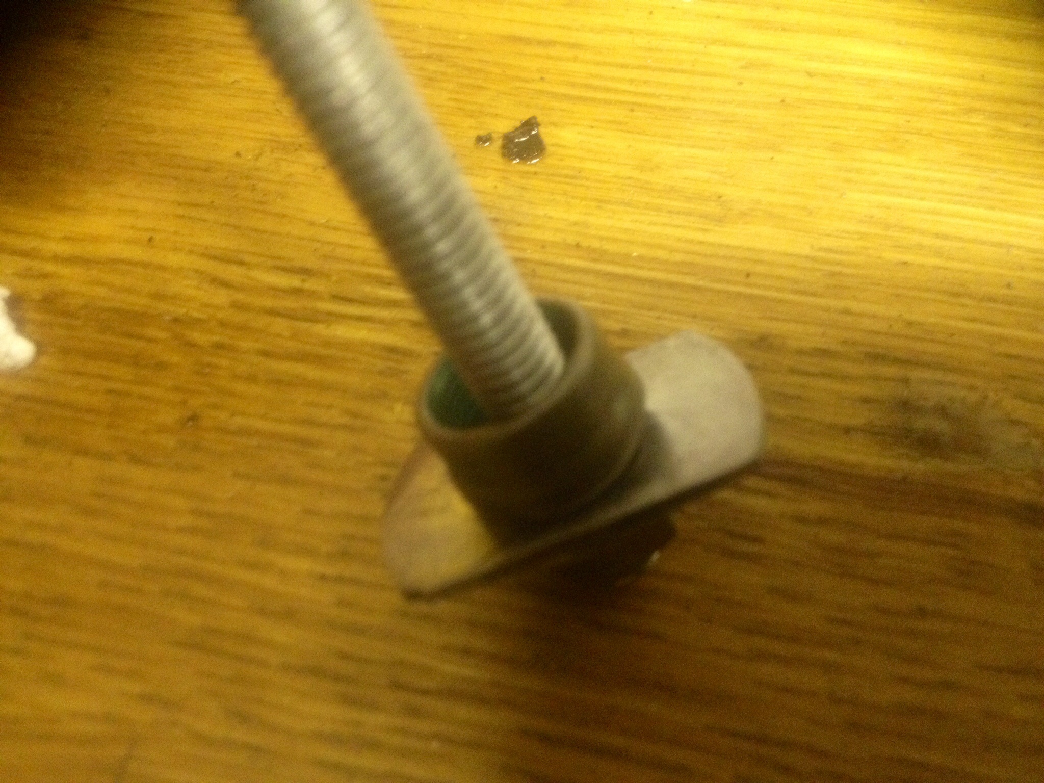

  1. image.jpg After the success of my DIY sand blasting box ( I'm now sponsored by B&Q ) Ive moved to soda blasting to get that really smooth satin finish.. I personally push tissue into all the orifaces and then put masking tape over the top.. The soda is very cheap, and not too aggressive.. Pictures below along with my ( thanks to a forum post) home made valve seal puller..
    On my 796 I cannot get a deep socket square over the seal which would cause damage.. So I bored and filed out a flat washer to fit just over the rubber but not over the collar.. Worked a treat..

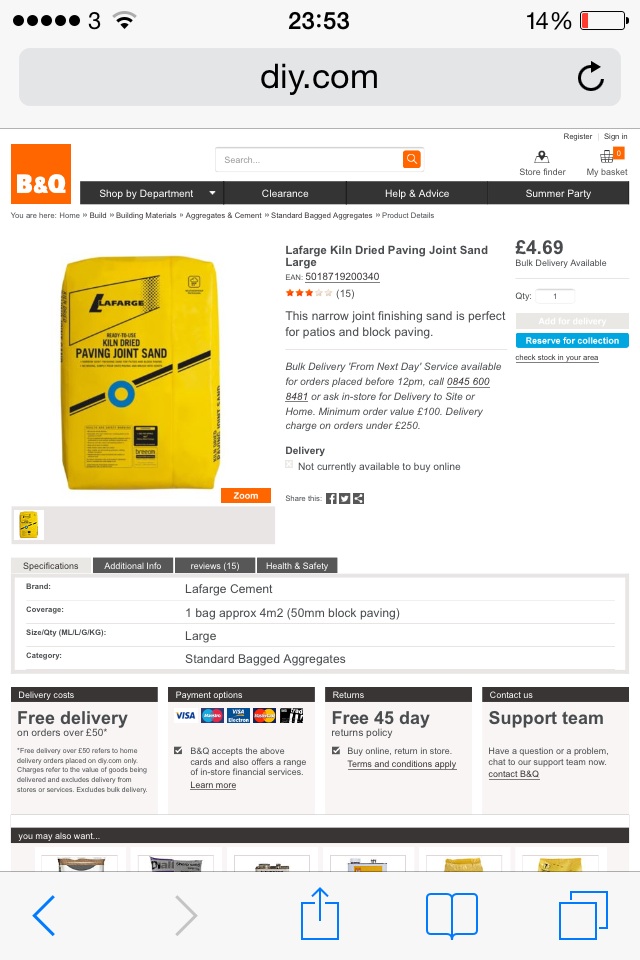

    If I sand blast, or grit... I use Kiln dried sand its so much better than the grit supplied by machine mart etc for £23 a tub... You get twice the sand in a bag, it's ten times better and it cost £04.69 a bag! image.jpg

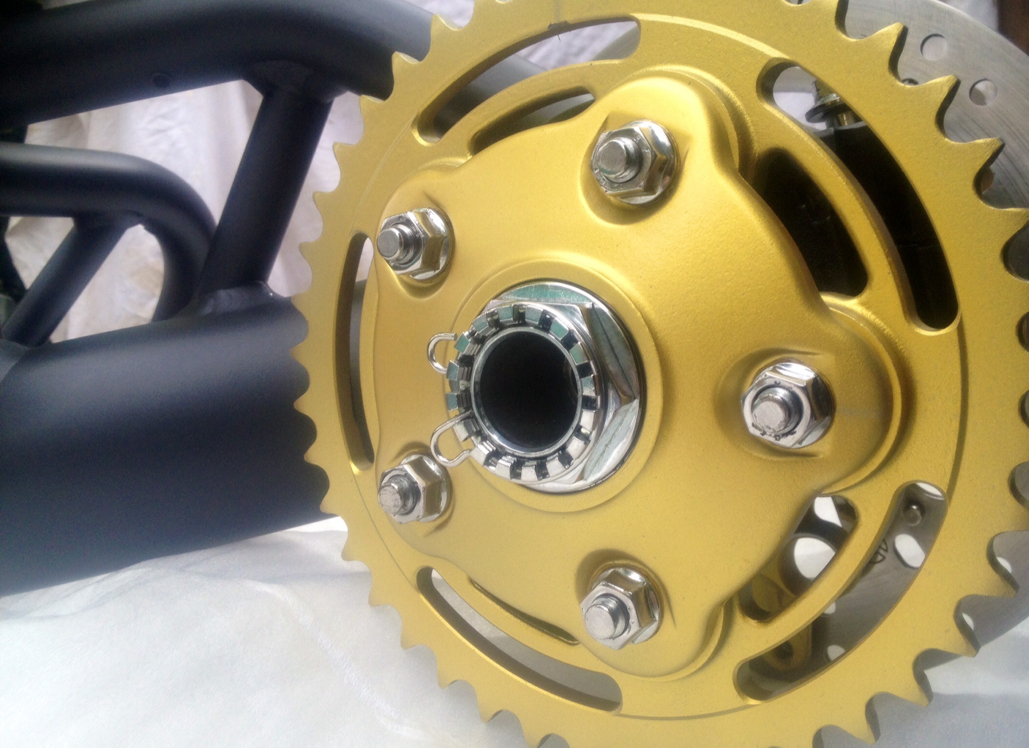

  11. image.jpg Original hub, sprocket and s arm above, all finished by DIY soda blasting.. Mix it with water and it's... Vapour blasting... Studs nut etc, blasted and then polished via mops on bench grinder... Again... The N@@DS way!
    I run my compressor at around 70 psi.. It works great, afterwards I attach my parafin gun and give it a real good clean out with machine mart engine/ parts cleanser, very cheap... I then soak it overnight in the same substance before drying it off with airline and then a final dry off with a clean micro fibre cloth.. Lastly a heat proof lacquer.. 24 hrs later..
    By the way when I grit or soda blast and recycle the materials .. I collect it up I and put it through a fine flour sieve or, a pair of lady's tights.. Not while she's wearing them though! Just removes any rubbish from the material..
    Took the parts to a well known company who restore italian machines to the very highest of standards... Was told, " that's exceptional" they couldn't believe I'd done it myself...

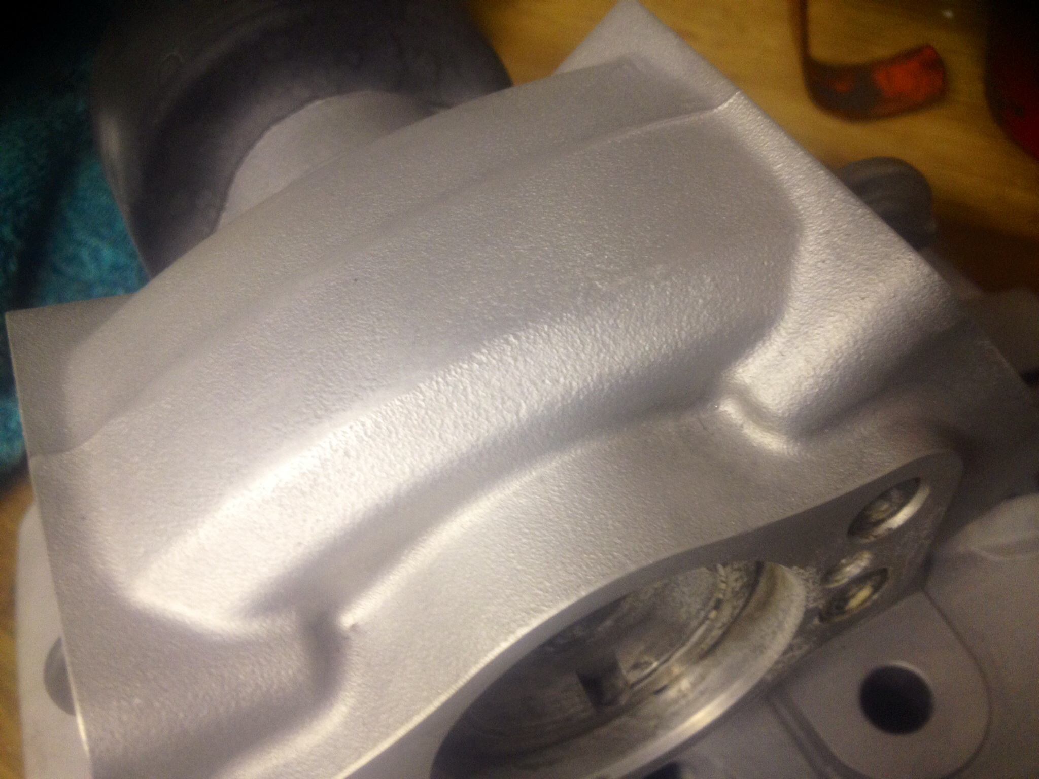

  14. If you want the slightly imprinted finish the yes.. Seal off any areas where sand or grit could damage bearings etc.. I force tissue paper in any holes and seal with masking tape.. Then blast as per soda but with grit or as I use kiln dried sand from B&Q .. Gives a lovely finish which if you wish too you can soda blast afterwards.. If need be flush out part with parts washer or parafin ... image.jpg
  15. Thanks. We are more concerned about a pure colour that is not stained than the texture. So you say really you need to do sand first?

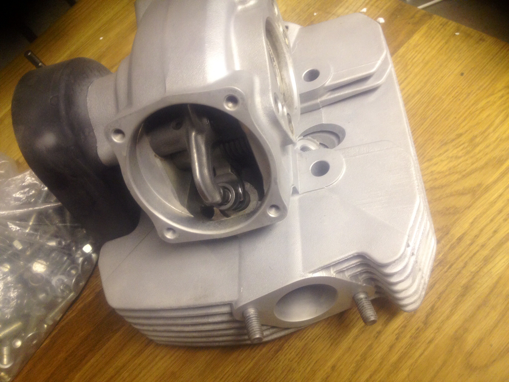

    These are who mine came out..
