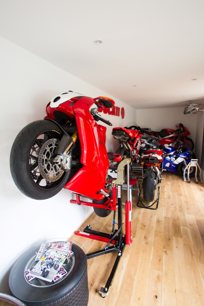

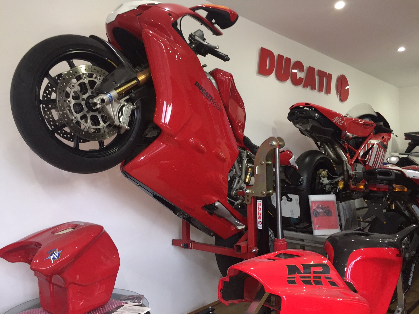

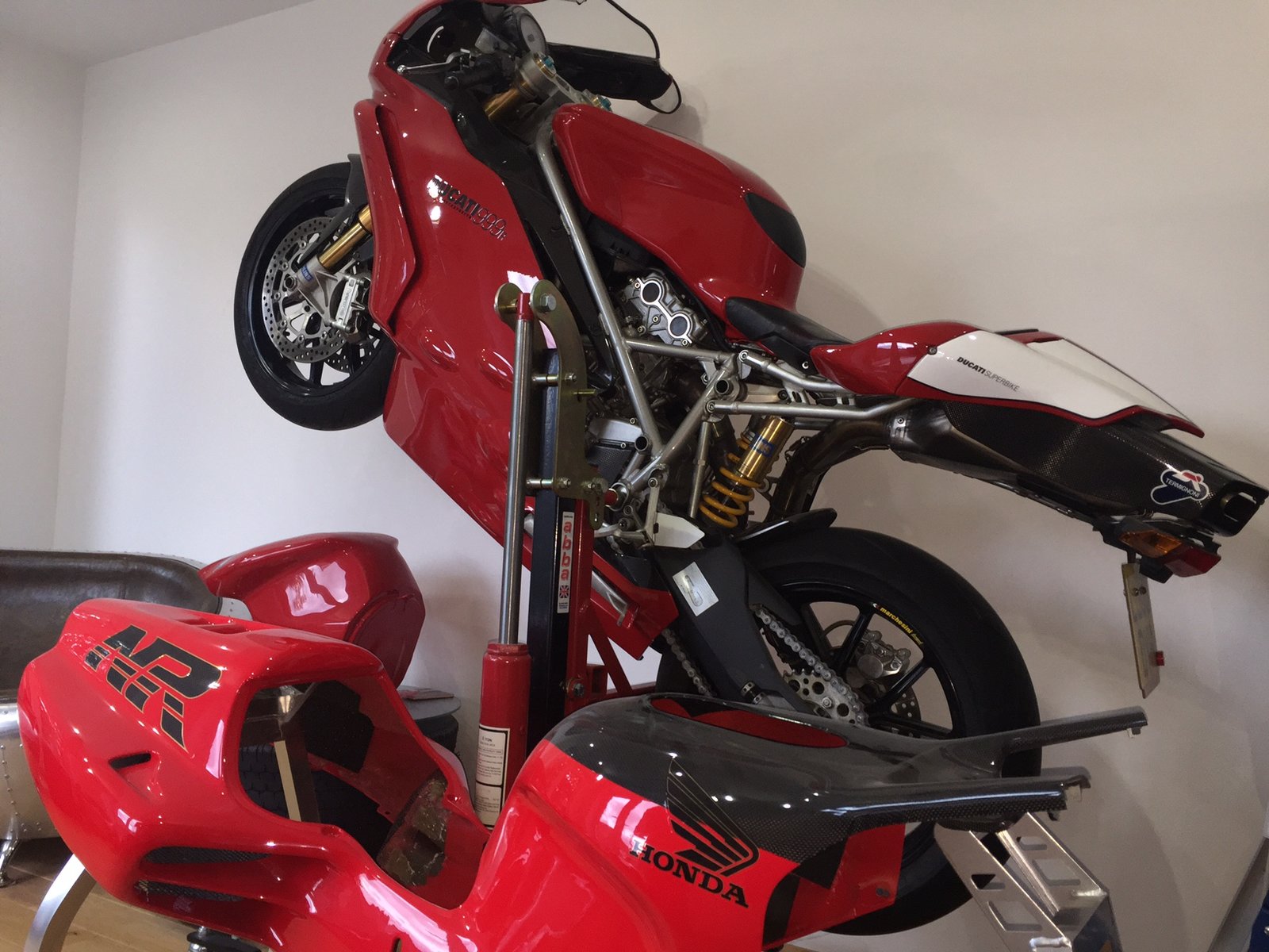

  16. Like this?

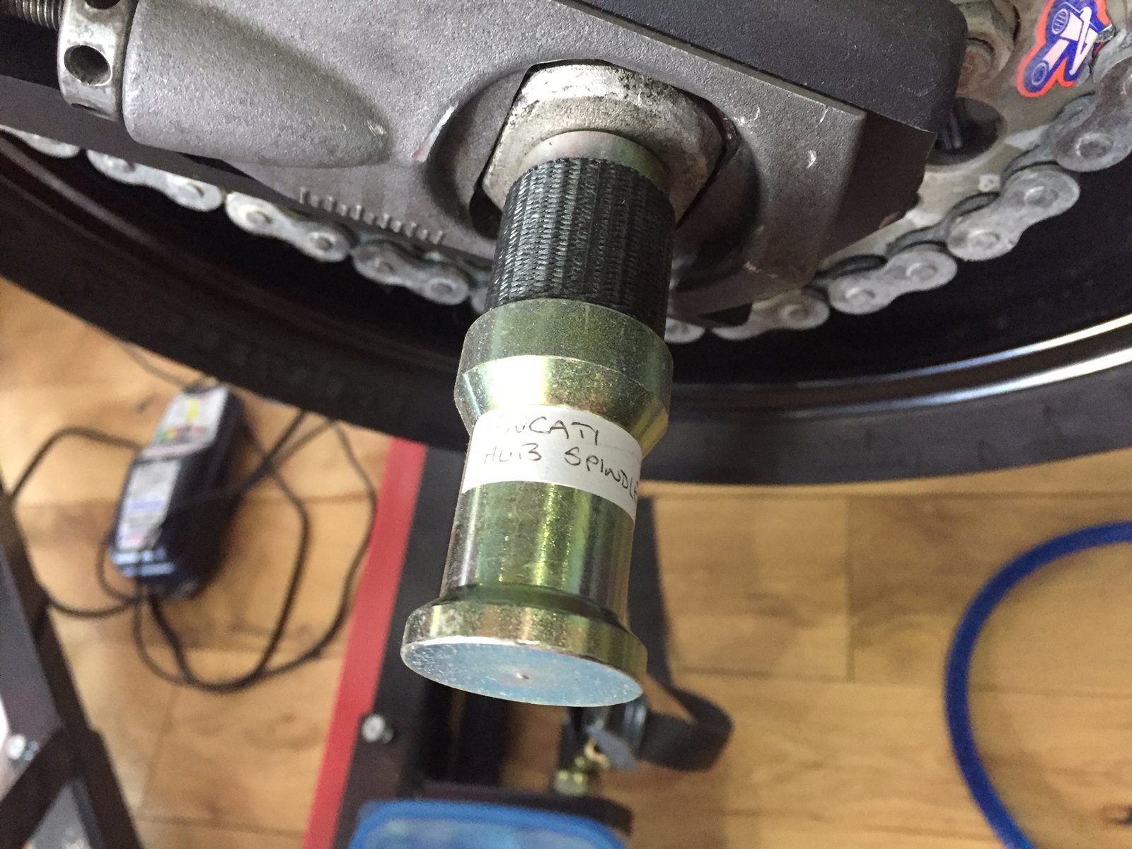

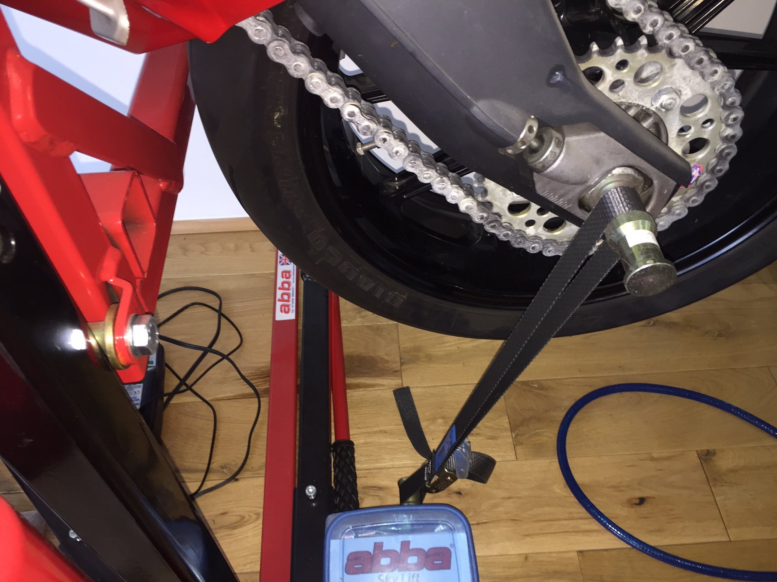

  17. I know - I was teasing :innocent:
    I got a big chunky turned shaft with the kit - fits in the hollow axle a treat and far more secure than a bobbin fitment too:
