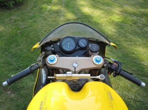

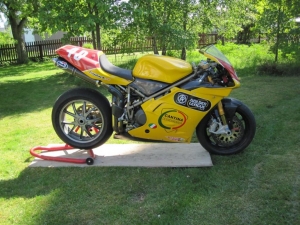

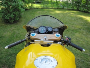

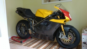

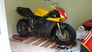

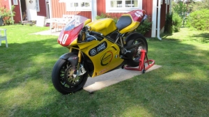

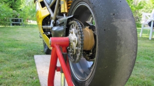

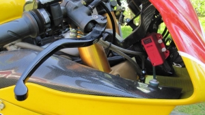

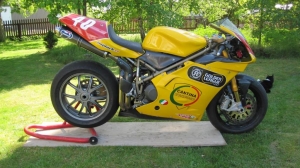

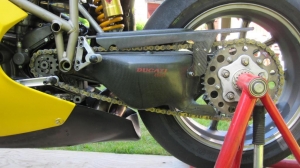

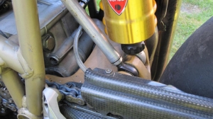

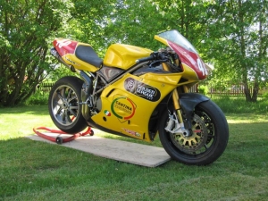

My trackbike project with some RS parts on it.<br /> Mag swingarm F99, widetrack yokes F99.<br /> Mag wheels from BSB and AMA 6x16.5, 3.5x16.5.<br /> Front forks + calipers from a 999R, to be changed to my 46mm SBK forks - Ohlins FG8760 (currently mounted on my 996 SPS).<br /> Lightned and balanced crank, lighter flywheel, Pankl Ti conrods, Pistal HC pistons, 31-37 valves, 431/G cams, Termignoni 54mm complete system, slipper clutch, carbon blowbox etc.

pattebanan

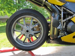

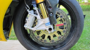

    Where did you source your ohlins from mTe? Also the race bodywork?
    Looks stunning by the way..
