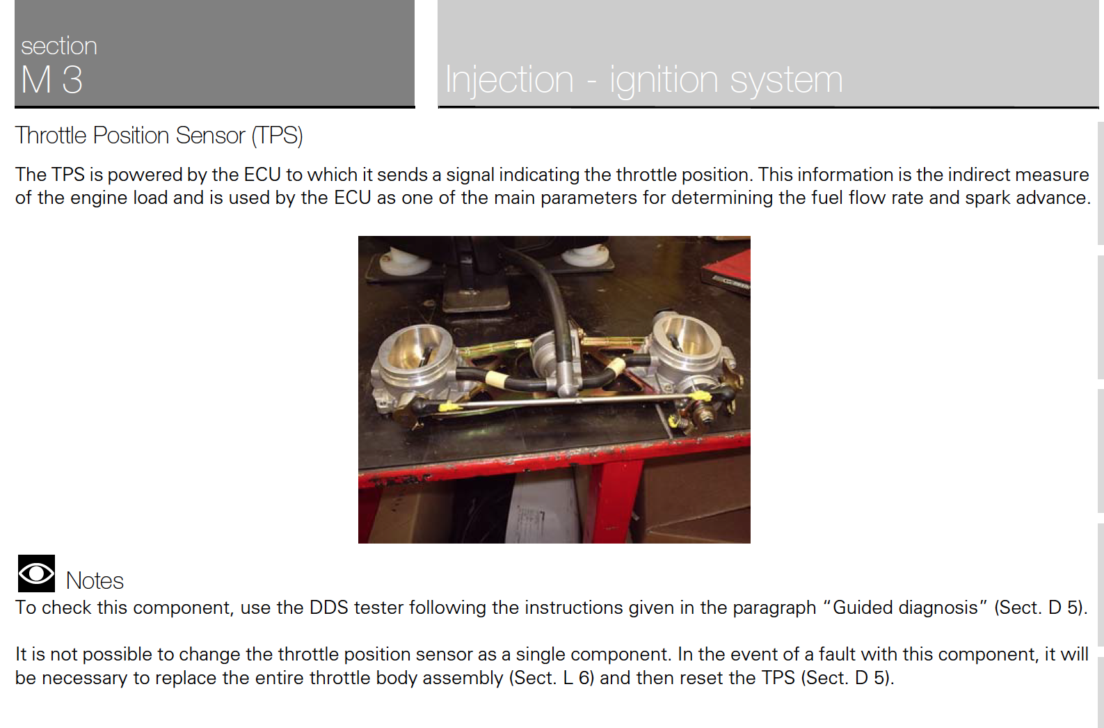

  4. If the bike runs when you hold the throttle open and the revs are spiking with a static throttle position, I'd be inclined to check the Throttle Position Sensor.

  7. Thank you, that's great. If I can find it I will. Where abouts is it? I'm guessing 'underneath everything, totally inaccessible, surrounded by razor sharp red hot spikes'?
    Given that I've no idea how to check it, how do I do that or should I just buy a new 1098 one and pop it in while I'm ordering plugs and relays?
    Thanks again for your time. I'm grateful.
  8. The TPS is a bit pricey. TBH I'd be going at that toward the end if needed.

  11. Although before you start guessing and spending money, a dealer should be able to plugh the bike into their diagnostic machine and tell you if the TPS is faulty.

    I've also found a TPS for about 40 quid which I may as well order as if I fit it after trying the plugs and reg/ rec and it's not that I can always return it and it's only cost me postage and no patience.
    So, last question for tonight. If I plug the TPS into wherever the hell that lives, will it self calibrate?
