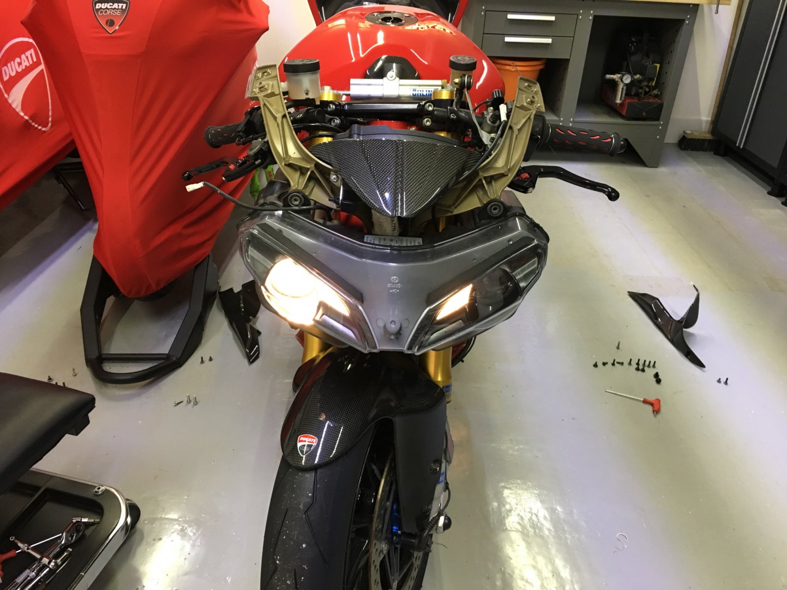

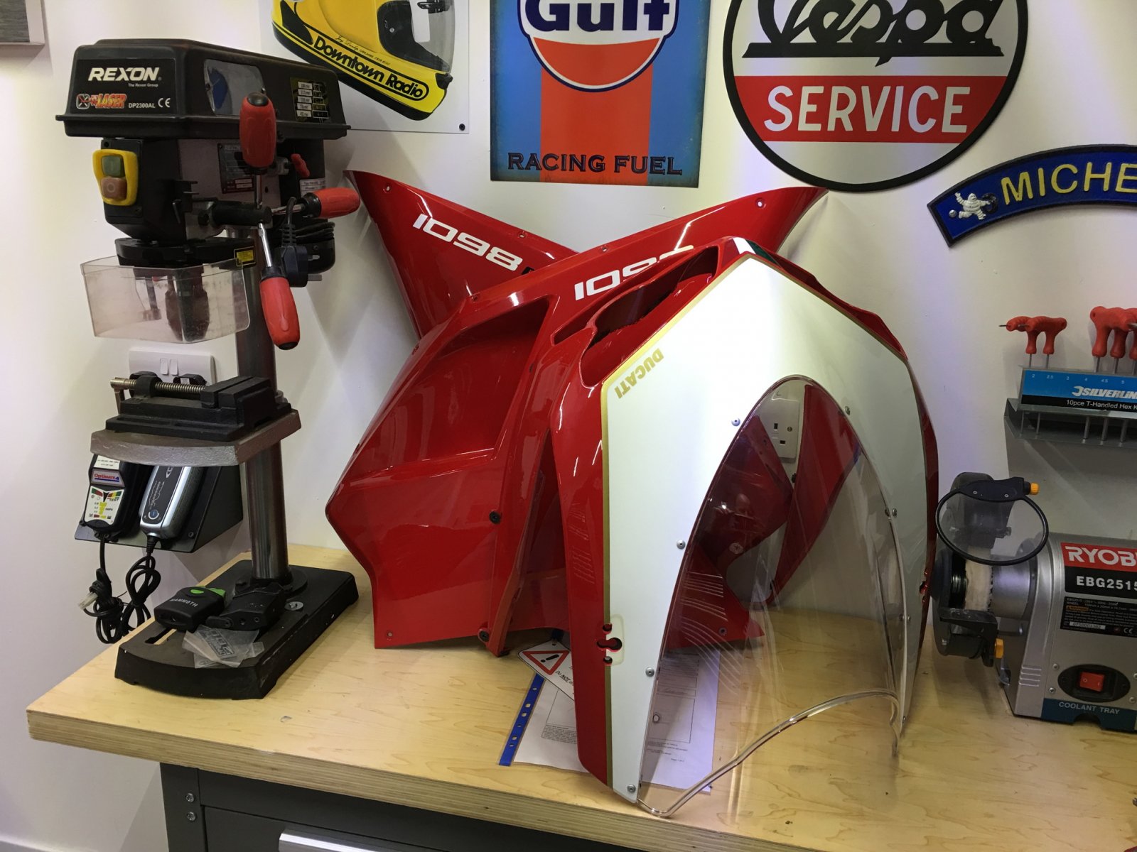

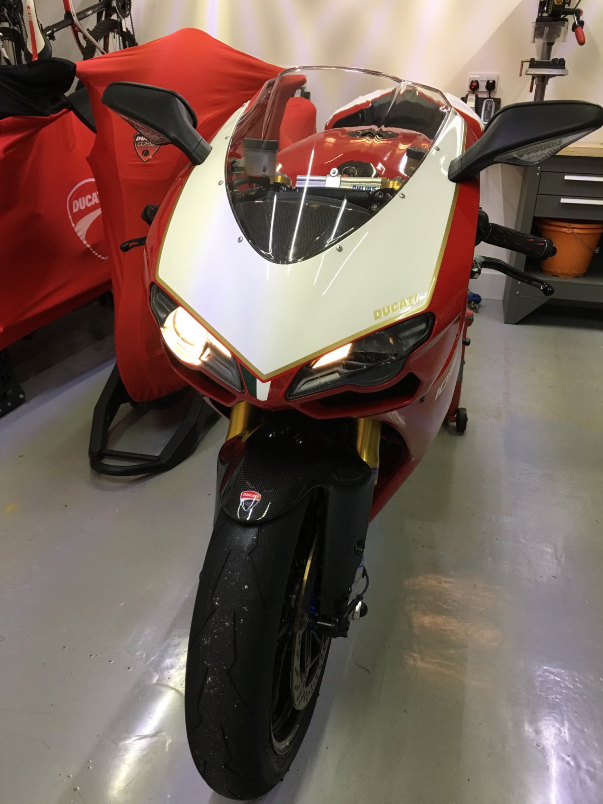

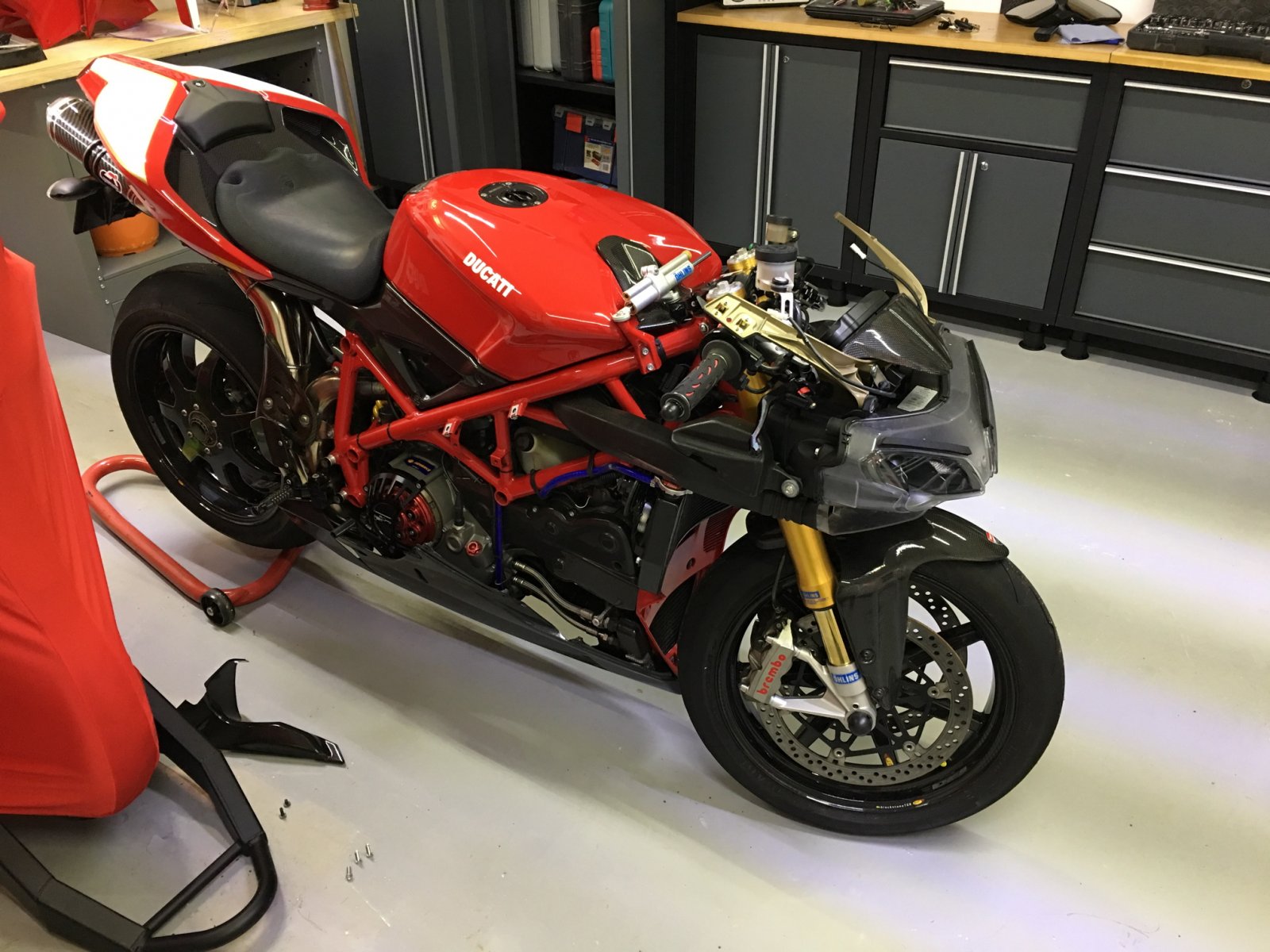

  14. Well, I've been procrastinating for a few days, but had to get in the garage today and sort this headlight as the bike is in for a service and MOT this week. :(
    90 mins later and it's working. :)
    • T'was the headlight relay.
    • 2 min job to replace. 90 min job to remove and refit the fairings and nose cone to get at the blighter. :mad: What a stupid place to site it.
    • It was a brand new relay last year.
    • If it happans again, I'm going to fabricate a bracket to bring the relay around behind the dash so it can be changed without removing bodywork. :upyeah:
