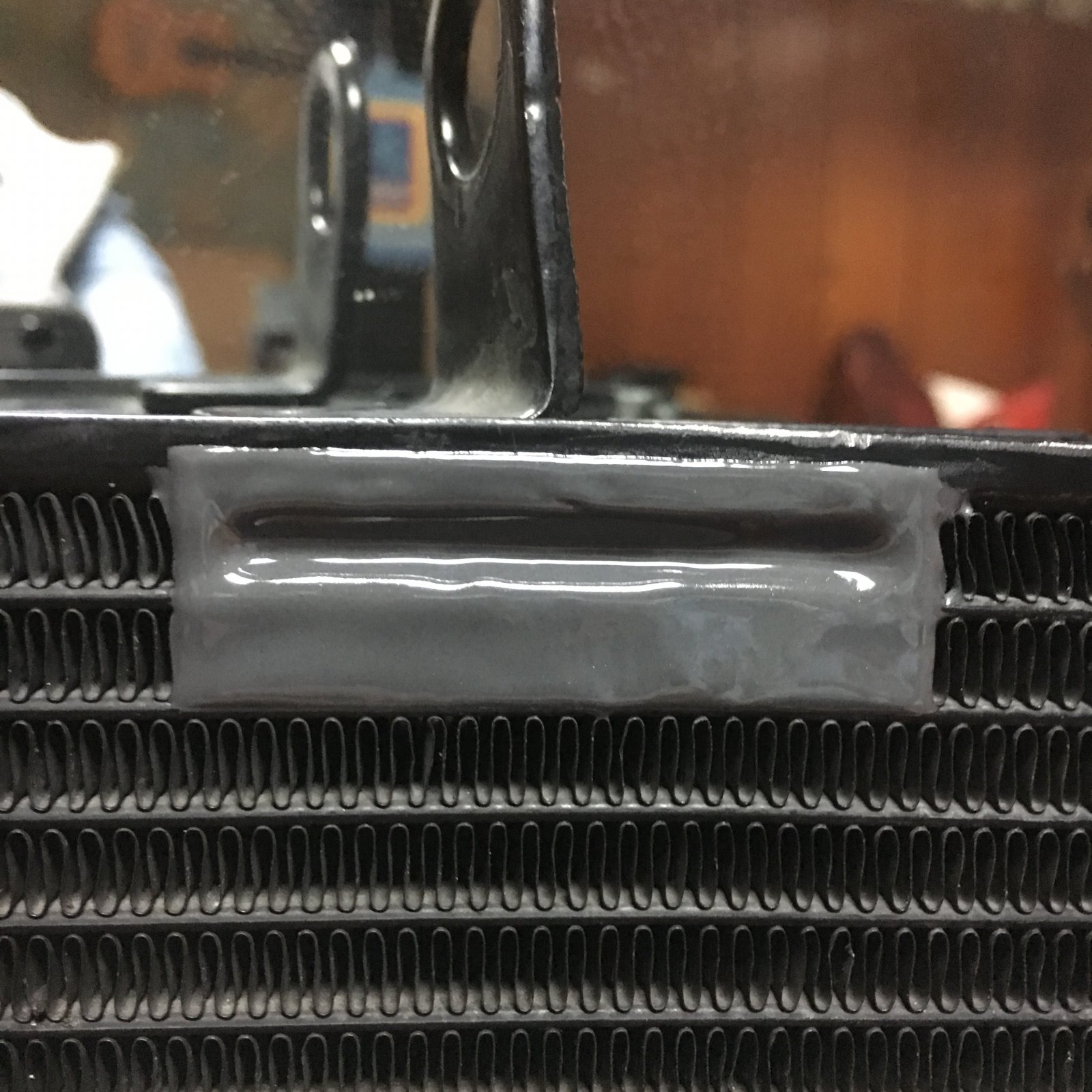

  6. here is my fix :)
    JB WELD 3 layers
