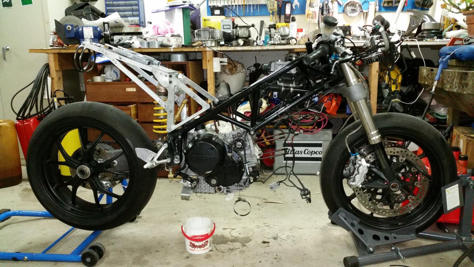

  1. This is my 1100 Demon its a 999 frame 996 svingarm 1098 fork and breaks and a 1100ds with Dp camshafts, light flywheel and heads done .

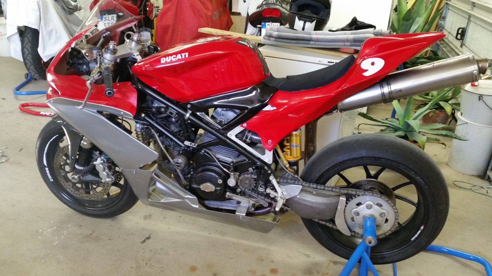

  2. wow love that ...except the tail pipe is sooo long.bet its fun to ride though. what sort of power is it making?
  3. that's lovely. What is the fairing and seat unit choice?
  4. ☺The exhaust is long so the bike wont be to loud. The power is unknown yet
    Seat and fairing is Aprilia Rsv4
  5. would twin pipes work ? bodywork doesn't work for me but I love the idea behind the bike though.

    I was under the impression the swingarm pivot won't line up between the 'ds crankcase and 999 frame lug, did you have to modify or am I completely off target? Subframe mounts look like the Kamna parts? What tail unit have you used?
    Any more pics?
  7. sort the seat unit out, either wrapped around the pipe or the pipe poking thru ala 500 2 stroke and would look great! You had it on the scales yet?
  8. The engine is modified so the 996 swingarm would fit. Subframe is a copy of Kaemna Demon and the tail is homemade and the weight is about 155kg
