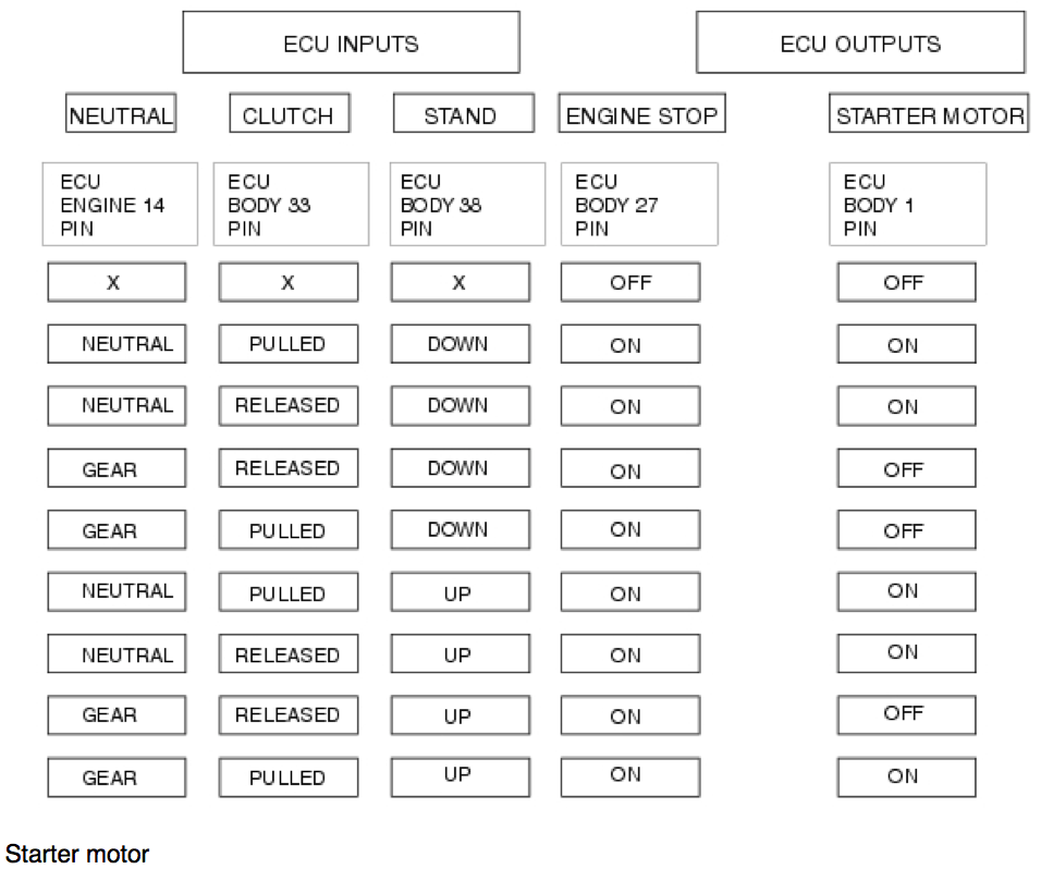

    However... The bike rides OK and idles OK (until it dies!). Doesn't this suggest something electrical? I found this schematic in a post by Shazaam on another Forum - I can see how the clutch microswitch being dicky could lead to the bike not starting in gear with the clutch pulled in, but could it cause the engine to suddenly stop? All a bit confusing (to me).

  15. Sounds intermittent which is the worst type of problem. Side stand switch and clutch switch cleaned and resistance checked should eliminate or confirm one of those as the simplest place to start. Andy
