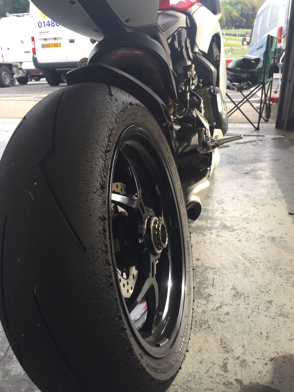

    I have been slowly turning the bike into Track purpose only and although only my second track day yesterday was all ready getting annoyed at having to do warm up laps every session on the Supercorsa SP and no tyre warmers.

  5. Looks like you got the pressure spot on. Someone should be along soon on the tyre warmer issue as I don't know. I use the Racetechs with warmers and for me, they're an awsome tyre. Andy
