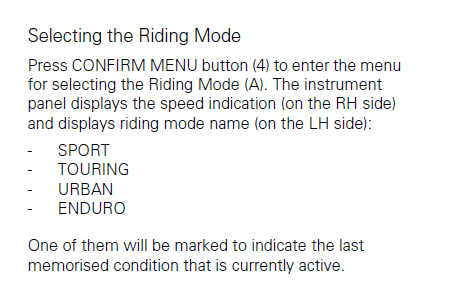

  3. The DVT (UK Model) has 4 riding modes 3 power options and 2 or 3 throttle responce options
    So I suggest you have it set of full power and fast throttle responce in Sport or Touring Mode.
    Then try again - for sure Panniers will add resistance and slow it down.
    We do not get the restricted version - the standard 160 HP version is restricted enough!
    Bike will easily do 150 mph indicated - 240 KPH

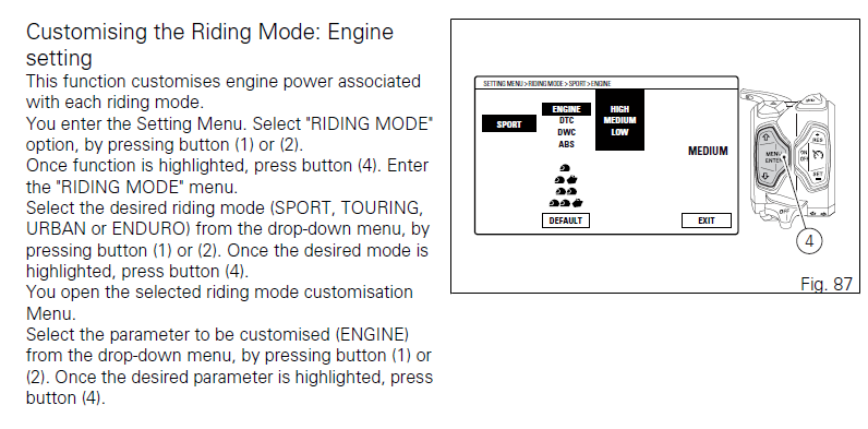

  6. Riding Mode
    Engine Power Setting
    High is 160 BHP - Fast Throttle
    Medium 160 BHP - Slow Throttle
    Low 100 BHP - Slow Throttle
    These can all be set in each of the riding modes - so you can have sport with 100 BHP if you want
    or Urban with 160 BHP and Fast Throttle

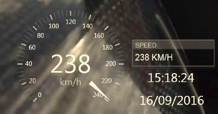

  15. Exactly. This is a pre-DVT 1200 engine at Silverstone International, the speed is recorded with a 10Hz GPS so will be a lot more accurate than a usual GPS device, this was far from the top speed possible and was just before braking for a corner:
