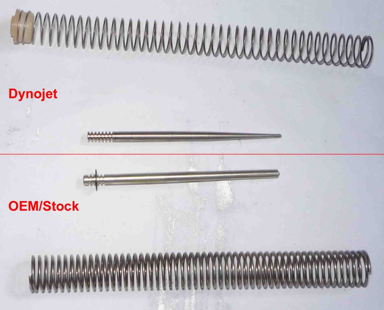

  4. Post a pic of the needle and spring - I have seen several instances of where someone has fitted Dynojet needles (no markings - but identifiable from the shape) but not bothered to change the OEM main jets, simply because it was easier to do.
    As Derek says, the emulsion tube is Y6 but the OP says his jets are too small - as yet I don't think he has identified the main jet 132.5. If it has no markings, it isn't OEM and is probably a Dynojet one.

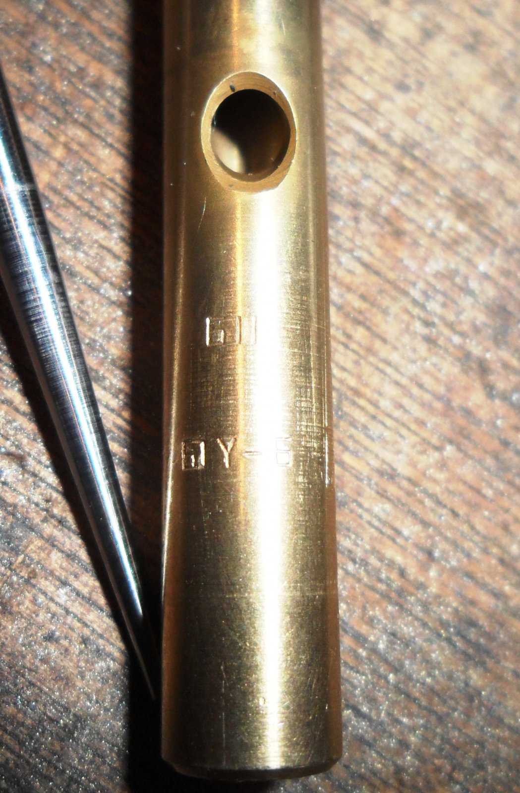

  8. The tube is OEM y6-611 , but like I said the needle is wrong,
    see pic, the holes are fine good ovality
  9. The hole that wears is at the top where the needle slides through. They are usually showing signs of ovality by 15-20,000 miles.

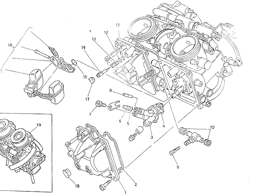

  12. That is the starter jet not the main jet. The main jet is item 6 in this picture, 7 is the starter jet and 8 the pilot jet. Screen Shot 2017-03-18 at 13.50.40.png

  14. ok it looks like 128 printed on the top. I m going to check all this at the main agent in Newcastle on Monday. that's the best diagram I v seen so far.
    I see ur point and the needles it is a dyna needle I have , I did check the floats and valves I replaced them and cleared the system of rust I have the carbs suspended above the manifolds unconnected so I can see the mouth engine side the fuel is coming from the venture not the overflows although they were leaking earlier this bike was stood for nearly 10 years it is the first early Duc I v done(give me Honda quality any day) there was a lot of rust and seizers I have loads time now that I cant work I have a small stool on caster wheels I wiz along the wkshop on and long stick magnets in case I drop anything sounds desperate I know, thanks for your advice it's always welcome we don't all know everything esp me LOL.

  16. the dyna needle it more slender than the oem I compared mine with ur pic it s a very marked difference. I may slash out on a new pair carbs but on a disabled budget its a lot of cash.

  18. The main jet with 128 on it - does it have a little square logo as well?
    If not, it is the larger of the two Dynojet main jets for a Stage 1 kit for your bike. So on the basis of what we have seen so far, you have a Dynojet kit in your carbs (assuming the spring is the lighter of the two shown in my photo above).

    You appear to have a Stage 1 Dynojet kit in those carbs - there is absolutely no point in fitting the OEM needle unless you want to f-up the whole set-up.
