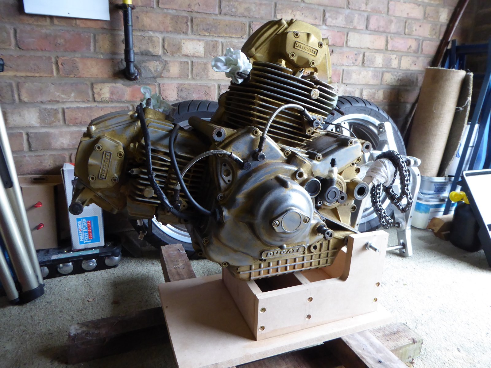

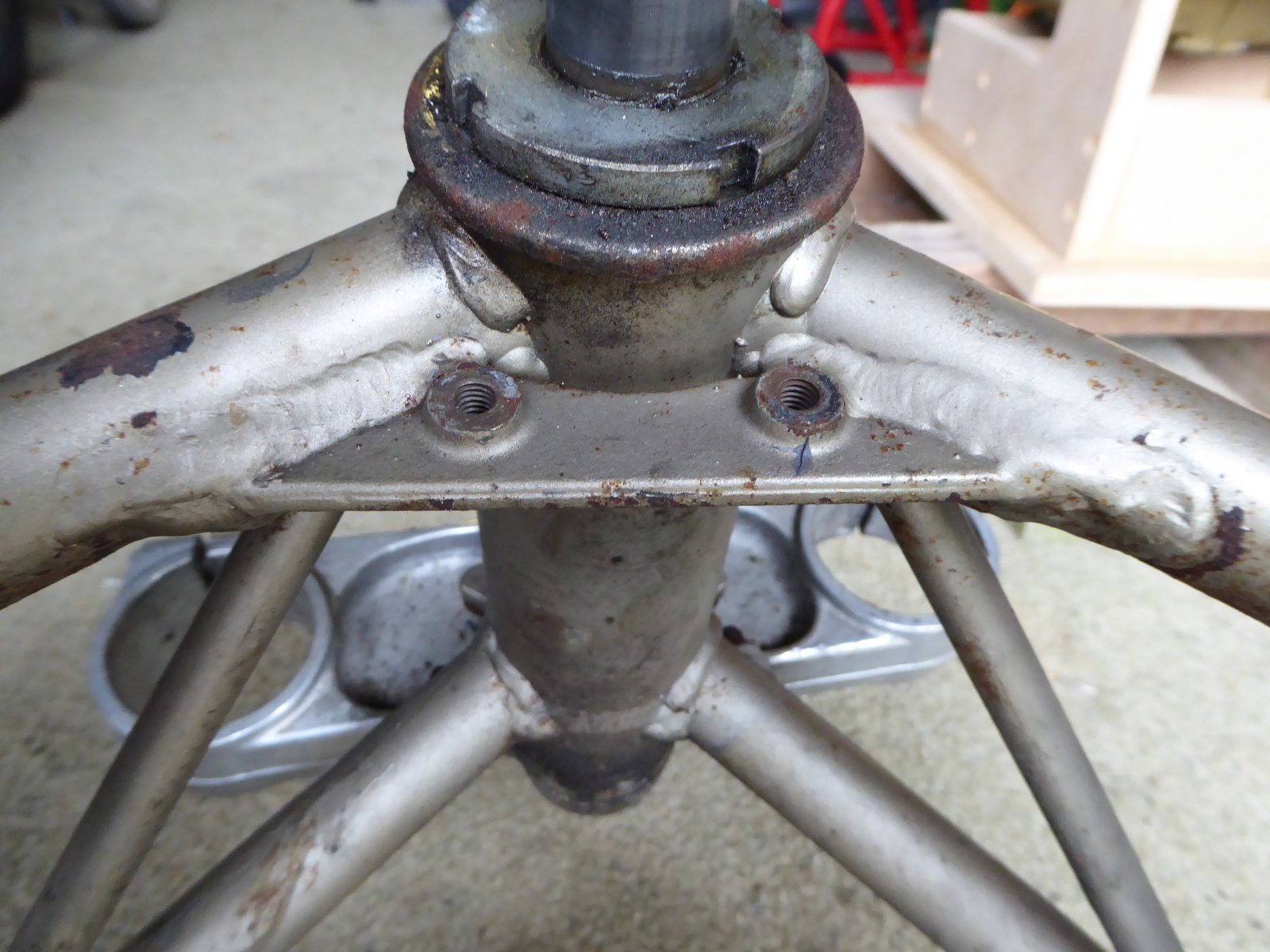

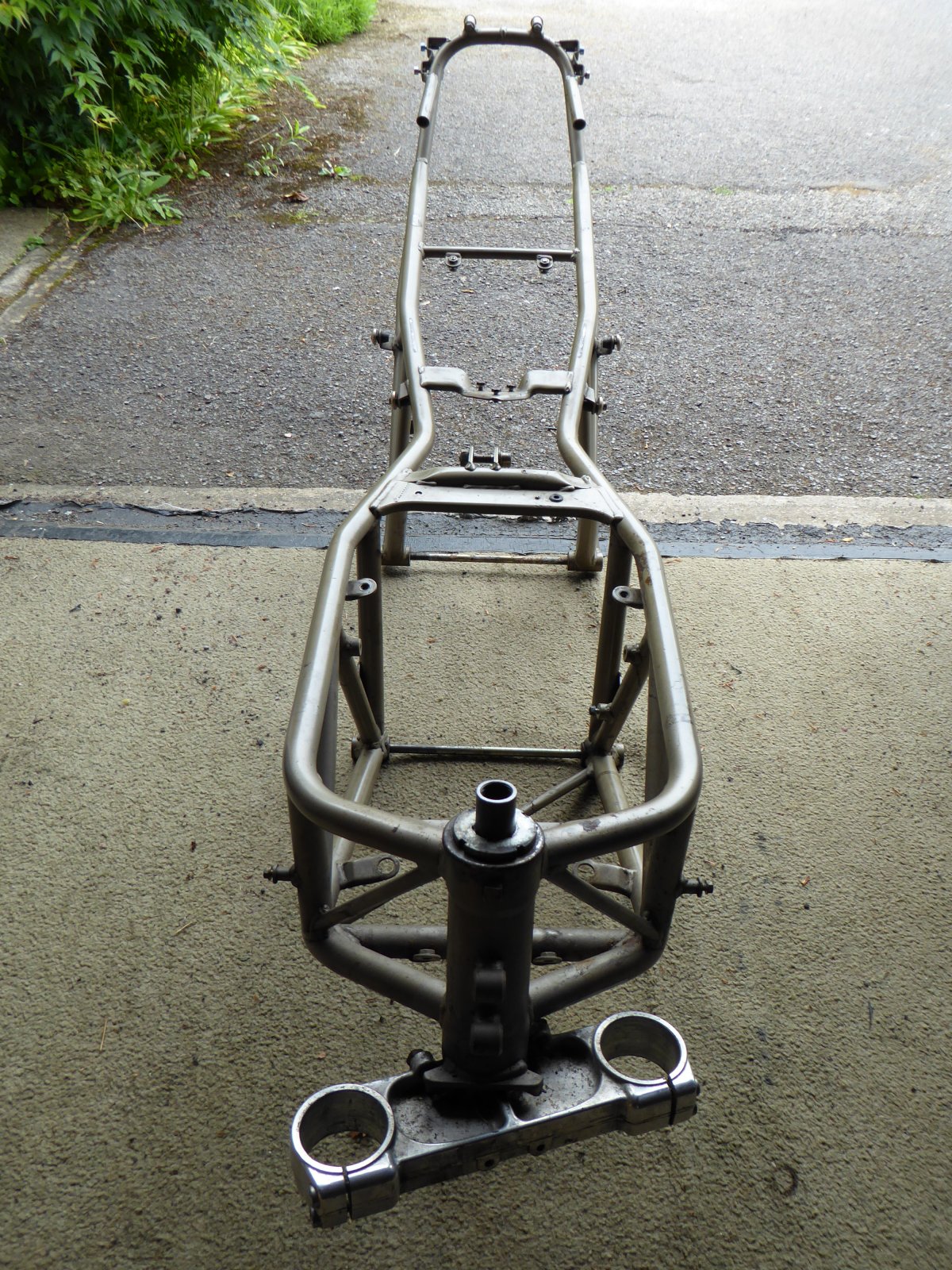

  1. I bought a very tatty 900ss in September last year as a 'winter' project. Several months have passed and I've finally finished stripping the bike down. I've got boxes full of stuff, all carefully labelled, and about a million photos of each stage of the dismantling. Here's what it looks like now.
    I need to get the frame blasted and repainted (is stove enamelling best?) and I need to very painstakingly remove all of the crappy old gold paint off the engine somehow (Nitromors? Dremel and a fine brass brush? Magic?). I really don't want to strip the engine down so I think blasting of any description is out of the question. Then I'll need to repaint it, and could do with some ideas about what sort of primer and paint other folks have used.

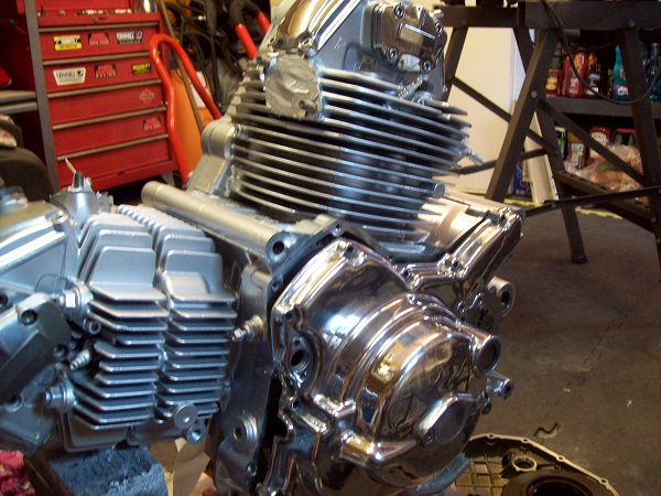

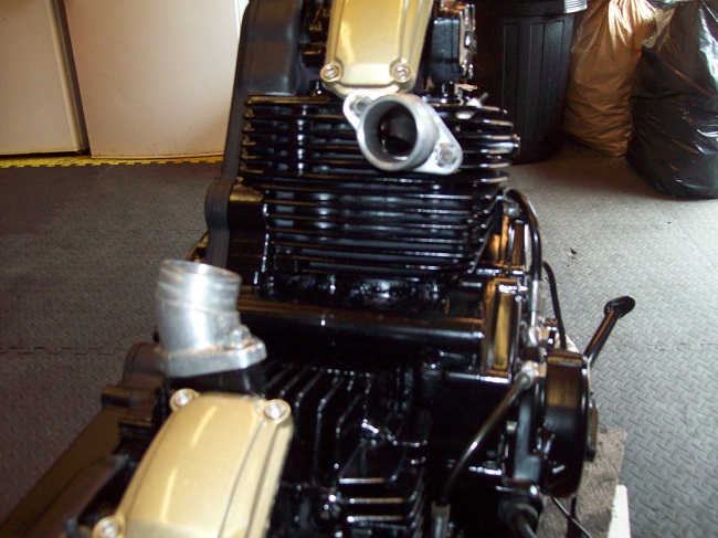

  7. I got my motor soda blasted and have just given it a brighten up with 400 grade Wet & Dry. I powder coated frame and wheels - really happy with the results (a good powder coater is important)
    I've got another 900SS I'm just starting a strip down on, I'll powder coat this frame too but might treat the motor to paint to get it looking OEM. alternatively, ceramic coating looks brilliant, but its expensive - It would have to be a keeper to make it worthwhile ;)

    Here's the true glory of the motor on No.2 900SS yet to be done:
    and
