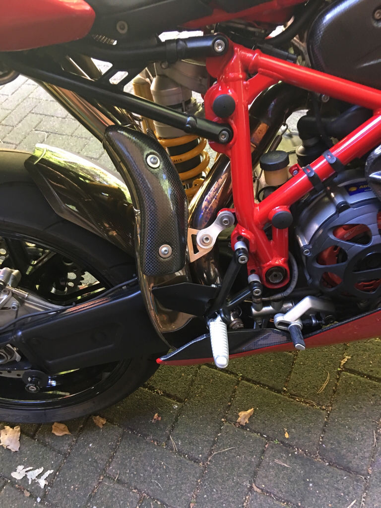

  8. [​IMG]
    This should give you an idea of what your missing

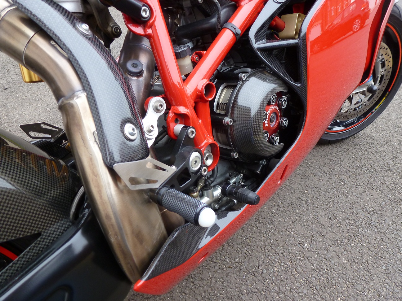

    I have the 57mm system on my 749r, it's identical to the picture posted by Nathanhu. I bought the system from Riders in Bristol, as new old stock. It was advertised as fitting a 999s, but went straight on to my 749r without any modification at all.
    The picture of your system seems to look more "race" than the 57mm "banana" system that I've seen. Are you confident that your system is a Ducati system, intended for road use? This may explain the issues that you are having with getting it all to fit.
    I had an extra port welded in the pipe for the rear cylinder, so that BSD could write a custom map for each cylinder.
    Hope this helps.

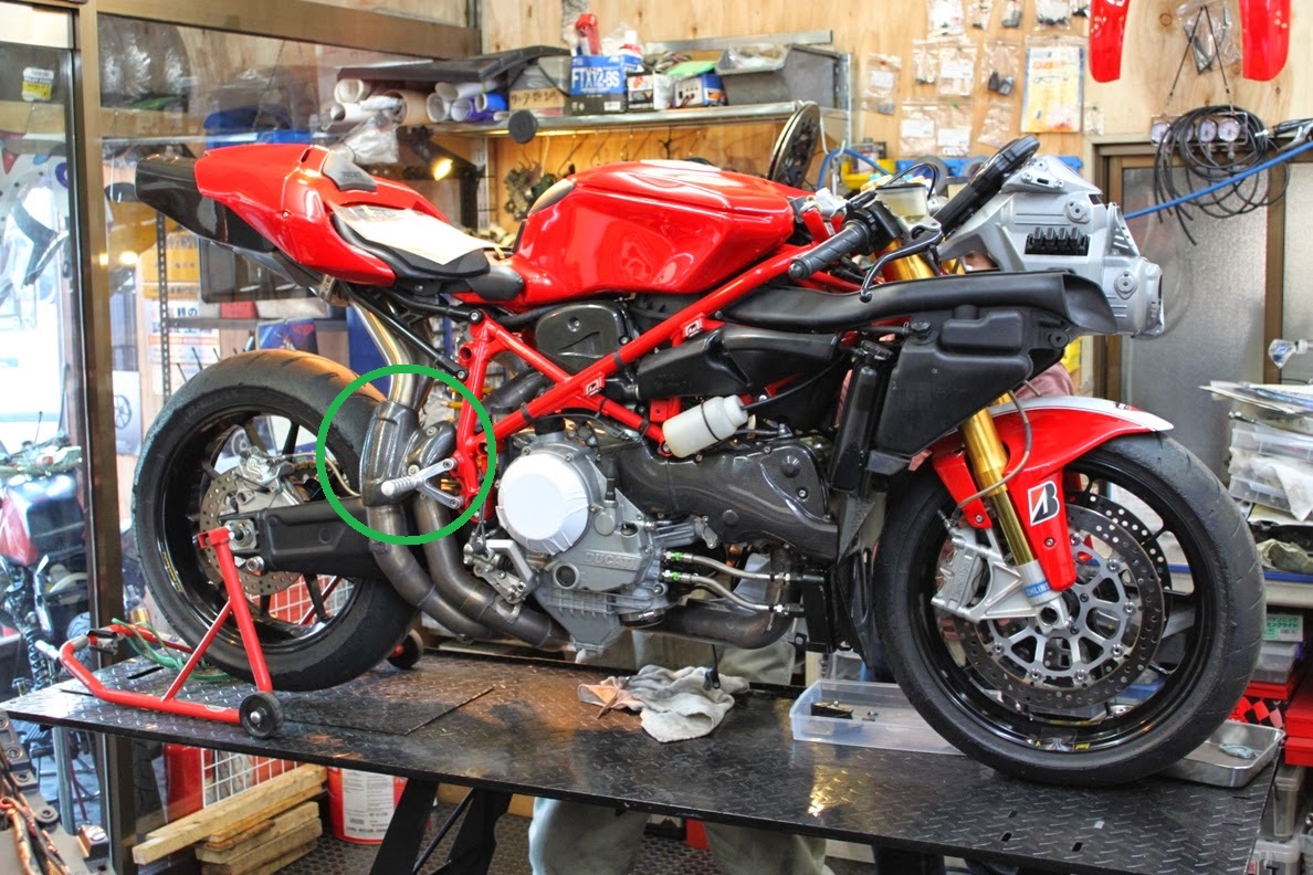

  14. Check photo I attached my one is defo ducati system but all pipe are round.
    Photo I attached is of identical system I have.
