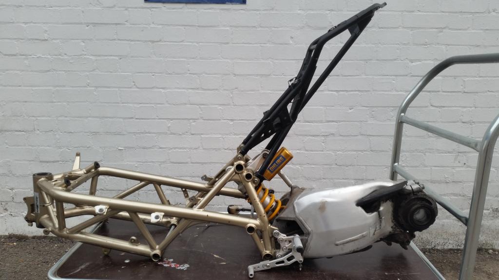

    First major hurdle is the length of the head tube on the 1098 being 1.5 cm longer than the 900ss, so I will be buying an extra suzuki stem and doing a bit of a cut and shut job. The forks should still fit with enough of the thick tube in the yokes, but will double check before I start cutting and welding!
    Bits are still all over the countryside so photos to come over the next few weeks.... but i should add this old photo of the frame just to keep things real.

  11. Nice project. Why use a 1098 frame? You have one laying around? What tank are you thinking of? Assume small alli tank with a fibreglass cover?
  12. ha ha no pressure then :) with so many people interested I'll have to make sure I don't cut corners on this!
    and various bits of engine have mostly been lying around at Ray's place but the crank has been with Rich recently.
    the 1098 frame is a cat B I bought from a fella who used to be on here with receipts from the salvagers. it was a great price so it all sort of developed as a wonderful jigsaw/Meccano puzzle! I was originally after a 999 and double sided swingarm.... but this frame is lighter so not so bad.
