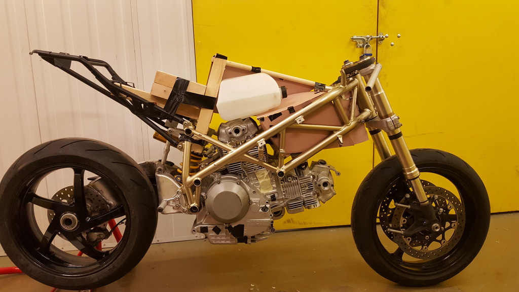

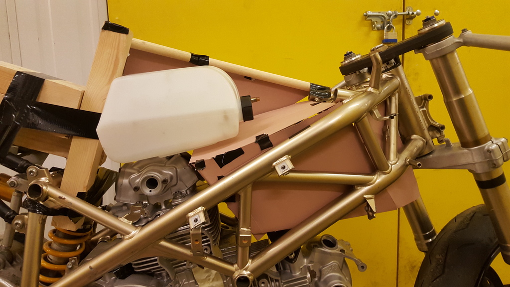

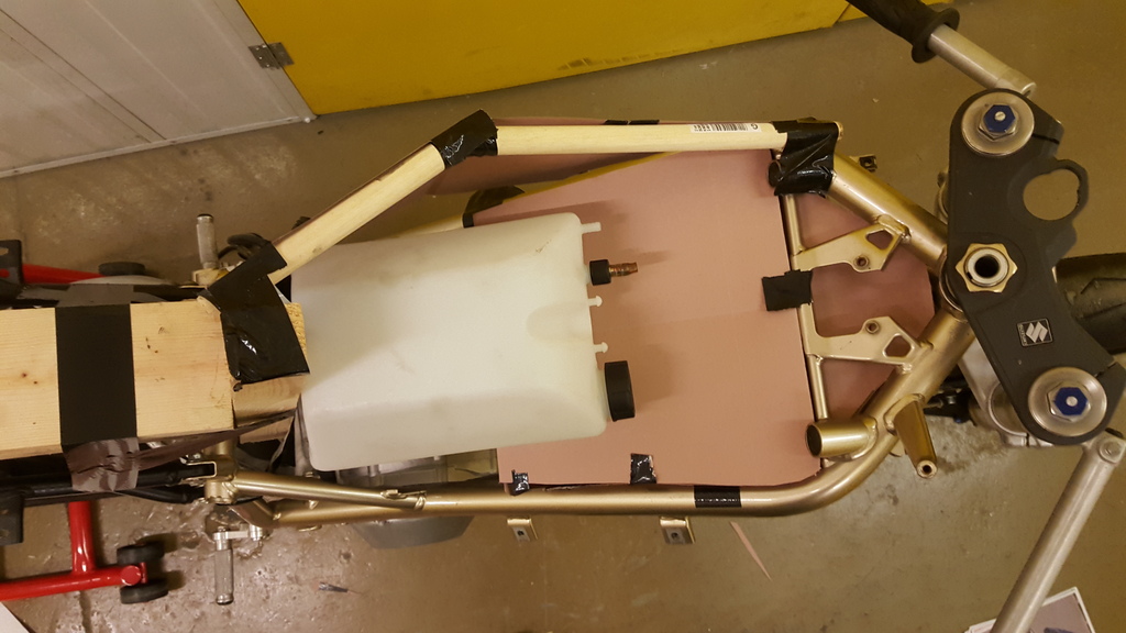

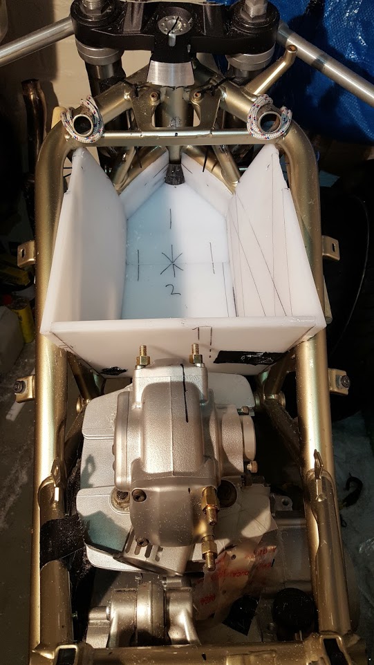

  4. OK, i've finished the design of the airbox and "tank". previous version was too high and didn't leave enough room for a 5-7L tank, so here is the final version. next steps, check ergonomics when i get a seat, make the airbox in ply as a mould, add the bottom and work out the inner layer of the mould so i get a finish on the carbon!
    This shows how 5L of fuel tank fits in, though i'll still be making my own...
    i've given my self some more internal space by taking the fake tank sides out, this also gives a better angle to lean off in the corners...
    This should be a lot easier to make than the complex shape i had previously.... with enough room to mount the airbox to valve cover on the front of the rear cylinder and ignition key surround bolt holes... and the fuel tank to both valve covers on the rear cylinder... see easy... :-/
  5. Why not put the tank under your seat? It'll give you a larger airbox.

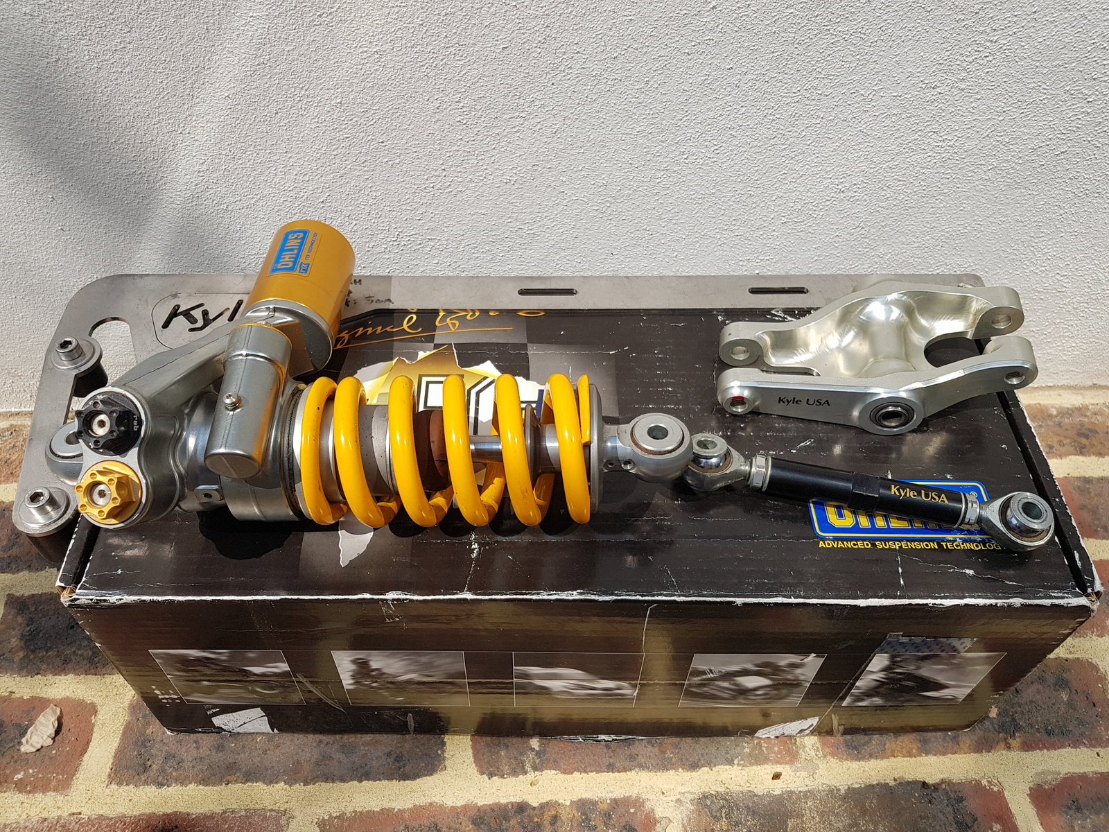

  8. The project is back on! ....OK.... not a lot of progress... but i am about to get my engine sorted in the next week or two, and this arrived from the US.... :)

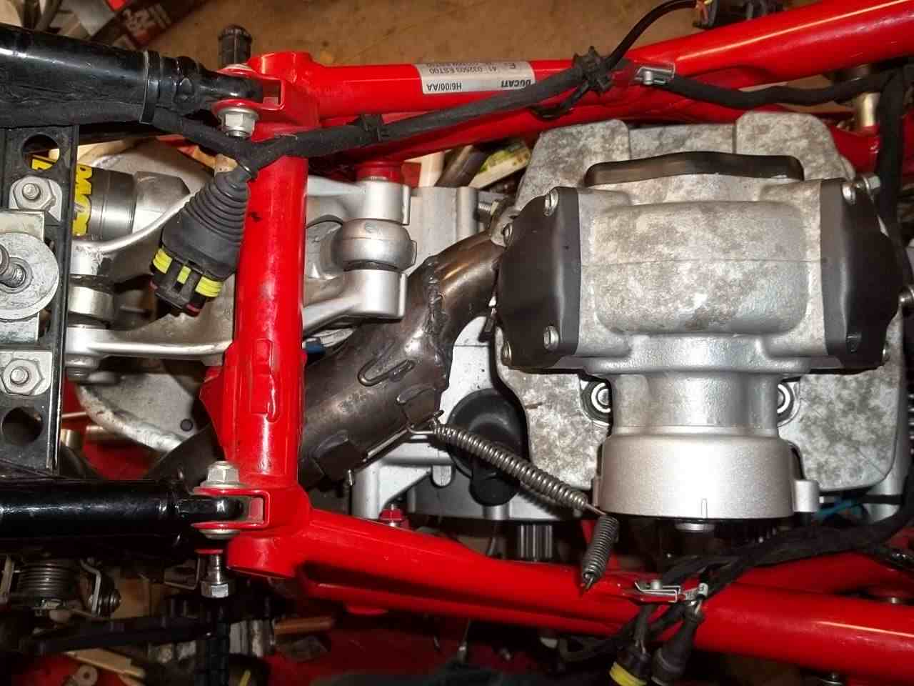

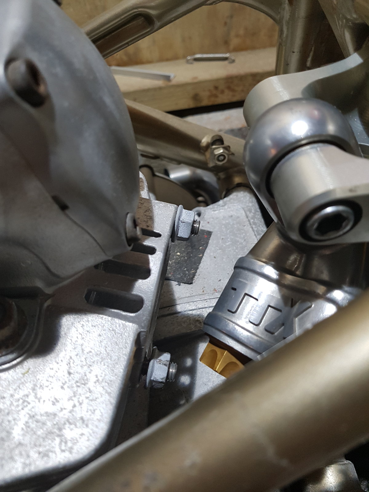

  9. mmmmm going to need some extreme dremelling to get this to fit!
    Not as simple as with using the standard shock and pivot..... You can see in the photo below, the heads are cut back and the owner has used a standard 848 exhaust as the basis. I'll find out how mine all fits together this weekend, but i am going to need to modify or bin my custom exhaust :-( 20180509_205701.jpg 100_0286.jpg

  12. wow!
    What's the shock from?
    is the rocker a linear rate one?
    can't wait to see what this looks like on the bike. :)
  13. It's a modified TTX shock to match the Kyle Flat Rate Link.... But project is on hold till the autumn and ive bought an engine for my 900 from Rich at Louigi Moto.... But at least I'll be on track next week at Donnington :)
  14. was the shock originally destined for an 848/xx98? :)
