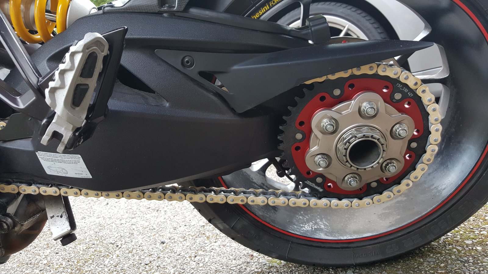

  4. +1 for Bigrisk - they supplied this red one.
