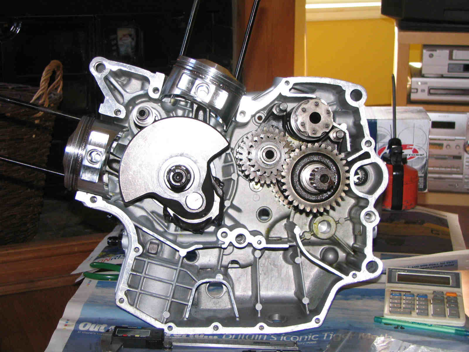

  3. Morning all.
    The crankcases are now split, and apart from one gear needing replacing in the gearbox I’m happy to say it’s just bearings and seals required internally.
    I’ve been round the usual circles with the main bearings, deciding if I should fit a very expensive X2TB spec bearing to the Primary gear side or an X2ETN. I’ve ordered an X2ETN as Moto Rapido assure me Ducati spec them now and they are more than good enough.
    When all the bearings and seals turn Up I’ll press them in and start measuring to get the 0.015mm sideways preload on the main bearings.
    Talking of which, Moto Rapido tell me the crankcase gasket, 400129330, is no longer available, and have quoted a Threebond ‘Goo’ instead, although I could order the gasket from Stein Dinse.
    What’s the experience of anyone who’s been down this route?
    Does anyone know which Threebond product is the recommended one?
    Being an old fashioned sort of bloke I like the thought of a gasket being in there with some sealant either side, but am prepared to go without if it proves better.
    The other issue with no gasket as far as I can see is making the shims on either end of the crankshaft and gearshafts thinner.
    Obviously I’m going to have to work these out again anyway as I’m replacing the bearings, but I’m more likely to be lucky with the existing thickness shims that were paired with a gasket from the factory.
    Thoughts anyone?
    Thanks
    Nasher.

  8. I’m still in a quandary about the centre gasket.
    I did get hold of a tube of Threebond 1104, with the plan of going commando, but then took a better look at the insides of the crankcase and the gasket and realised that the gasket also baffles the sump side to side quite significantly.
    I ordered the last remaining gasket that Medina Italia had in stock for next day delivery, then got a call to say the one they had was damaged and that they’d have to refund my payment as it would be next Friday before they could get another one.
    Worryingly I’ve now measured the existing crankshaft shims that were fitted with a gasket and they are almost the thinnest available at 0.35mm, so if I don’t run a gasket I’m in danger of not being able to get shims thin enough.
    Anyway, last of the bearings I’ve ordered should rock up today, and I’ve got a supplier from work jacked up ready to press the old bearings out and the new ones in, at which point I’ll know exactly what I’m up against measurements wise.
    I’d imagine I’m going to end up ordering a gasket from Stein Dinse, but am waiting on a reply to my email to them asking what the difference is between part numbers 70010044A (18,00 €) and 400129330(7,79 €) which are both suggested for the M/SS900 crankcases.
    Nasher.

  12. I ended up biting the bullet and swapping out the bearings myself.
    I got the cases nicely warmed up in the oven, and left the new bearings in the freezer overnight.
    I turned up some large aluminium drifts to just the right size to fit the outer races, and recessed their faces so there was no chance of them contacting the inner races.
    They were a waste of time really, because the old bearings popped out of the cases with a gentle tap from a mallet, and the new ones dropped in with NO resistance due to the difference in temperature. They are nice and snug now though.
