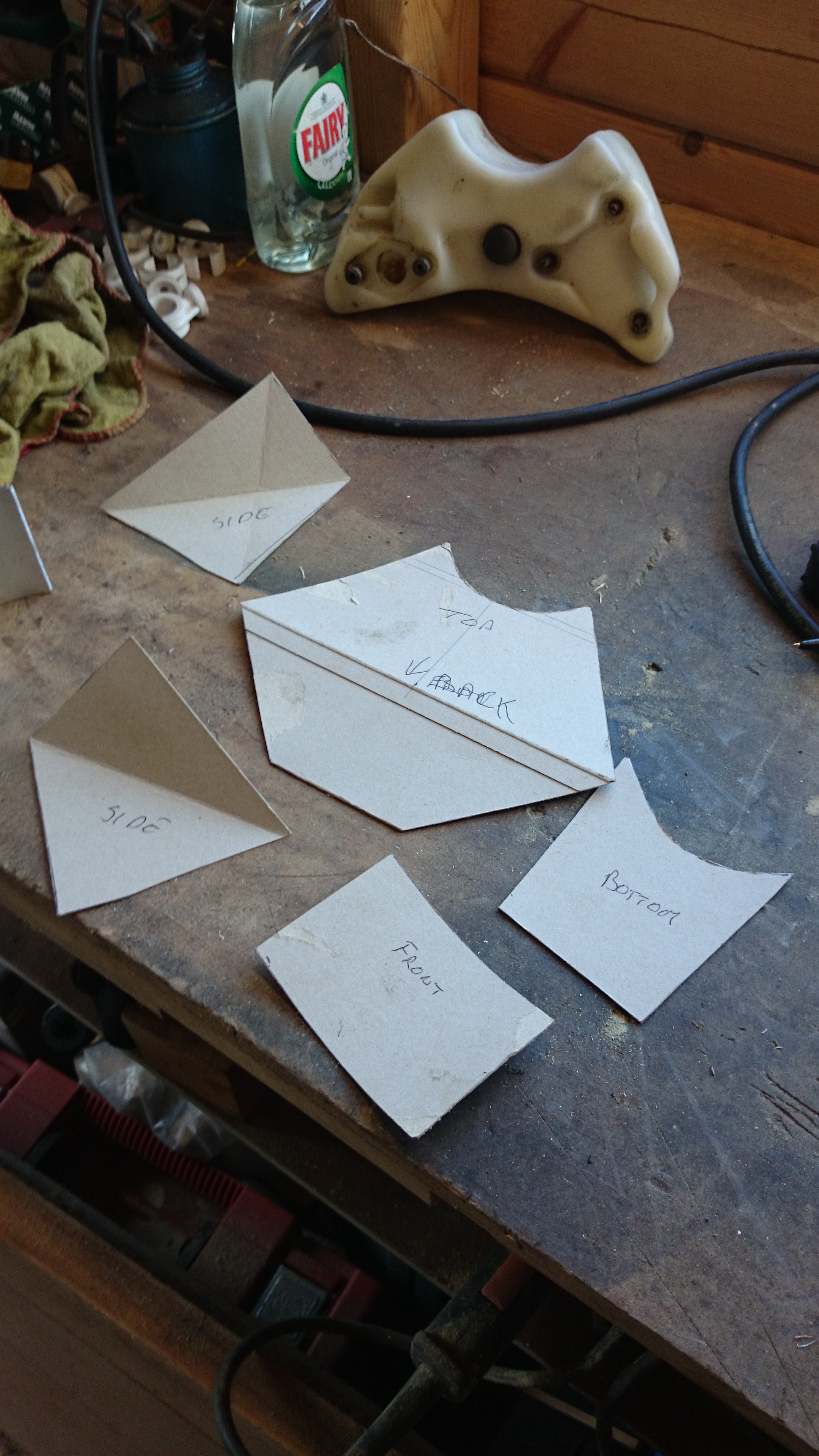

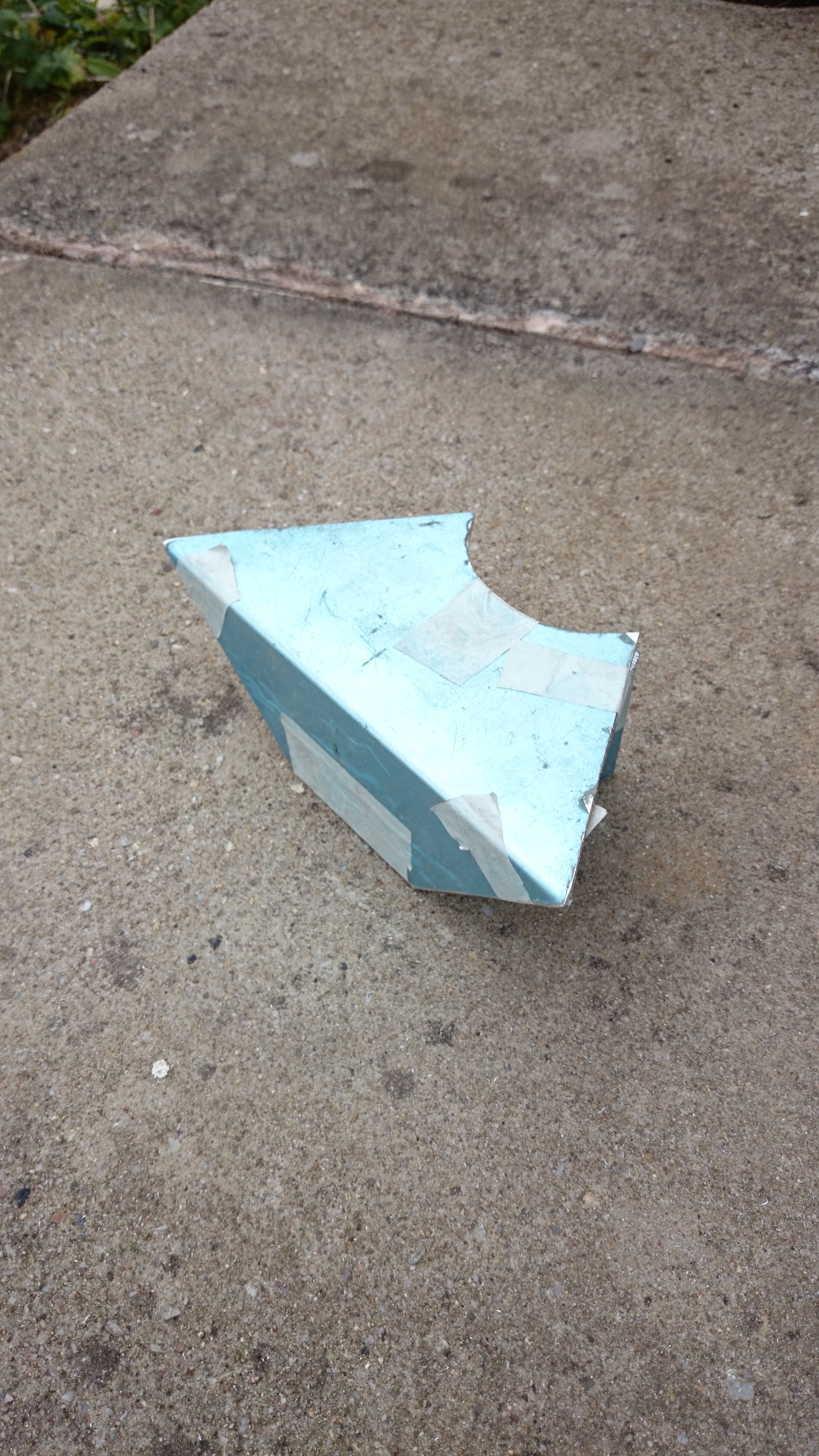

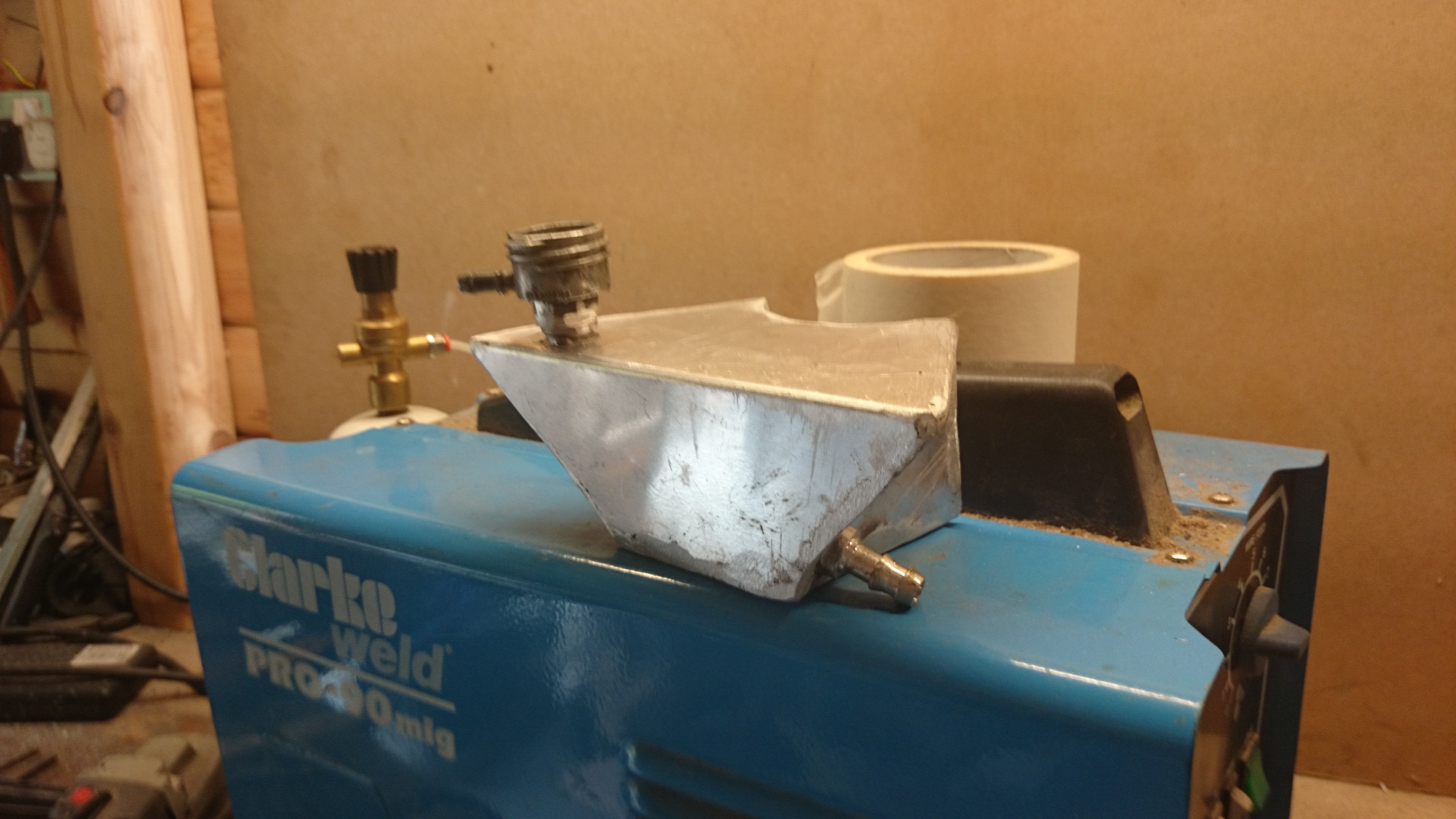

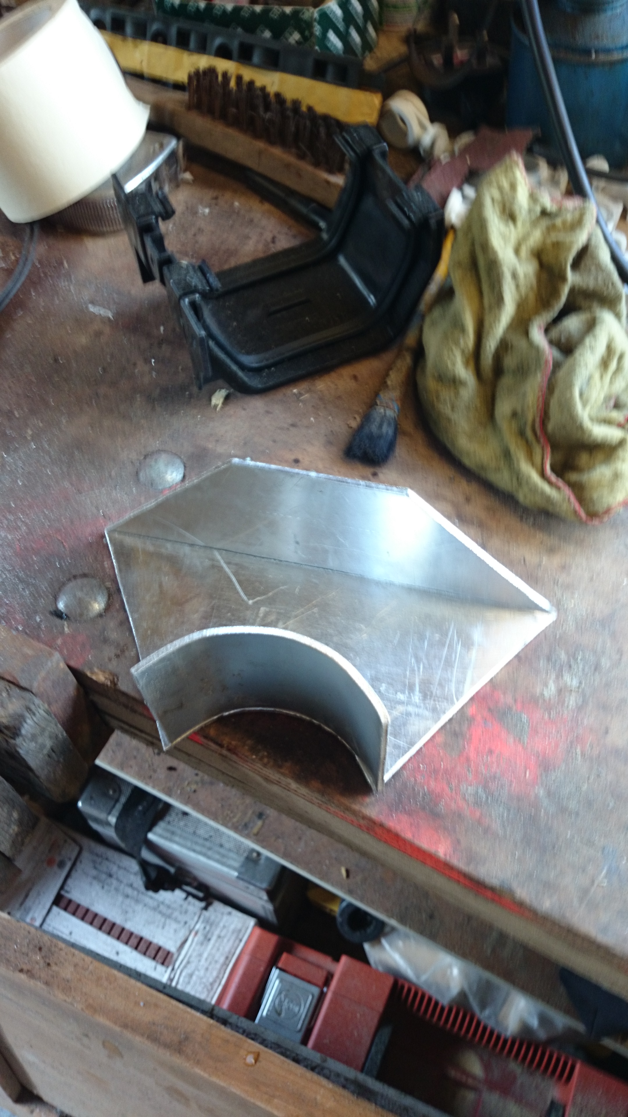

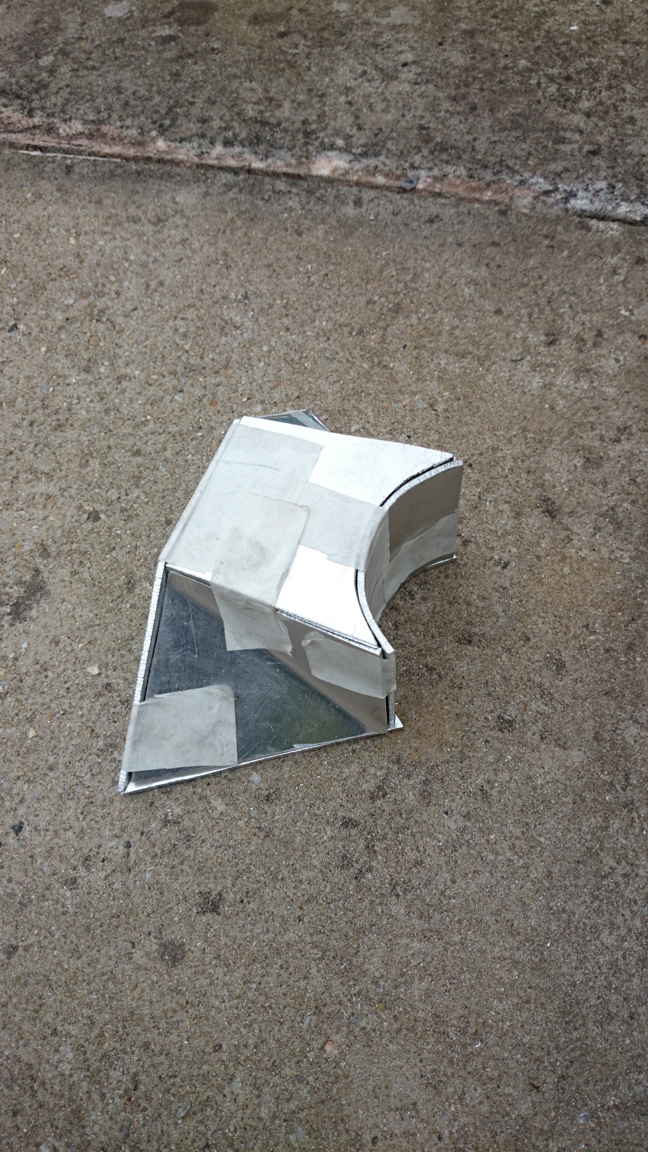

  1. After my first expansion tank leak at the weekend I fitted my used spare and as I had the old one to use as a template decided to have a go at making my own ally one, done plenty of steel welding but never ally so I will have to practice and if I can't do it I have a friend who can.
    So I started with a cardboard mock up and used that for templates for the 3mm ally plate, after cutting and bending the different shapes I now have a tank look alike to tack together ready for a test run and to mark the best place for the hose connections. Hope there aren't too many alterations needed.
    I have often wondered if these could be made out of carbon fiber and if so why has no one ever done it as it does seem to be a regular problem.
    Steve

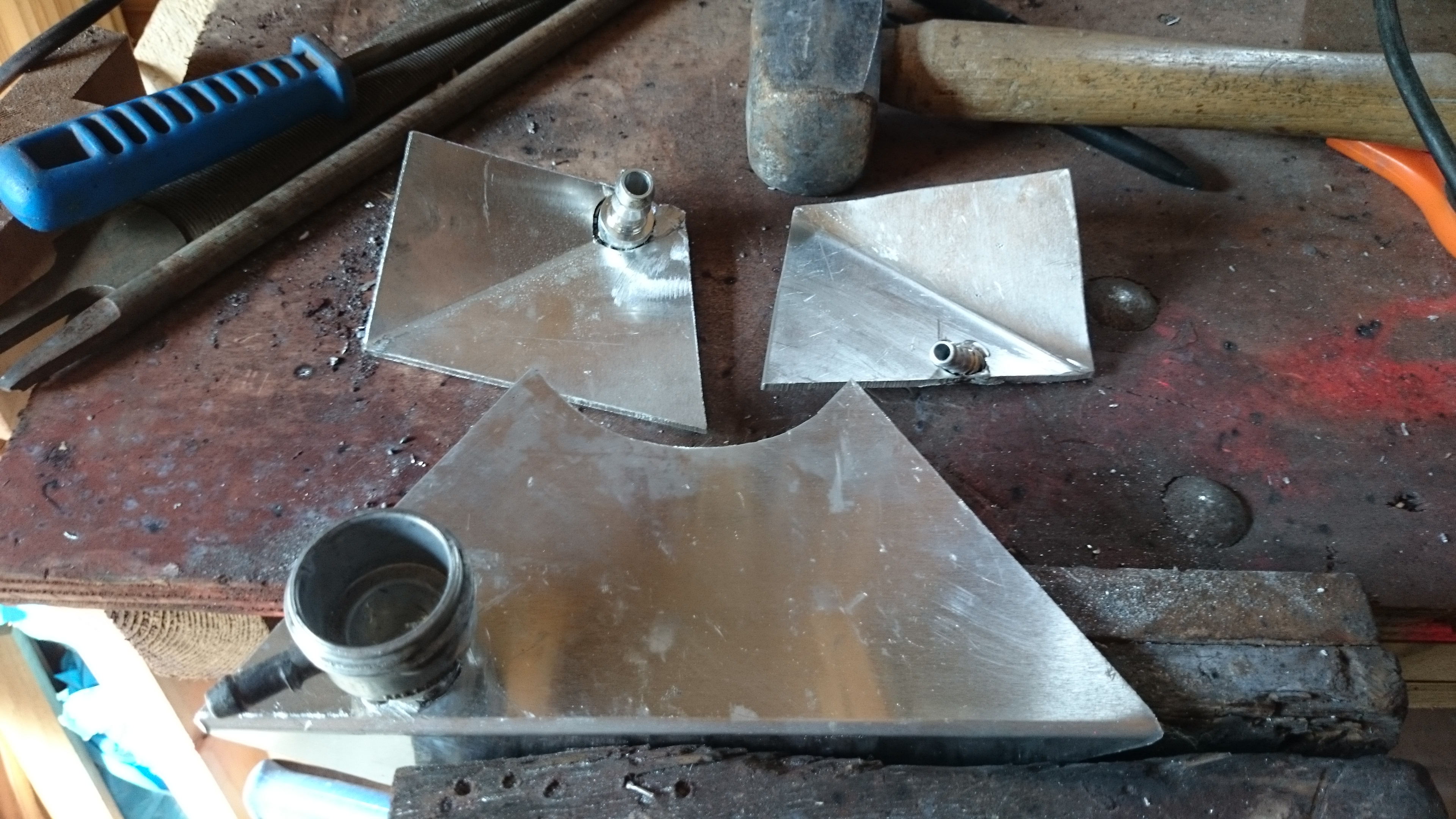

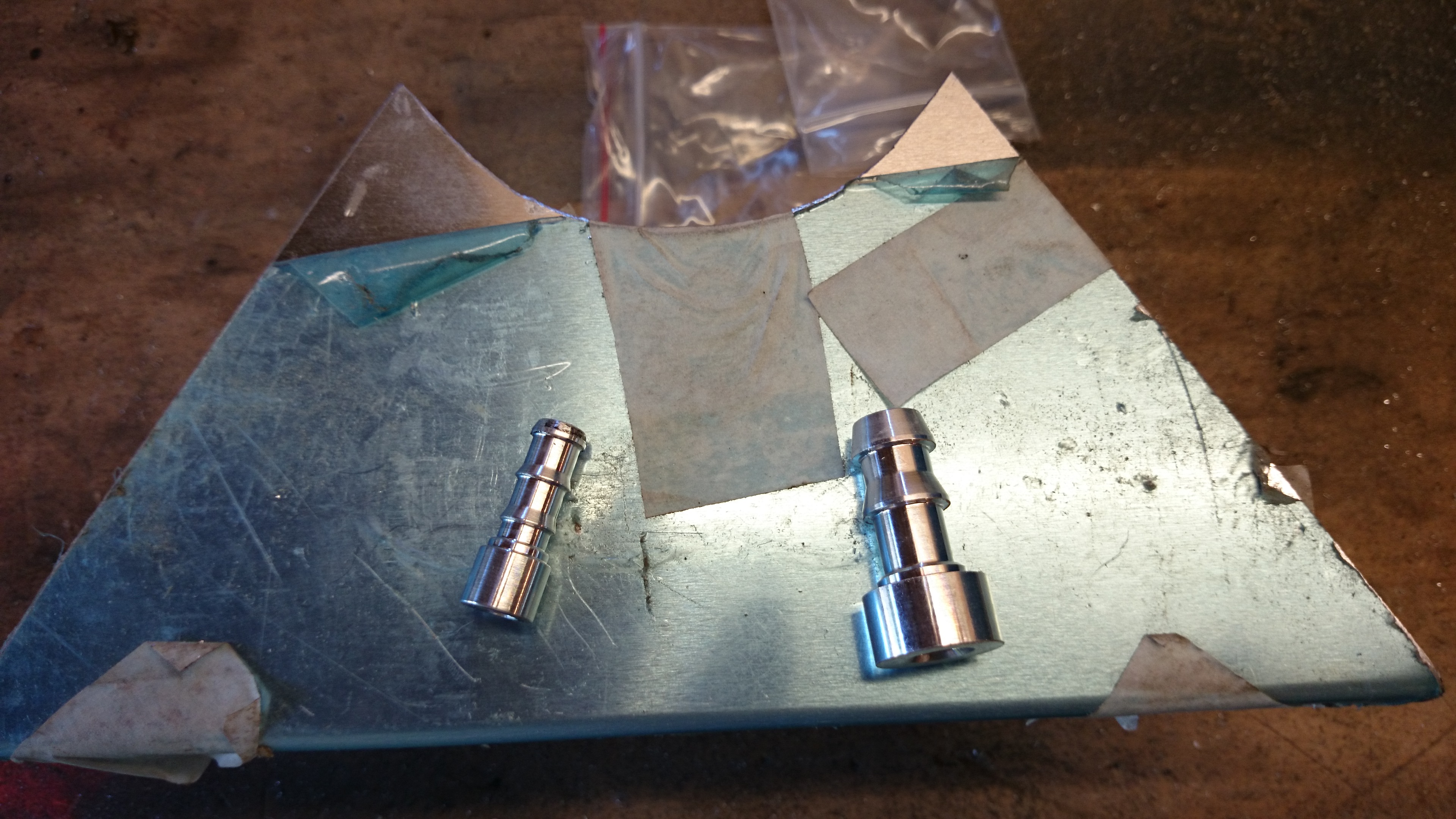

  8. Got the two weld on spigots for the hoses yesterday, now just got to remove the tank and airbox again to have a test run.

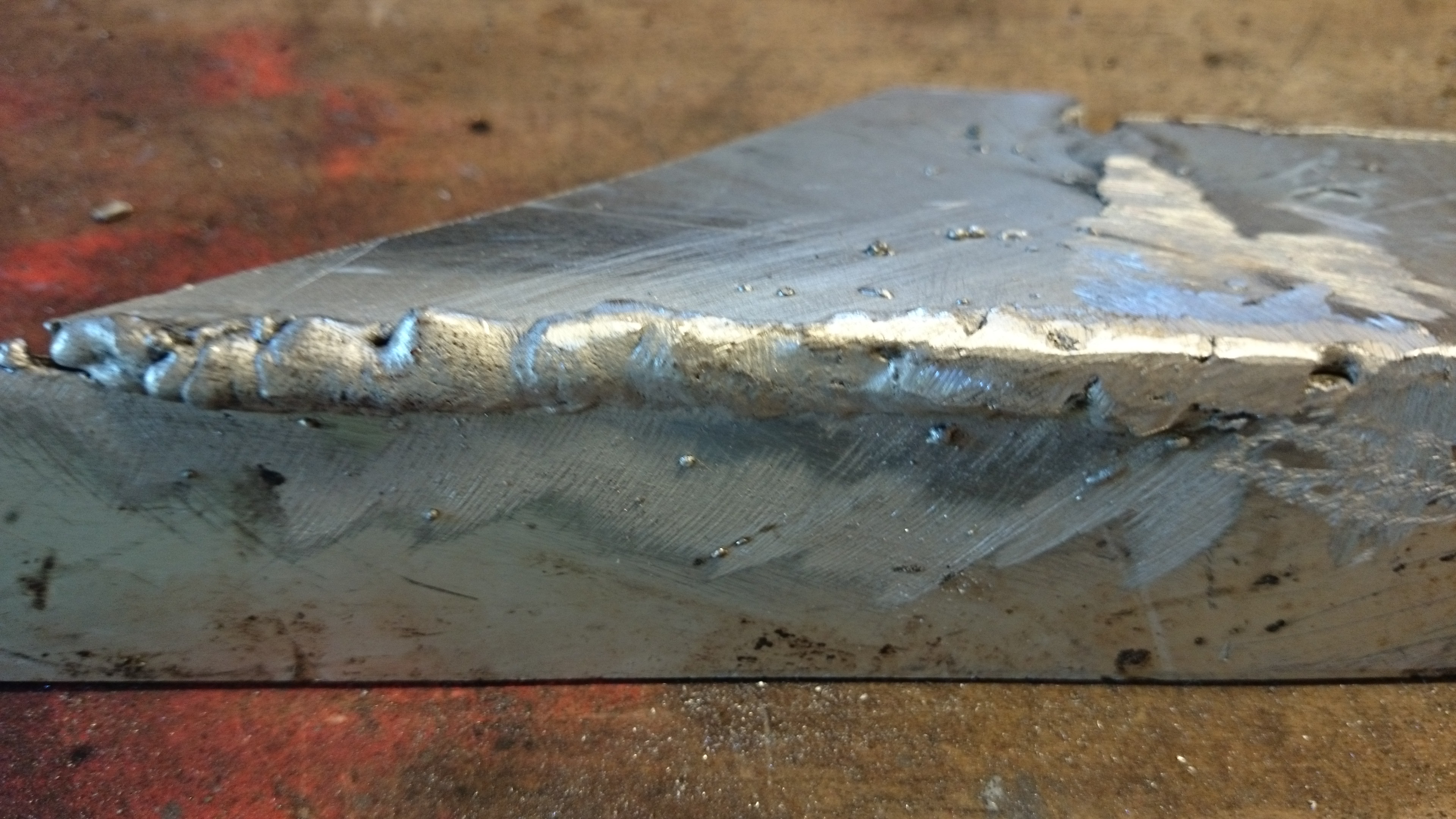

    First ever attempt at Mig welding alloy, Mr R (Steve) I went for the 3mm hoping I wouldn't burn holes through the thinner material, if this one works I will have a go with some 14 or 16g as you suggest.
    Lucky I have some spare sheet as a lot more practice is needed yet, I would like to finish it myself but if all fails I will have to by buy mate a few beers to tig weld it for me.
    Off to practice now.
    Steve

    While practicing I have found that you have to have a lot faster spool feed and a faster weld speed compered to metal.
    My first attempts were one handed as I only have a hand held mask I think I can make a better job when my full face helmet mask arrives so I can steady the welding hand a little.

  12. Must add I have had a test fit and it is spot on, no need for any adjustments, very pleased as I only had the plastic one as a guide and they have all rounded sides to contend with. Might be next weekend before I get it welded up though, awaiting a new mask.

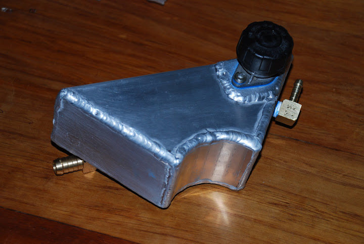

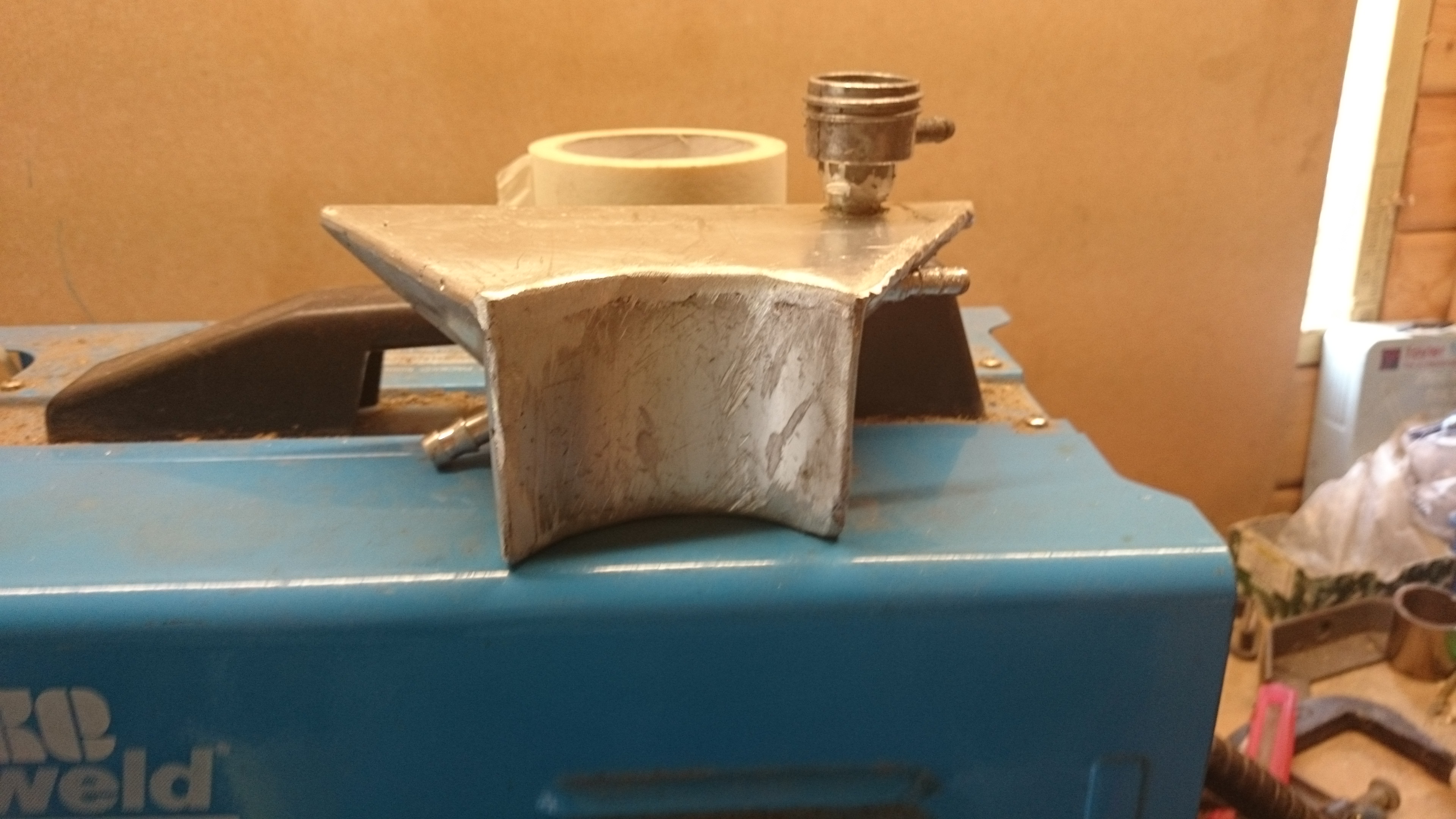

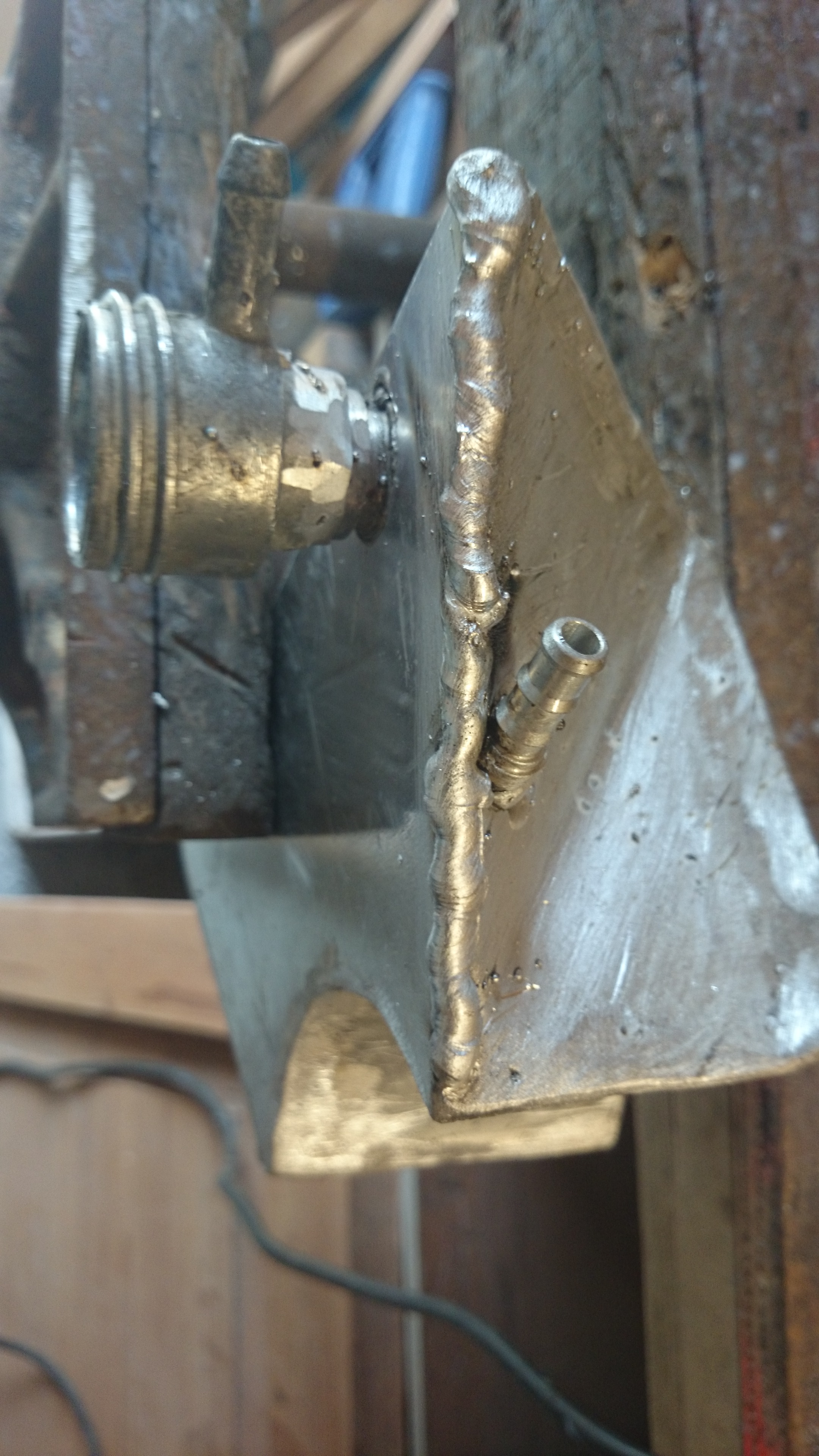

  14. As it was raining today I couldn't wait until the new mask arrives, so I have put it together as best I can. I found that pushing the weld gave a better finish than pulling although alien to what I am used to with metal. 2014-08-10 15.13.50.jpg
    I have ground some of the welds off to give a better fit around the headstock.
    Just got to pressure test it now, quite pleased with the outcome as yesterday was my first attempt at ally welding.
    Just a bit of splatter to clean off.
    Steve
