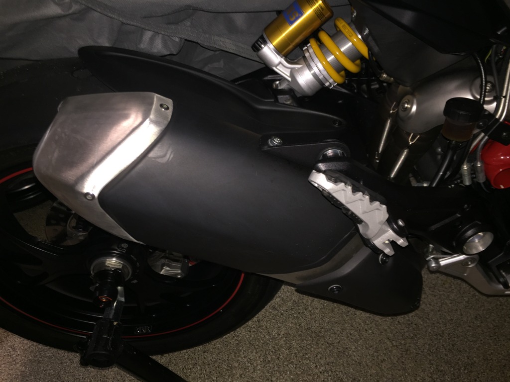

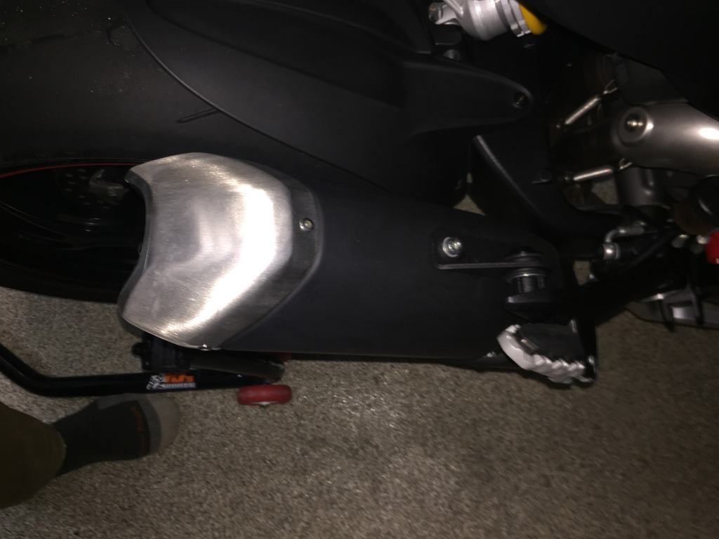

  12. Do you have a picture?
  13. Here is a picture of the 821 OEM muffler on my 939 SP. The 821 and 939 attach exactly the same. The only difference is the 939 OEM muffler is about five inches longer from the mounting bolt back.
    My wife has an 2015 821 Hyperstrada so I was able to confirm the exact fit prior to buying a used 821 OEM slip on.

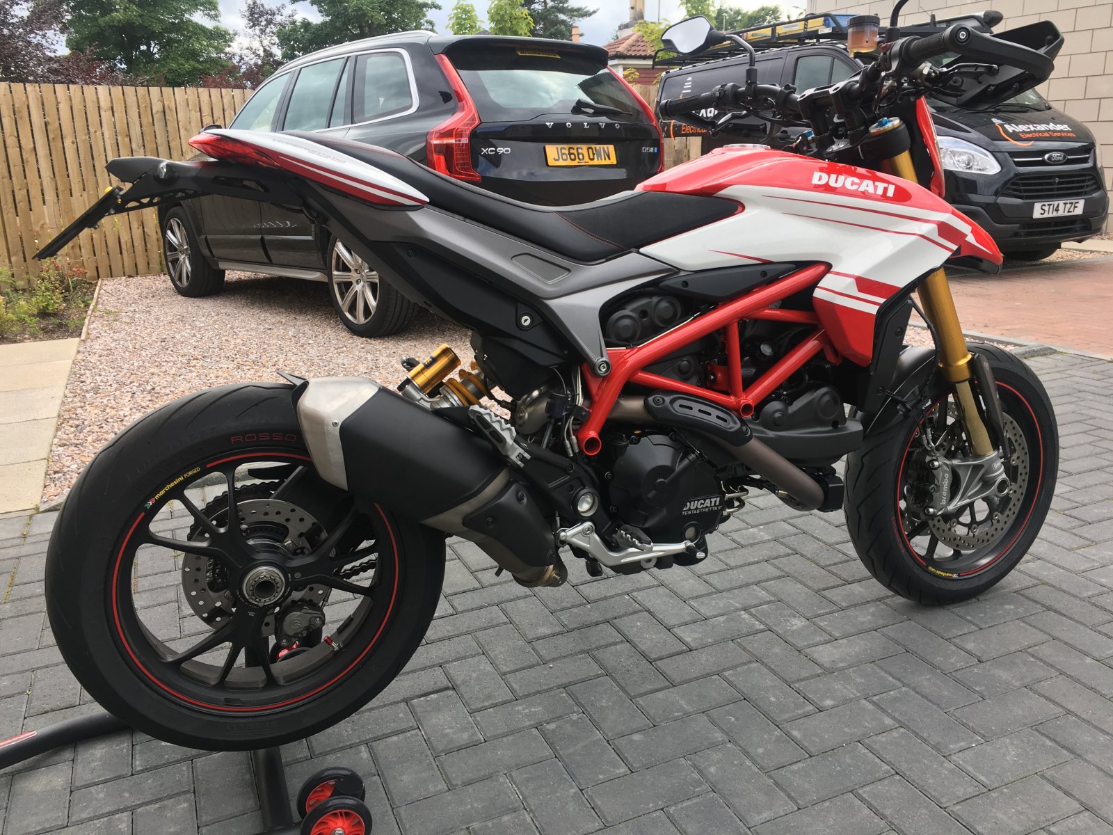

  14. After having a chat with Todcp - went ahead and bought an unused 821 SP exhaust of ebay for £130. Really cleans up the rear of the bike. Sounds just as good if not slightly better. Done 120 miles and experienced no fueling or power delivery issues. Couple of nice pops still on overrun.
