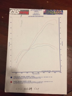

  18. I had mine done just over 3 years ago now, engine built by Protwins in surrey, and then tuned by Chris at CJS Racing in Bristol, both did a fantastic job. See the Dyno chart for evidence. IMG_0341.jpeg
