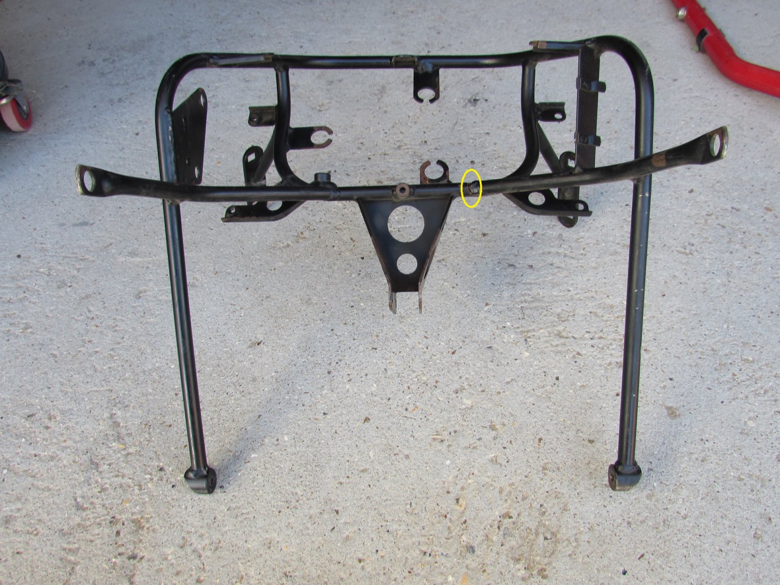

  1. Hello, does anyone have a 900ss carby front fairing support bracket , (I guess the 600 & 750 are the same), mine has fractured, I could weld it but if anyone has one for sale it's an easier fix , thanks Mark.

    Wayne
  3. Mark, my apologies, I remembered it needed paint but had clearly forgotten it was also damaged, there is a stress fracture adjacent to the weld (circled) it's yours if you want to cover the postage, but I can't imagine what you might need with another knackered one. From memory these are chrome/moly tube and need care with welding.

  4. Actually it's a lot better than mine that has completely broken through on both sides, a mate of mine has a good TIG setup so yes I'll have it please, I'll PM you, cheers Mark
  5. Its a common weak point I have a few of these, in different conditions. Any issues let me know.

  9. The cracking at that point is the common failure where they all seem to go. I successfully repaired mine by making an insert to go inside the tube from a piece of steel bar, and then brazing the joint.
    That was at least 25 years ago, and 30,000 miles back, and the repair is still going strong.
