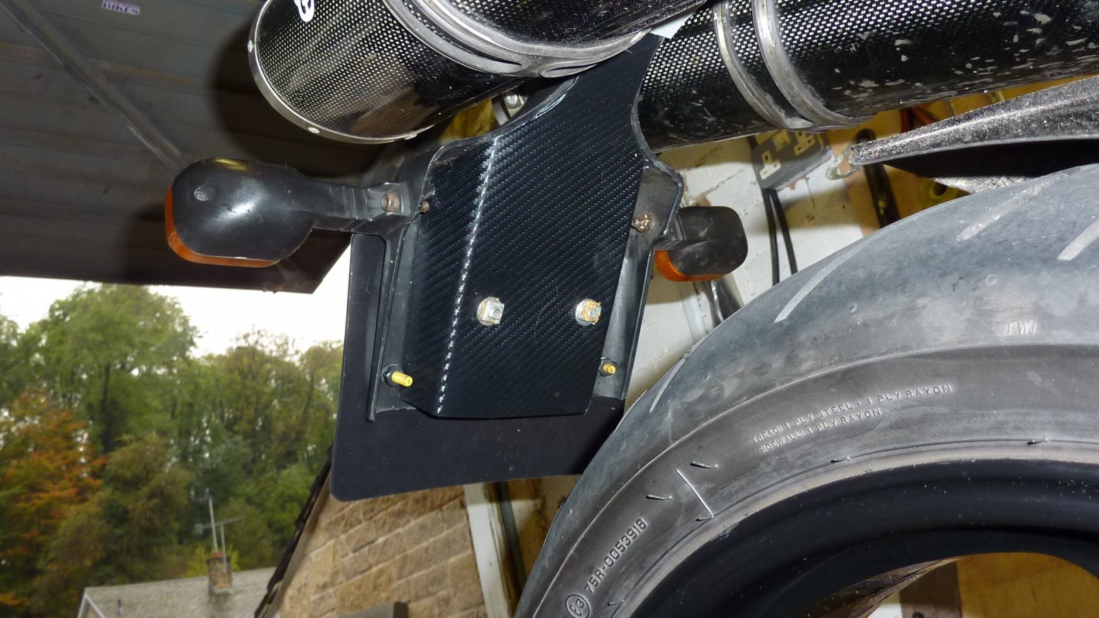

  14. Better air flow on my 748. 2013-10-26 08.37.51.jpg 2013-10-05 08.44.16.jpg

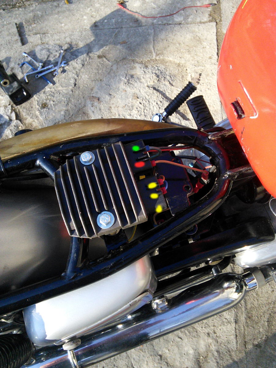

    Note that this is a two wire alternator but the regulator is a three wire one, it makes no difference.
    I will fit one of these to the wifes ST2 this summer.

  17. Same arrangement on my 907ie. I had to cut some of the fins to clear the mirror mounting so that the fairing panel would sit fully home.
