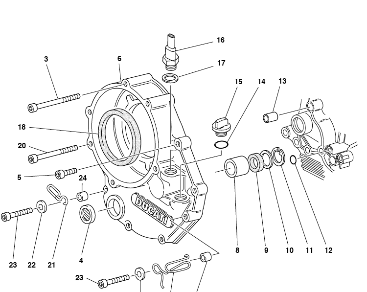

  13. The seal Mr R is referring to is item 9 in this drawing from the parts list. The oil travels from oil pump into the clutch cover, the oilway is sealed at the joint by an o-ring ( item 12), then down the centre of the crank to the big ends. The end of the crank fits into the bush 8. The seal should be replaced every time the engine is stripped as it is essential for oil pressure.

  14. Hi Derek, Many thanks for your detail. Yes this seal was replaced when the engine was stripped. I have ordered a new pressure sensor switch but the figures I was getting are below those posted above so I still think I have an issue..

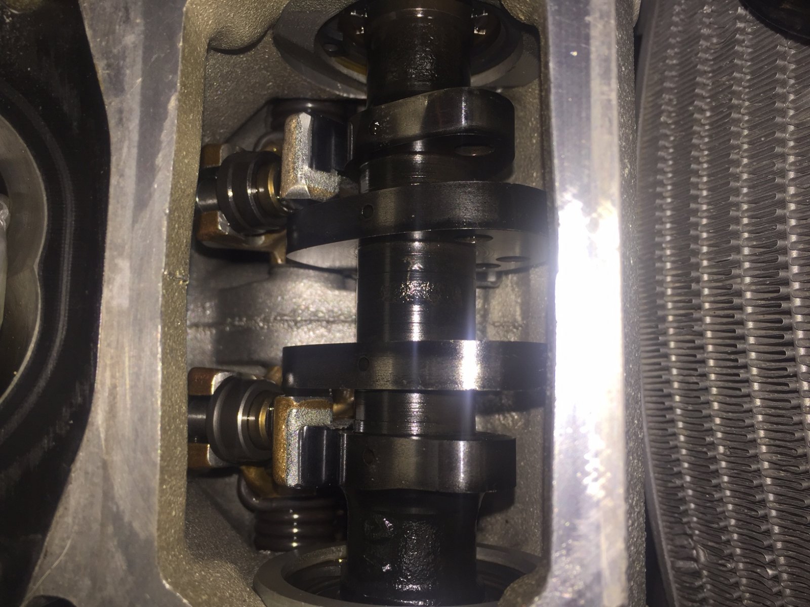

    I did pull the inspection covers off on the head to have a look at the lobes after engine had ran for a few mins, and there was little to no oil in there. Certainly would not ant to run engine under load or for a long period of time.
    So net steps is to trace the oil feed back to the cooler and then the filters to see if oil is indeed feeding to the cams. I would imagine that the is direct result of the low oil pressure, as in not enough to feed to the top end of engine. But still no help to finding the issue.

    On the cam shafts the bearings are needle type so I am struggling to see how enough pressure builds to get oil into and through the shafts to the lobes.
    Attached image is from the horizontal Cylinder, looks very clear of oil to me, I know oil ducati cams.JPG drains back but this is as clean as when I put the engine together..
    Will let you know what I find from this.
