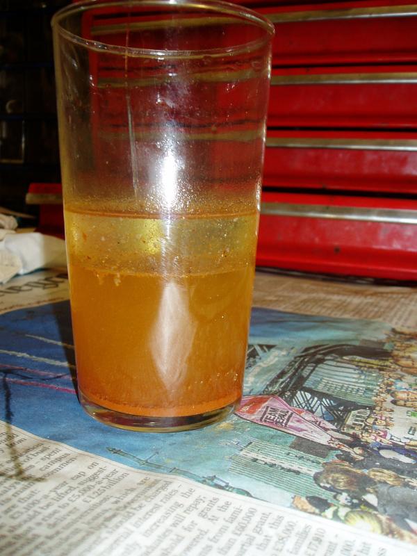

  6. Have you checked in the petrol tank for water?
    I had a sudden loss of power on my 748 once, sort of felt like a "limp home" mode. It went away overnight and then returned the next time I braked hard on a bumpy bit of road.
    Anyway, I shone the trusty maglight into the tank and spotted some fairly sizeable "jellyfish" of water skulking around in there.
    Drained the tank (captured about half a pint of nasty rust coloured water), changed the filter and all was well.
    It turned out that the drain tube had kinked after the Y-section (careless tank fitting) meaning that the drain from the filler recess was returning into the tank via the breather pipe rather than flowing away to the underside of the bike. P1010034.jpg
  7. have had similar on several bikes indie - good point. A rare breed of owners ride in the rain so not written up often ;) Both times mine was a partially blocked drain tube at the top and visible with the fuel cap open (where the drain tube is attached inside the tank). If I had opened the fuel cap mid-torrential rain (but why would I?) I would have seen what was happening as the water level rises until it can enter the tank via the air vent within the cap. Because the water has disappeared usually when you next top-up you are often not aware of the problem. This applies to all bikes fitted with the 'air vent in filler cap' design. Mine happened on a 748 and a 750 Elefant. You can carefully 'rod' the obstruction through normally but whatever you use needs to be blunt as you could tear the flexible hose as you plunge through the obstruction usually at the top.
