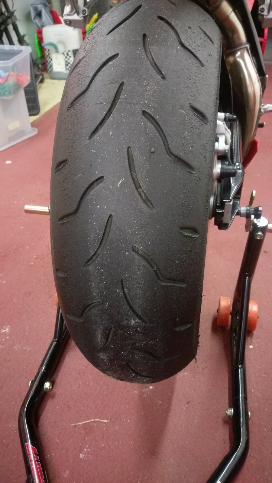

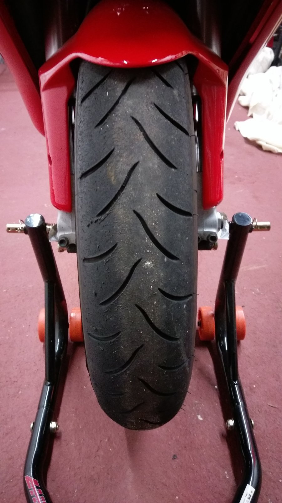

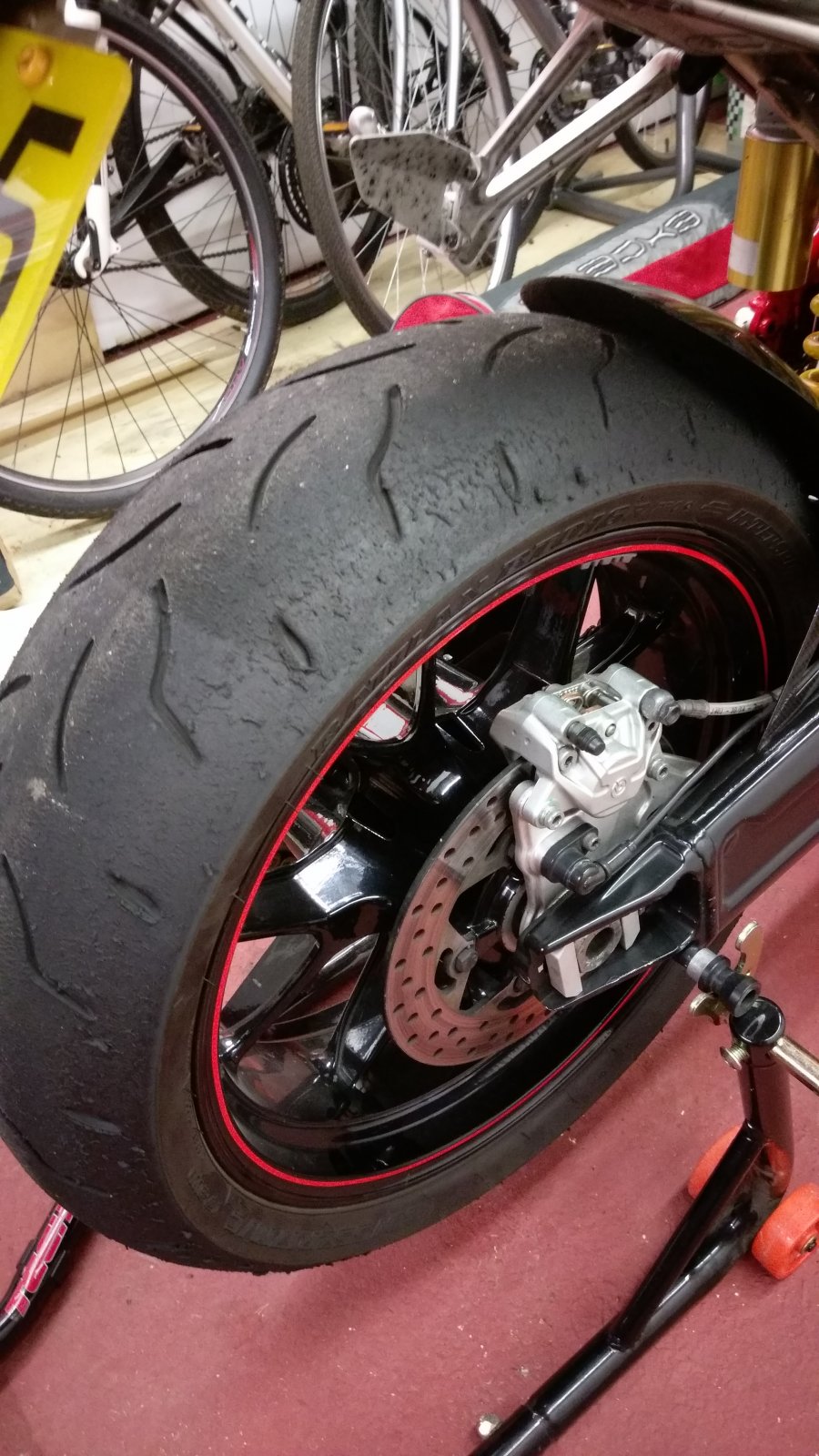

  7. Hi
    Ok so I had my day at brands hatch and it was a fantastic day :grinning: .
    So I run the tyres at 30 rear and 32 front when hot ( well as hot as I get them lol )
    Here are the results attached pics ..
    Do they look ok running at those pressures ?
  8. Good looking wear.
    Not sure if it's just me or my eyes but looking at the build up on the grooves (rear) towards the edge makes me wonder about suspension?????
    @royalwithcream
  9. Ok
    What are you thinking maybe a set up correctly ?
    Although I do believe the forks have been modified with bigger springs or something as I can't get the front sag to less than 21mm with me on it , and I think people aim for 30mm front .
    Front did seem slightly understeering today but still loved the day
  10. There's a good to the point guide here:
    Race Track Motorcycle Tyre Wear Guide - Types and Causes
    There's a bunch of possibilities so I wouldn't like to say I know what I'm talking about but from the pictures:
    Raised trailing edge that you have on the rear often indicates too fast rebound.
    Raised leading edge that you have on the front often indicates too slow rebound.
    Is there perhaps a bit of geometry tear from too much weight on the front?
  11. Thanks for the link , I'll have a look at that and see what I can see .
    To much weight on the front .. err I try not to lean on the bars to much and hold myself with my legs under braking .
    Not sure what else I can do about that .
    Maybe an idea to have the bike's suspension set up professionally ?
  12. Definitely worth getting the suspension setup, it makes a massive difference and pays for itself in tyres if you're on track. Paul Goodall who used to work at Snell Performance does mine, he's near Southampton and very good:

  18. Should be about right, just check right after the first session.

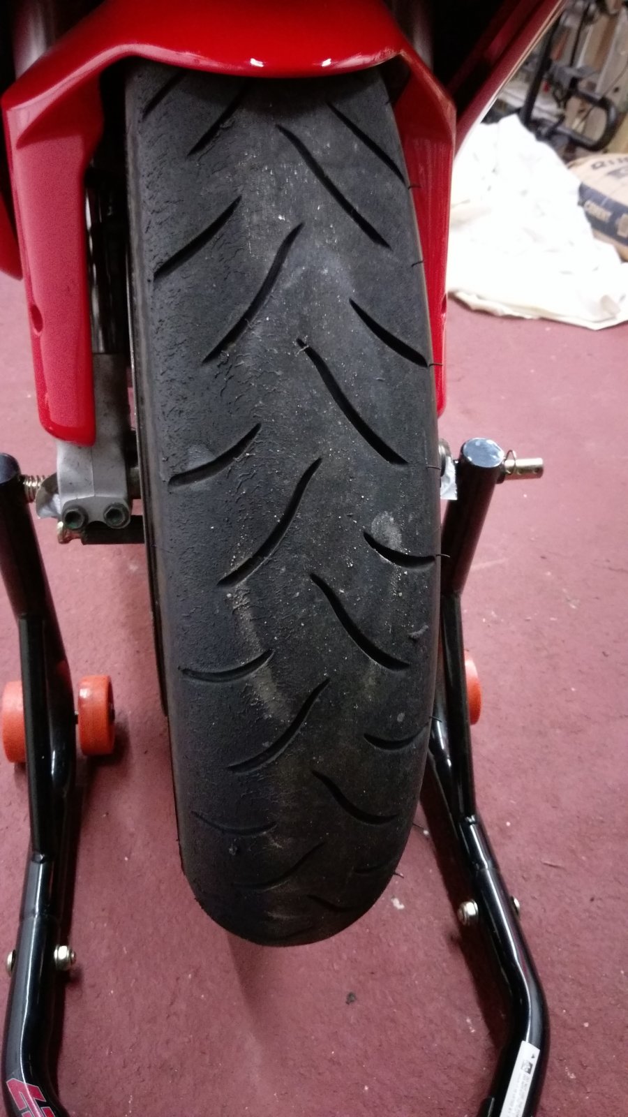

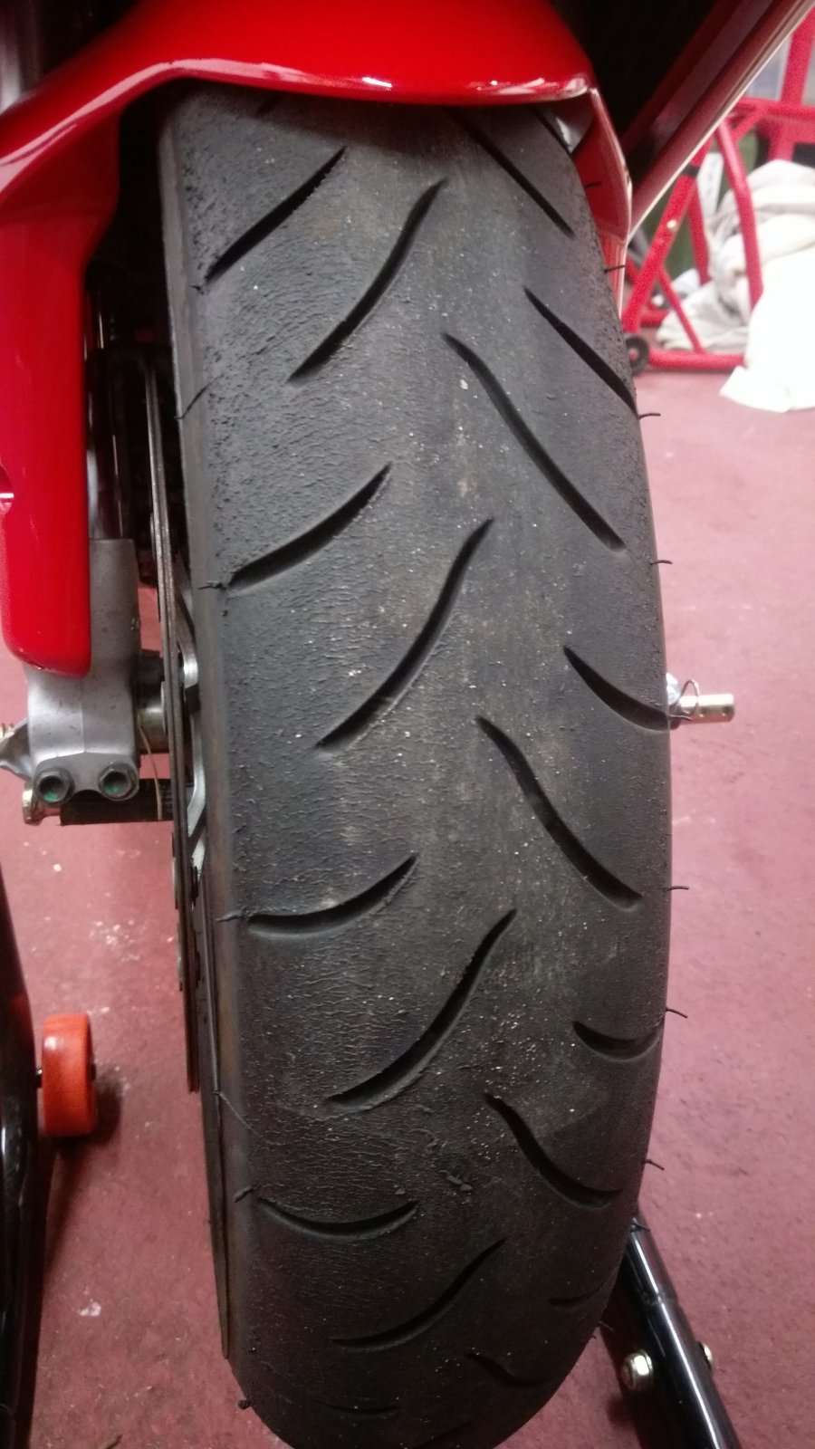

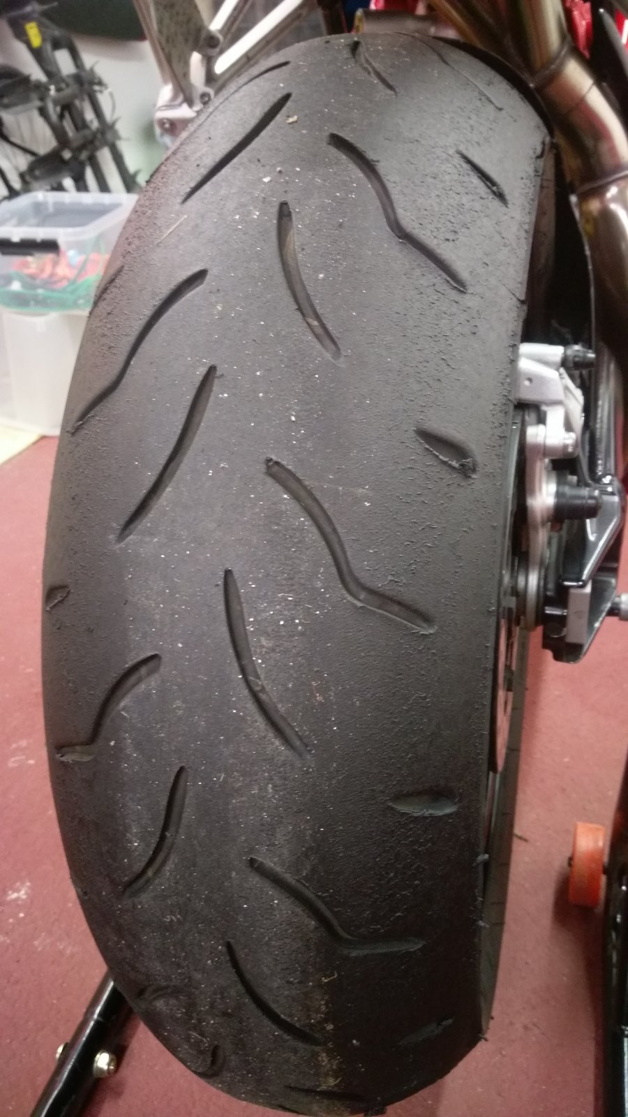

  19. Hi
    Instead of making another thread i thought i would just add to this one .
    just got home from a day at lydden hill, i ran the same pressures 30 rear 32 front hot .
    i haven't changed any setting on the bike other than updated the ecu.
    pics attached are from today , any advice is greatly appreciated as i think i need some new tyres now lol !!
  20. Your tyres look fine to me. I'd have no issues about using those on the road for a few thousand miles more.
