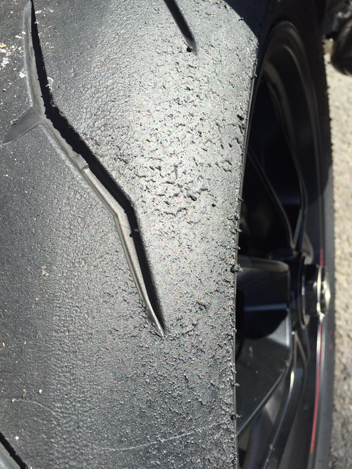

  2. Tbh I thought I had wrecked them lol .
    I just wondered why the tyre wear looked so different to when I ran at brands , seems to be Alot more rubber balling which I didn't get at brands . Maybe just the surface at lydden the track does need a proper resurface in my opinion . Round the devils elbow has probably 3 or 4 repair patches and a filled hole right where you want to be !
  3. Yesterday I found they turned in fine but I really struggled to hold the line .. mid corner going abit wide and losing grip in the front , I felt like it was starting to slide out from under me alittle .
    Had a couple of moments where it properly put me off balance at lean so had to stand the bike up abit mid corner .
    Struggled to get proper heat in the tyre all day , got them very warm yes but not hot and sticky like they were at brands last month .
  4. Ignore above its early . Your tyres are really more of a sport touring tyre with quite a shallow profile you'll find it feels so much better with a more track focused tyre & use tyre warmers a lot easier to monitor pressures . As for mid corner issues could well be suspension 999's have to much sag in the rear generally making it squat too much & run wide , as for turn in they have quite a long wheel base so bring in steering head angle really helps & finally if you intend doing more trackdays junk the rear shock there not the best & probably over 10 yrs. old + plus fork service , i have some trick parts for these if i can be of any help please call Paul on 07733174990
