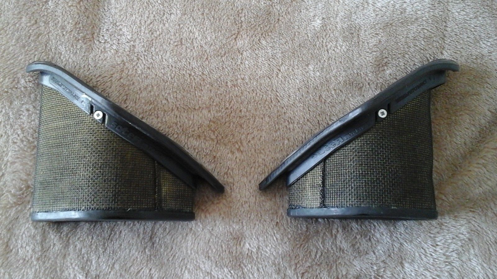

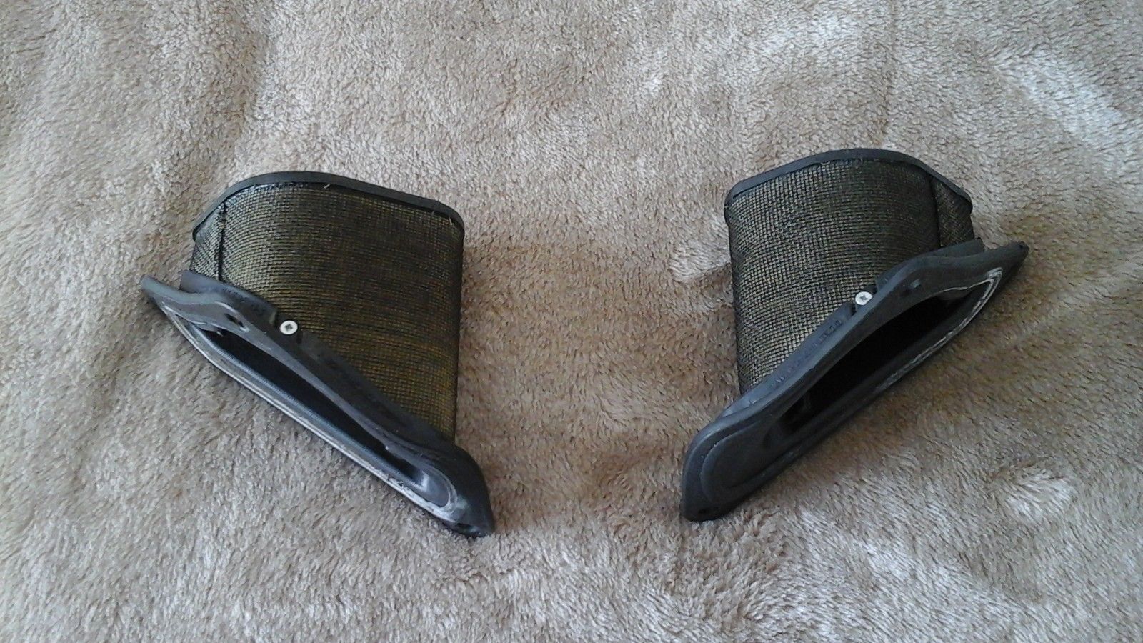

  10. DP filters are just like K&N and work the same way, its a mesh filter with an oiled cotton lining. If you use any hi flow filters it will affect the engine set up and will drive a proper ecu set up if you want to take advantage of the increased air flow capability, if not they are not worth the expense. For reference here is a pair, they probably work better than the standard ones and certainly as well as similar K&Ns, have to say when I washed these with K&N filter cleaner you could not see through them 999s.jpg
  11. D P ones ?
  12. They certainly are, if you look closely you can see "Ducati Performance" moulded onto the plastic, they came from Pro Twins in Ducati packaging and Ducati Part Numbers. The photos were taken before they were cleaned btw

  15. My DP ones match the ones in the photo posted but there's no sign of any cotton liner just straight through mesh so will have a go with the Pipercross
