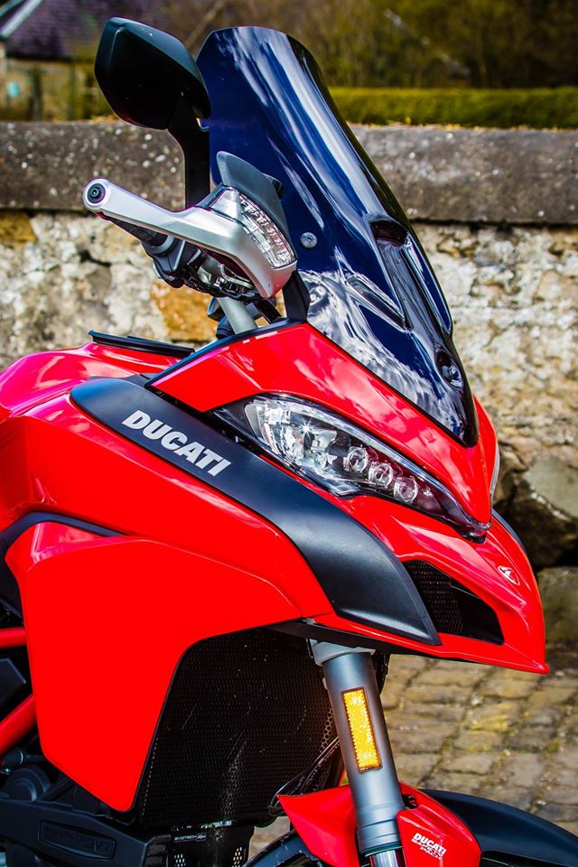

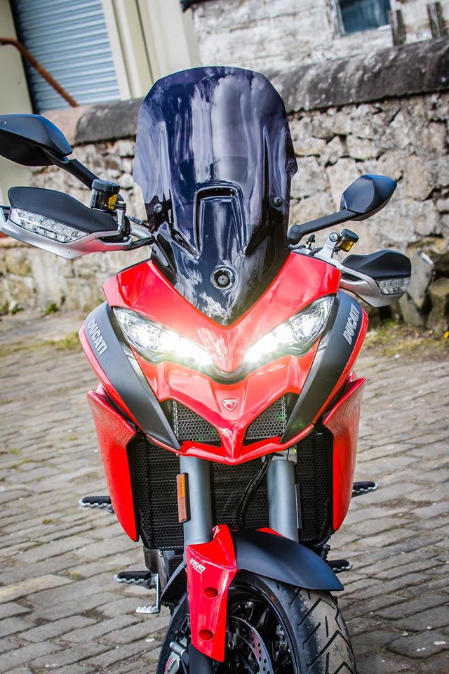

  2. OK, OK, I admit it! I'm a Scottish numpty!! went for another quick "run in" spin on Saturday and decided to look into the screen vibe issue a bit deeper. Quick check and discover that when I changed the screen over I hadn't "locked" the slide mech into the full lower position, and guess what? yip, no issue!!! will keep the "superglue" trick up my sleeve as may need in the future! here's a pic of the Puig touring screen which makes it look much better in my humble opinion!! :) Duc9.jpg Duc9.jpg Duc11.jpg
