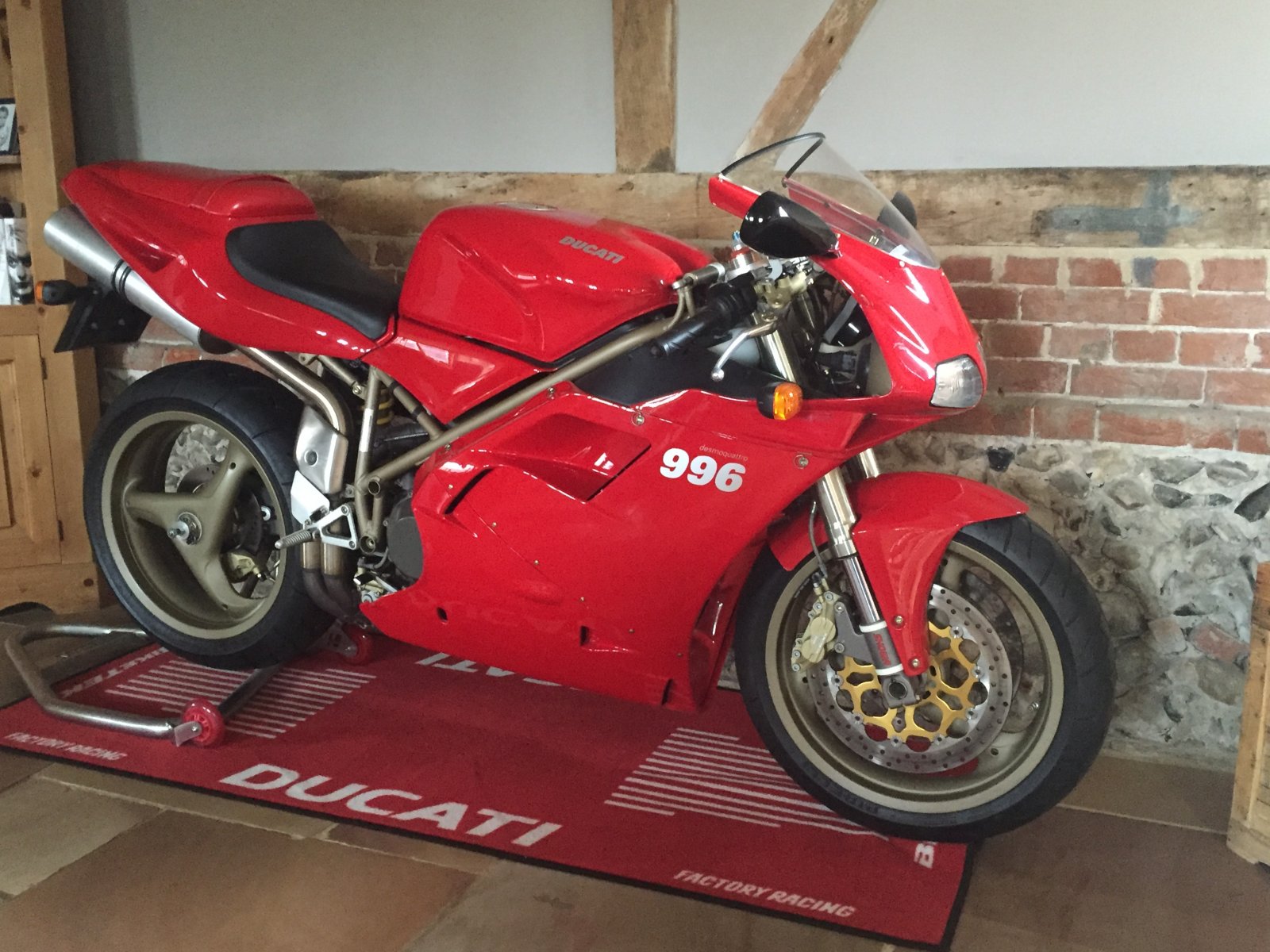

So I ended up buying the 996 with the 1098 forks, 848 wheels and carbon body. I got the chap down to £4650 from £5000, which I reckon was reasonable. He even delivered. Got the insurance sorted this morning (£190 with Carol Nash) and took it out for a quick spin. Blinkin' nora that thing is fast. I've had big sports bikes before but have spent the last 2 years riding an asthmatic old BMW K100, so this is a little different. Might take a while to get used to. The only annoying things are squashing my fingers with the clutch lever and getting it into neutral. Brilliant though.

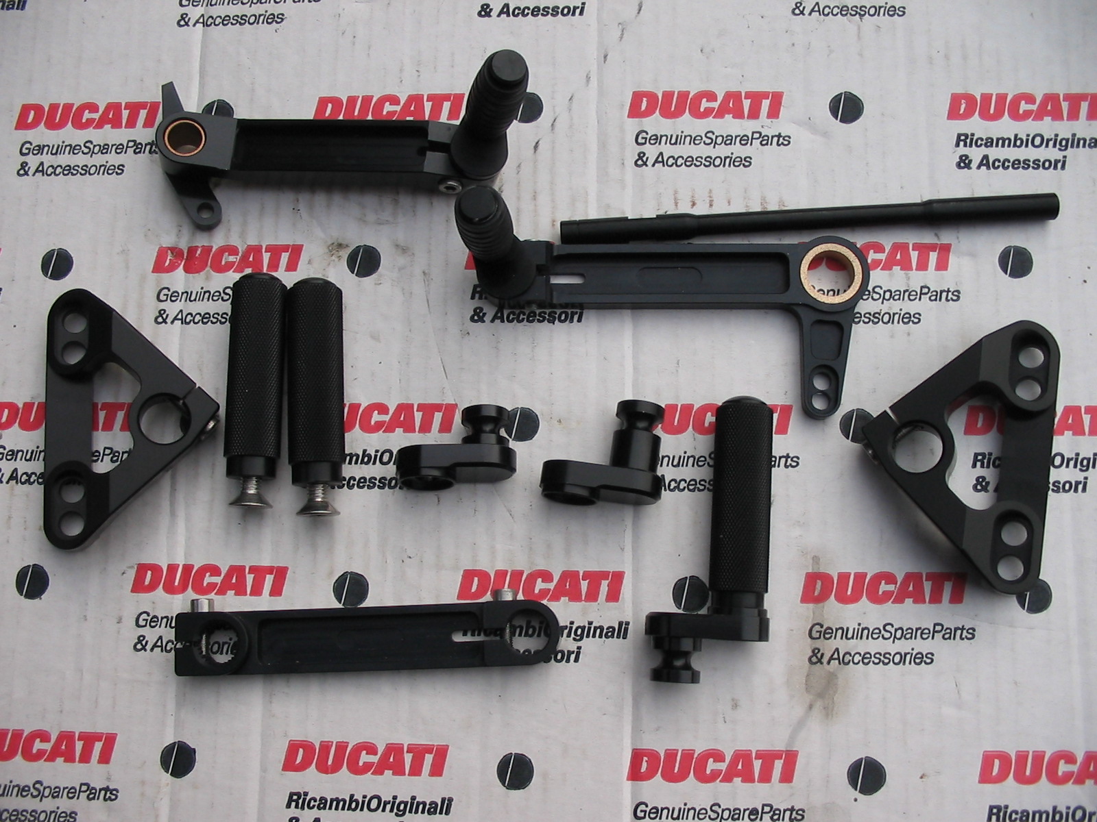

The 748-9** Models have very stubby levers and I personally don't like the flat on the gear lever. The way the gearlever hinges on the triangular plate is not the best position to seemingly provide a lot of leverage. Further the spacing between first, neutral and second is very close and if you try and find neutral when stopped you can find yourself going backwards and forwards a few times before you hit neutral. Hence the technique above, which has been mentioned on this forum before, so there should be other posts on it. Ensure you clutch is set up properly though and the stack height is correct and that all linkage is lubricated and adjusted for the best possible change. I use Migliore rearsets on my bikes and these pivot on the footpeg and tend to give a neater gear change for me. However I believe Migliore recently stopped production of these rearsets.
