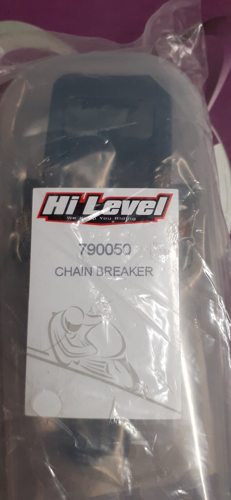

  14. Got this chain breaker riveter this week along with a 520VX3 chain from MPW. I thought I was getting the Powerite one as advertised but this Hi level turned up. Anyone come across these, or have they chucked a substitute. Not sure why its not branded Powerite. Any comments appreciated.
    I was thinking you only need a tool to peen the new rivets (old chain can be cut off) anyone used the AFAM easy rivet 5. £20 and I would have though it was decent material.
    Cheers Gaz

  17. IMO, cheap rip off of the DID KM500R which currently retails around £120/£130. Andy
