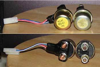

    I still can't find the reference for the correct replacement Electrex solenoid, but I found this pic.......I believe the one on the left fits a Yamaha.
    AL.
