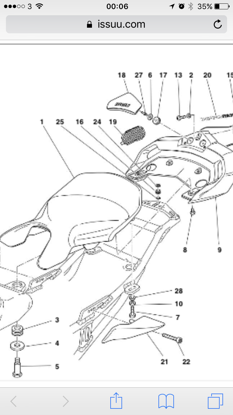

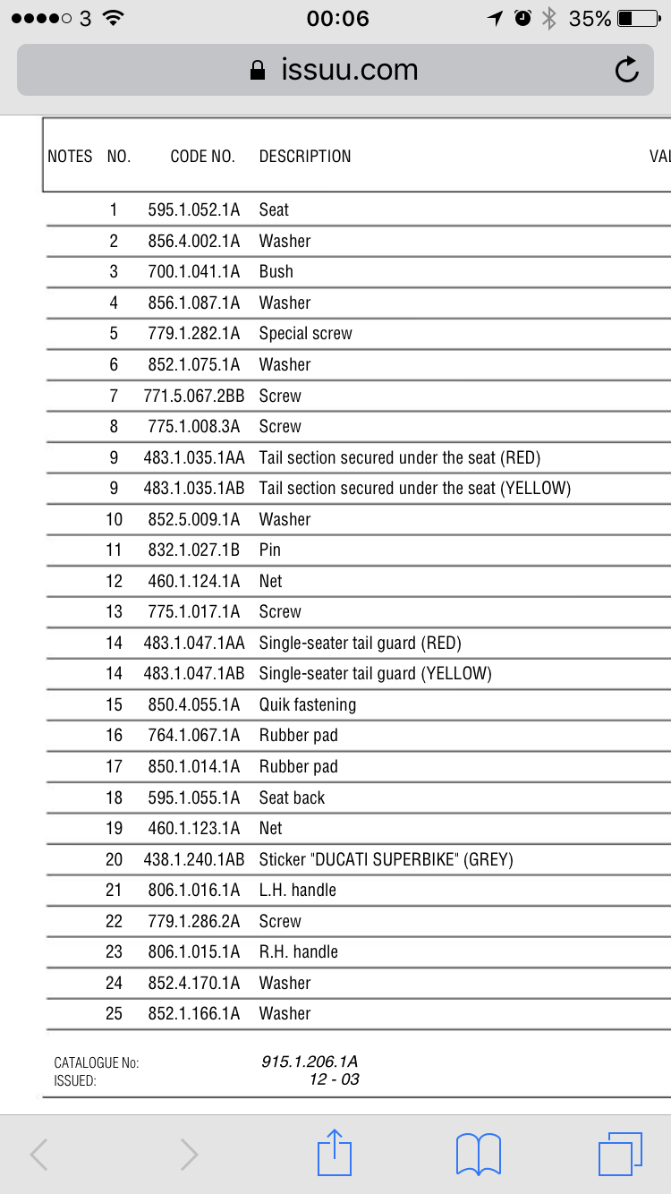

  10. Here ye go Joe; IMG_0900.PNG IMG_0901.PNG So in theory you want 24,25,16 it seems.
