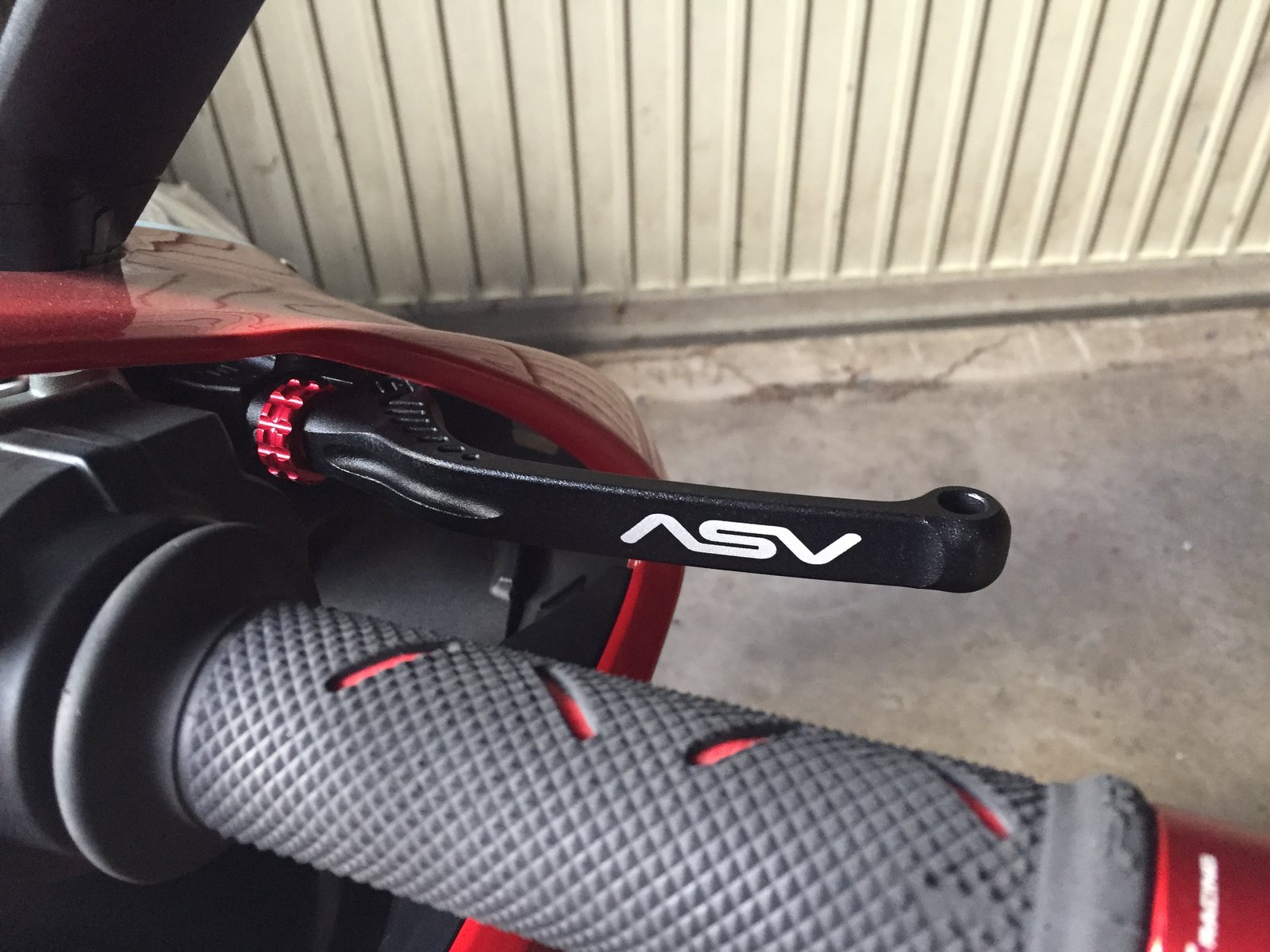

    I’ve got ASV, pazzo, and CNC racing levers on my bikes. I like the ASV ones the best, but they all do the job just fine.
