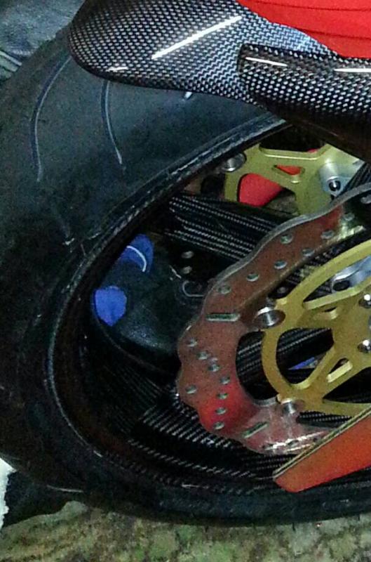

  2. [​IMG]they are brilliant.
    very well made and perfect finish
    very light and easily the best modification that can be done at any cost imho.
    I cant remember now but they are approx 18 to 20 pound lighter.
    I have it written down somewhere.
    mine is 6" rear.
    stock on my 999 is 5.5"
    I have a 190 55 fitted and the feel is sublime. stock 180 50.
    all ride height and gearing adjusted to accomodate accordingly
    this equates to faster acceleration.
    faster stopping and much faster steering at speed.
    and this isnt some 'seat of the pants' measure like 3 or 4 bhp from an exhaust.
    it is very very apparent from the 1st moment you ride with them
    infact people spend 2k on an exhaust...
    they should really go the wheels route and get real benefits

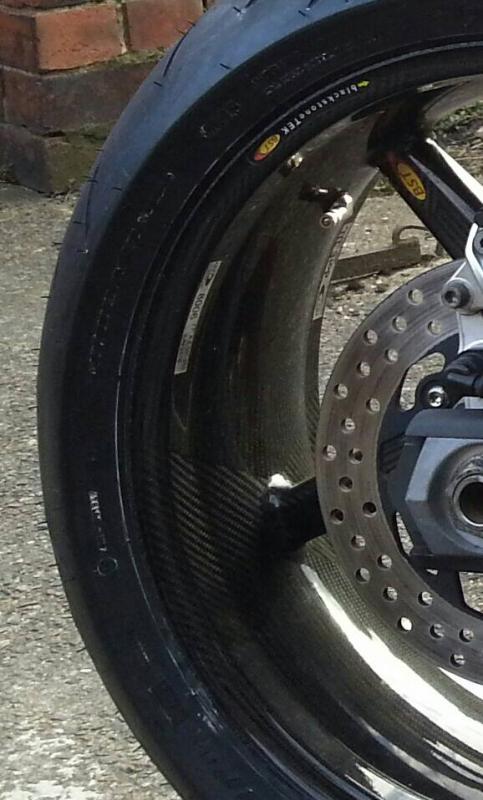

  7. I have them and they are great, however I guess as this is posted in the d16rr section you should ask Dave
    View Profile: Dave - Ducati Forum
    Think he just got some for his Desmo and runs a 200 rear afaik.
  8. What are you running your magnesium wheels on? Could you tell much difference from the originals?
  9. I went from oem 3 spokes on my 916 to these. The effect was immediate and pronounced. I felt more nimble.
